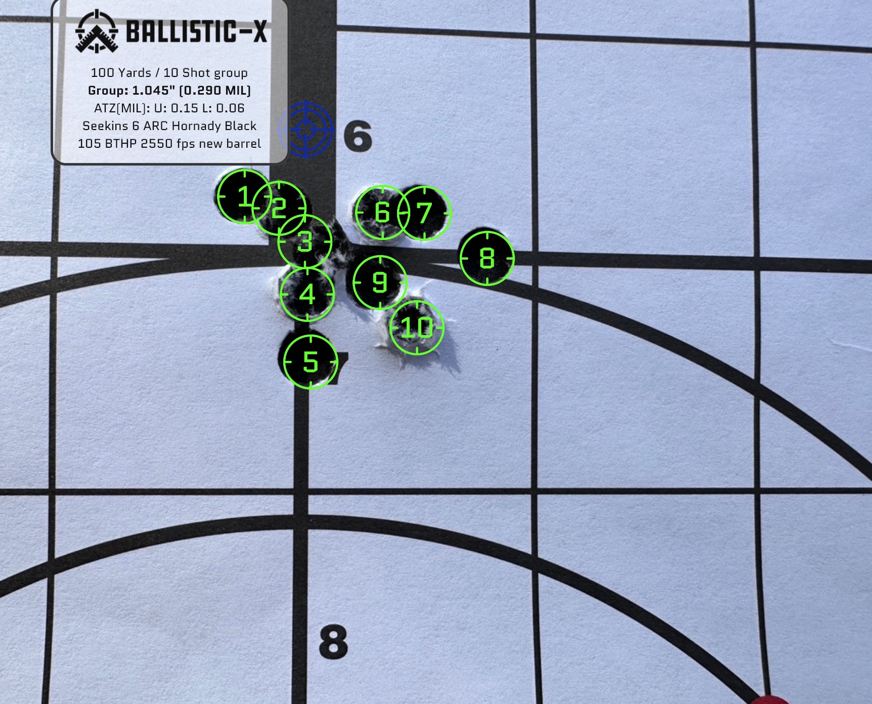

My numbers from an 18” barrel and Hornady Black 105. Magnetospeed V3.
You’ll have to see what your barrel likes but the Ranier Match should be good or buy the Proof SS in the PX if you can swing it.
Hornady Black 105 BTHP
2512, 2554, 2559, 2558, 2532,
2556, 2536, 2545, 2547, 2550 SD 13.9
Ballistic-X-Export-2023-03-21 15:57:25.810625.jpg
