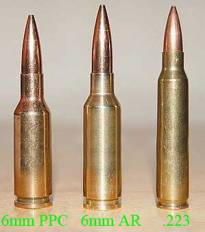

Travis224 Sergeant Supporter Full Member Minuteman Oct 7, 2010 621 364 46 Council Bluffs, Iowa Aug 11, 2020 #1 Aug 11, 2020 #1 Anyone out there have a pic to compare all 3?
Ledzep Bullet Engineer Full Member Minuteman Jun 9, 2009 4,499 6,026 Hornady Aug 13, 2020 #2 Aug 13, 2020 #2 The ARC fits right between PPC and AR. Same neck length as the AR, same shoulder angle, just .029-.030 further back on the headspace. Reactions: Alyef, CaptArab and Travis224
