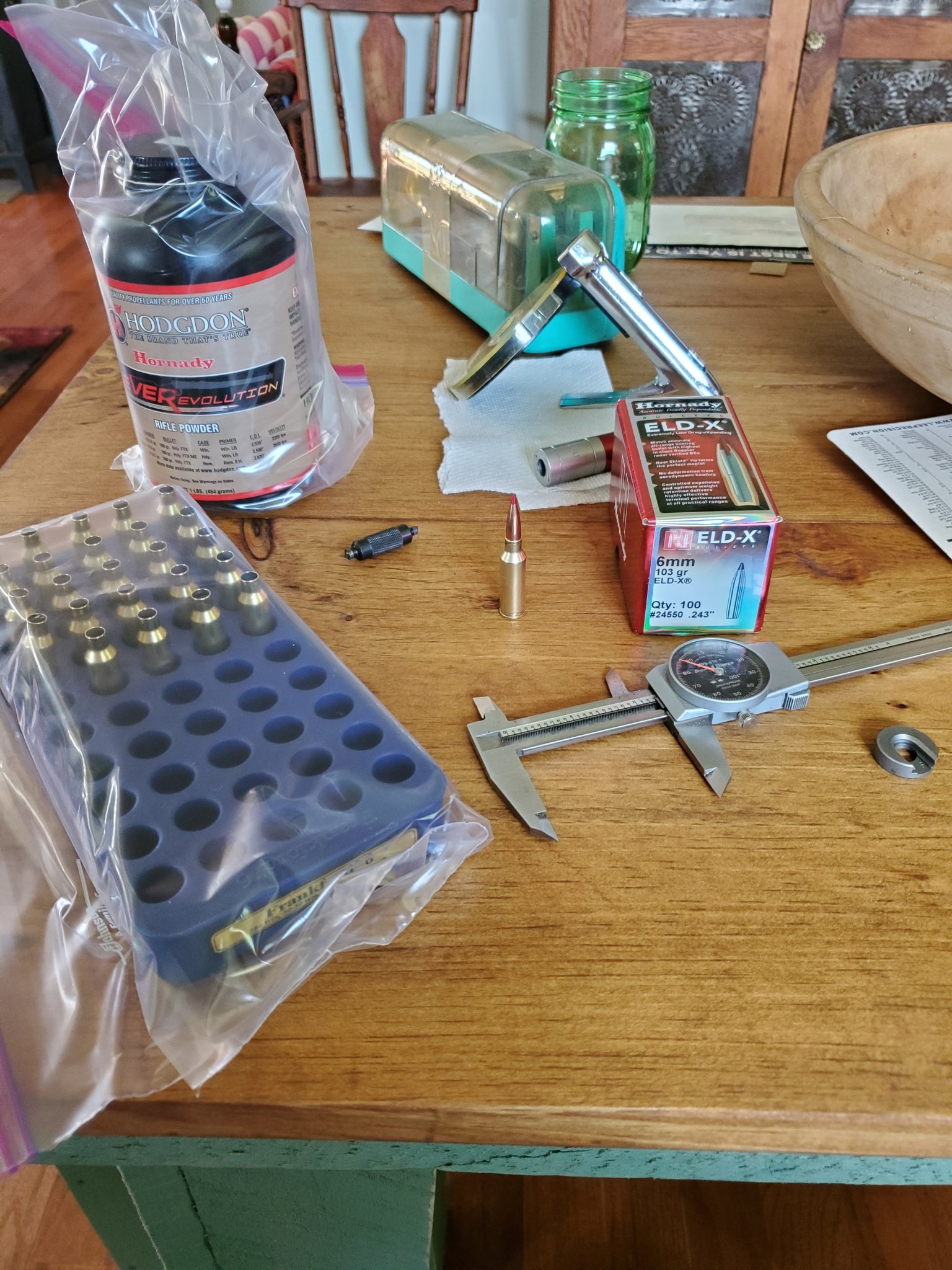

I’m not running the ARC, but it’s very similar , only difference is the shoulder angle. 29.2g of leverevolution is the most accurate so far. Behind a 95g TMK. .310 MOA @ 100. Going to fine tune it though. Stretched it to 525yds, consistent hits 12”x12” plate, right on par .5 MOA at that range. I’m wanting to try some VIT N140. 22” barrel gas gun
