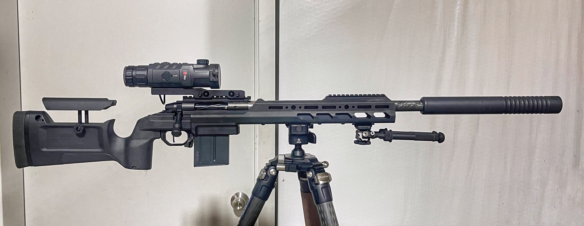

I saw the same results today with 108 Eldm and a 26” proof. Ammo fed flawlessly with the MDT 6ARC mag. Can’t wait to go out next time with these 95g Bergers!

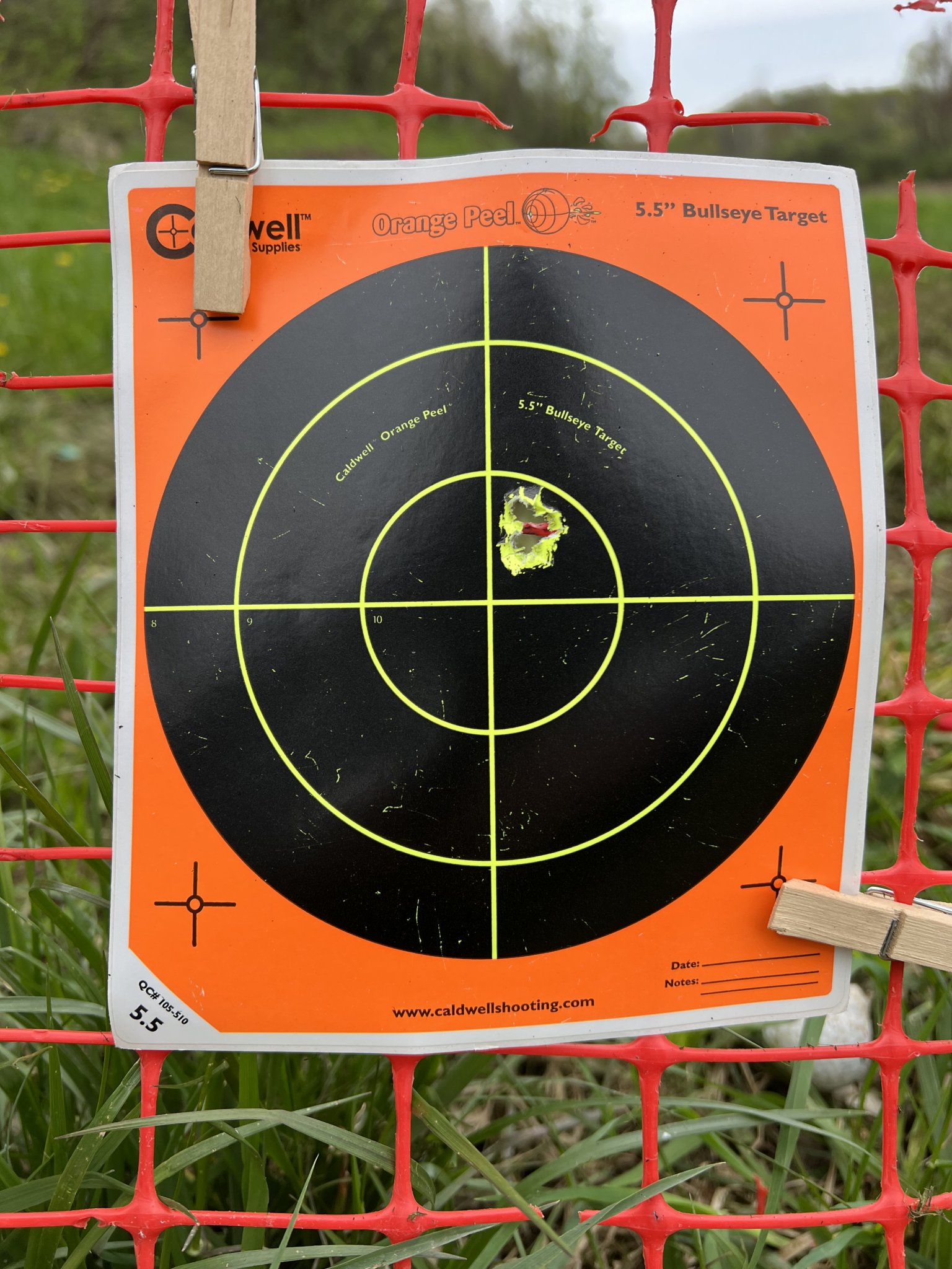

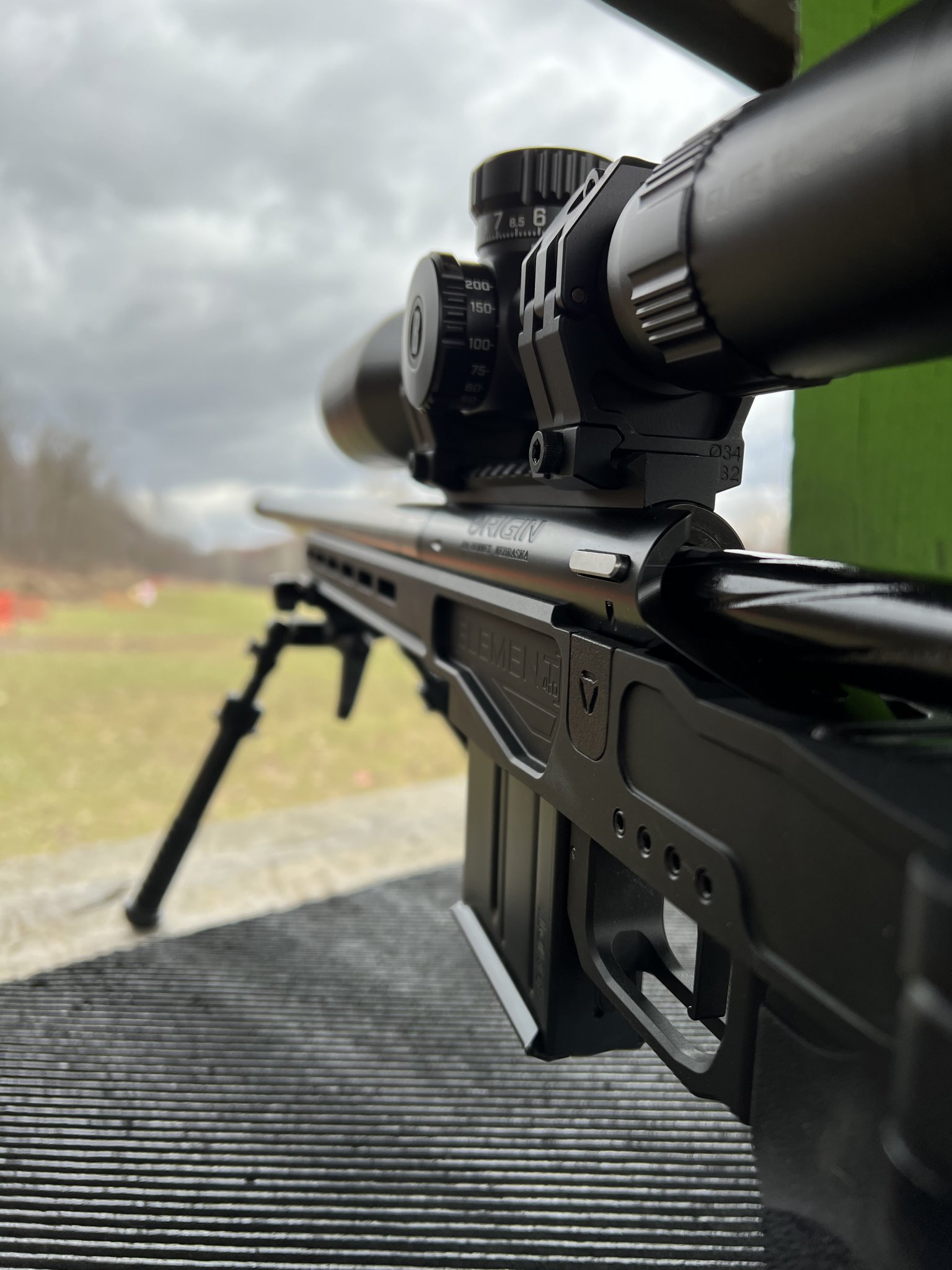

Today was finally load testing day for my 6 Arc.
Rifle:
Zermatt Origin
26” Proof competition
XLR Element 4.0
Triggertech Special 2 stage
Bushnell DMR 3
EC tuner brake
Ammo:
95g Berger target VLD
Federal 205m primer
Hornady brass
Lever evolution powder
Using Hornady’s guidance for bolt gun pressures my goal of 3000fps was easily achieved. I was incredibly happy with the results, and accuracy was phenomenal! In my opinion a bolt gun really brings this cartridge to life and makes it downright impressive! I think my load that yielded 2950fps will be my go to as it was easier on the brass and had the lowest SD/ES. Strelok shows this load only drops 9.11 mils at 1000yds, that matches my factory 140eldm load in my 6.5 creed!
