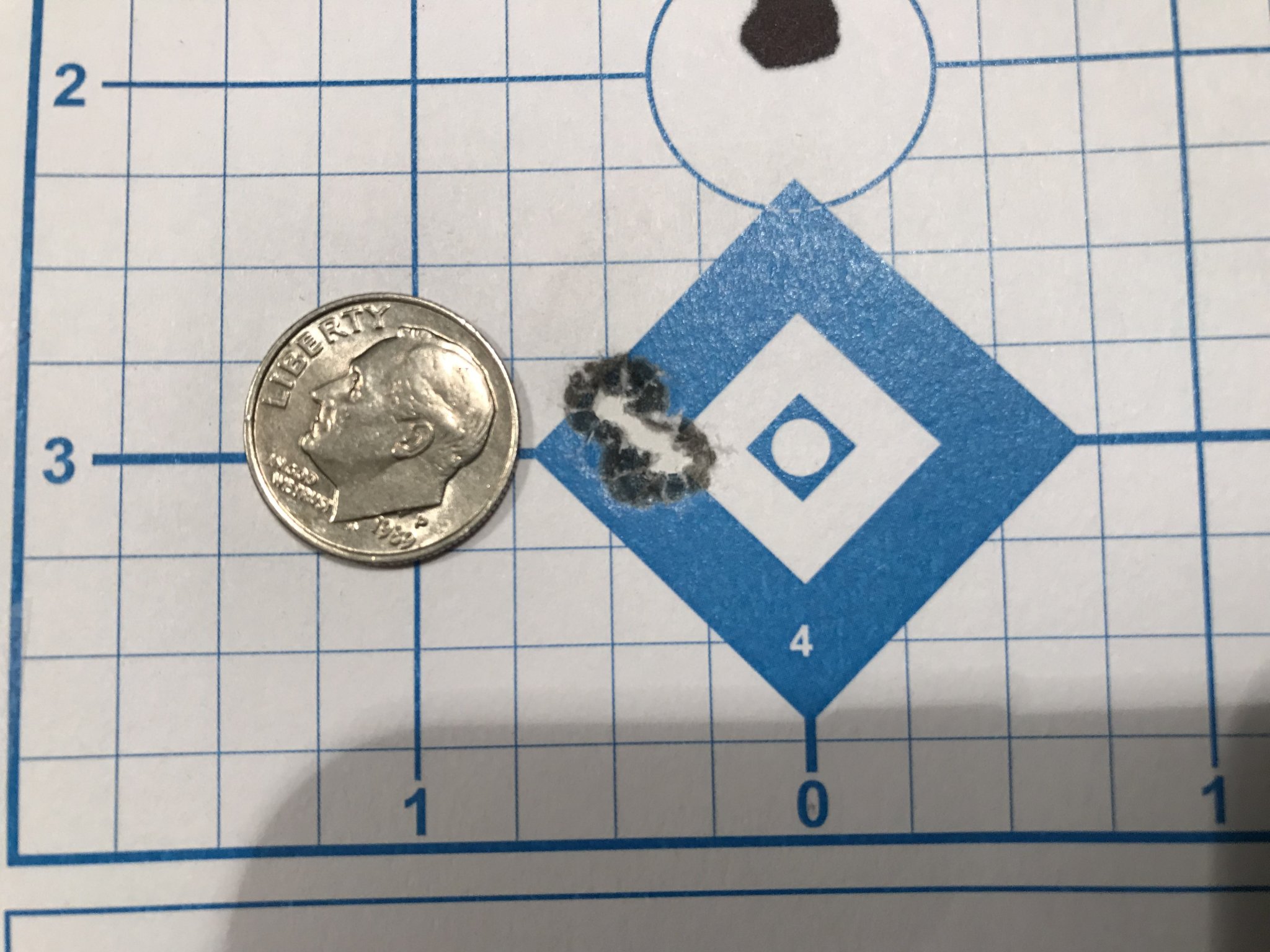

I have a co-ax and use Forster's microseater and their custom FL non bushing sizer with .267 neck
Shot this group yesterday. 4 shots@ 100 yds.
man good thing you put that dime in there. i forgot how big bullet holes were. and nevermind the 1" grid you shot at lol.
