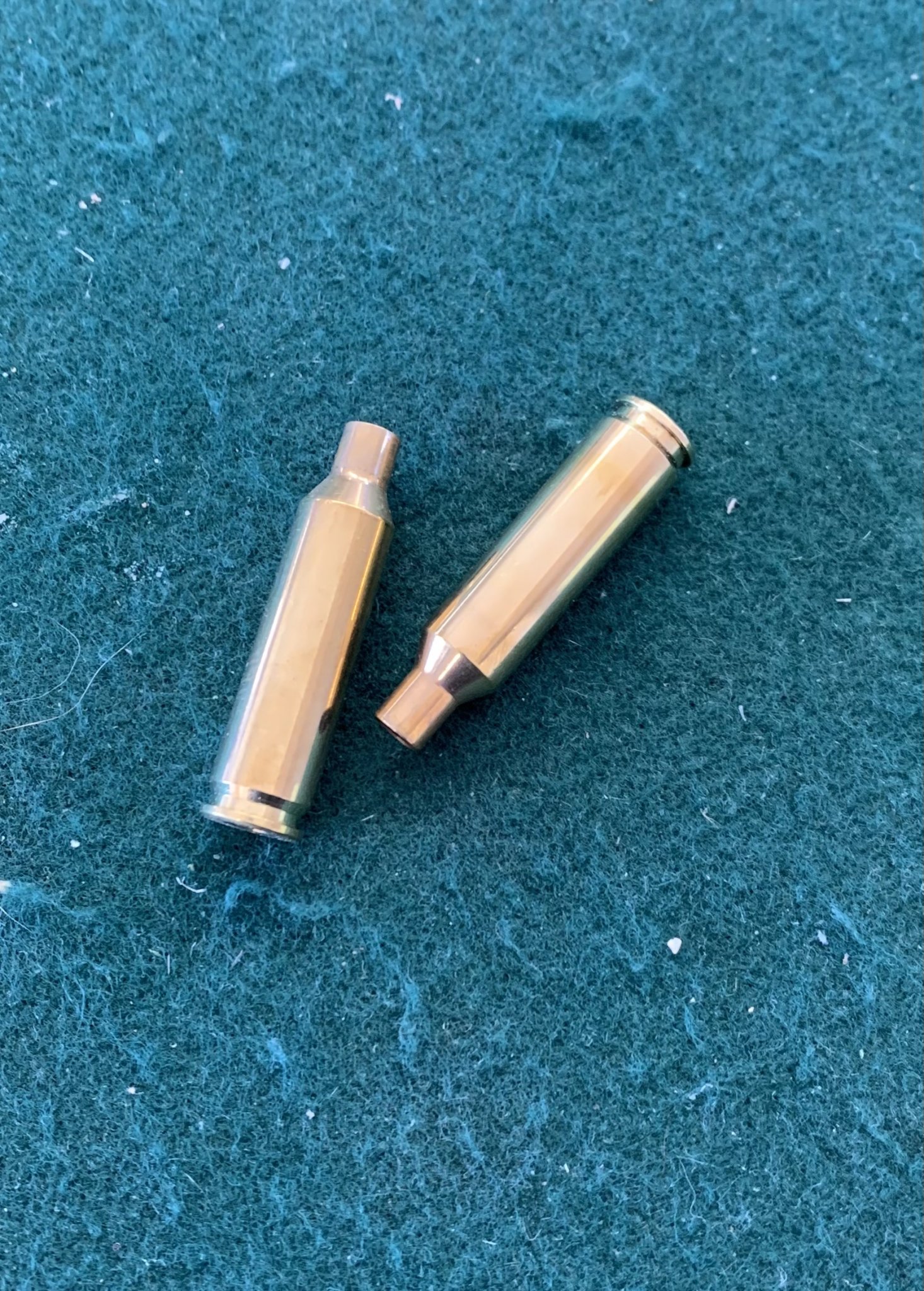

    Try to pick the 6XC from the 6 Creedmoor
    6XC on the left.

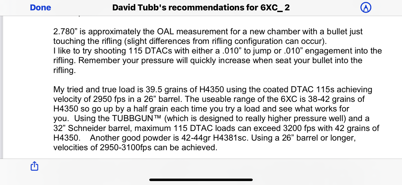

    The XC is .040 shorter at the shoulder, which aint much. Here’s a snippet from Tubb’s own tips on his cartridge below. 38-42 gr if H4350 with a 115 DTAC. That is a dead-on overlay with 6mm Creedmoor data using the same bullet. My personal 6CM uses 39 gr of H4350 to make 2950 in the same length barrel as an example, which lines up with other 6cm’s ive cut barrels for. I have an XC too, which uses 38.5 gr for the exact same velocity. There is no valid claim that one is more efficient than the other, they're too close together. One person’s brass choice and proclivity for loading hot or not makes more difference the either of these cases would.

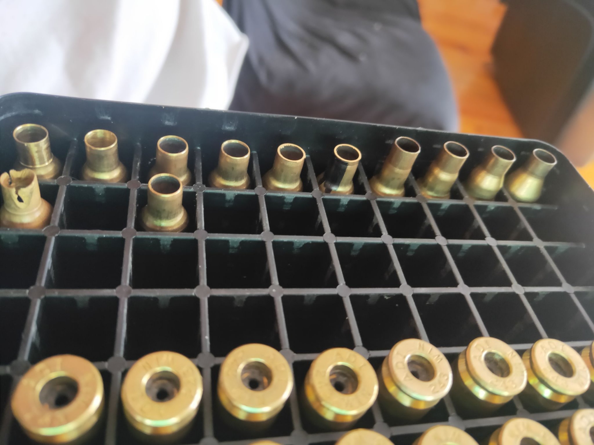

    Not as much as I do. 11 processes to form it, then fire.
    From back right:
    Normal 243win
    First neck size
    Second neck size
    Third neck size
    Cut off excess neck (harbour freight tiny saw)
    Full length trim (LE Wilson trimmer)
    Case mouth chamfer
    Inside flash hole deburr (there's 2, because one case has a cut out window to show it and how it was done)
    ID neck ream to remove donut (LE Wilson)
    OD neck turn (21st century)
    AMP anneal (the blown case neck was the sample)
    Once I had a process, I wet tumbled all brass and did it. I did have to run all brass thru a FL sizing die with appropriate bushing after all this to load. Working well so far.
    From back right:
    Normal 243win
    First neck size
    Second neck size
    Third neck size
    Case mouth chamfer
    Get a 6cm.View attachment 7556755
    If someone wanted to pay me to do that to my own brass, I wouldn't do it.

    Good call. That article seems to be either misleading or just plain wrong. I found this on Tubb's 6XC pdf. (down toward the end just before the reamer print)
    "Please keep in mind that if you are using brass other than Peterson or Norma with the TUBB® 6XC dies that it may not work properly. The TUBB® 6XC dies were designed for use with the CIP6XC, not the 6XC II. Peterson and Norma 6XC brass are designed to work in CIP6XC chambersand therefore canbe used with TUBB® 6XC dies.Unfortunately, Alpha Munitions and I were unable to come to an agreement therefore I was not involved in their 6mm brass development.If you fire a case in a 6XCII chamber and then resize using my TUBB A7 tool steel resize die you will likely be shaving brass off of the last ½” of the base of the case.Please see below for Manson Reamer print I recommend."
