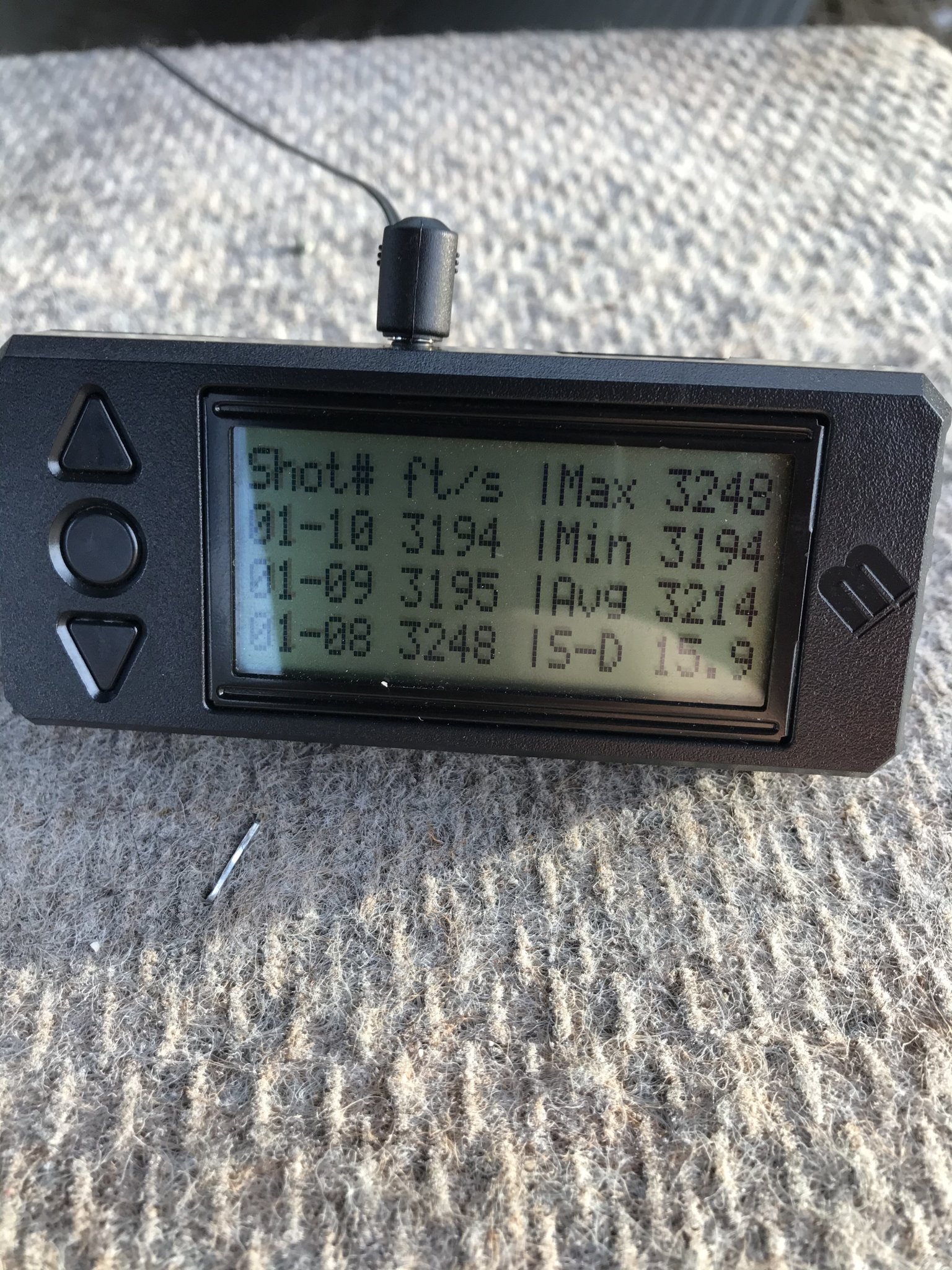

I just built a 18.5" 6creedmoor to test velocity and other things. If I can find some 6creed factory ammo around here I'll see what it chronos for you as well as what velocity I was getting in handloads.
I can tell you out of a 22" I was able to push a 107smk at 3085 just fine.
Wont get to the range until the 13th though so youll have to sit tight for a week or so.

Little late posting the results BUT.
18.5" barrel
105 w/ 42.7gr H4350 @2975 (no pressure could go higher)
110 w/ 40.8gr H4350 @2853 (just starting to see primer edges get sharper, approaching max)
105 w/ 37.2gr AR-Comp @2999 (primer flat)
110 w/ 36.7gr AR-Comp @2914 (no pressure could go higher)
105 w/ 44.9gr H4831SC @2830 (no pressure could go higher)
110 w/ 44.9gr H4831SC @2831 (no pressure could go higher)
Didnt test for accuracy, this was just trying to find my max velocity per powder. H4350 out of these 3 is still probably the best choice but is boarder line less case fill than id prefer. the H4831sc gives great case fill but without QL i'm concerned not enough is being burnt before it exits the muzzle (I run suppressed 100% of the time and it would foul up real quick). AR-Comp gave great velocity for the charge but not nearly enough case fill, I'd suspect the sd/es to be high but have not tested anything further yet.
Given these results I'd probably end up with H4350, if I wasnt to run much suppressed id probably go H4831sc. Only tested AR-Comp because I have 24#s of it with nothing to use it on.
