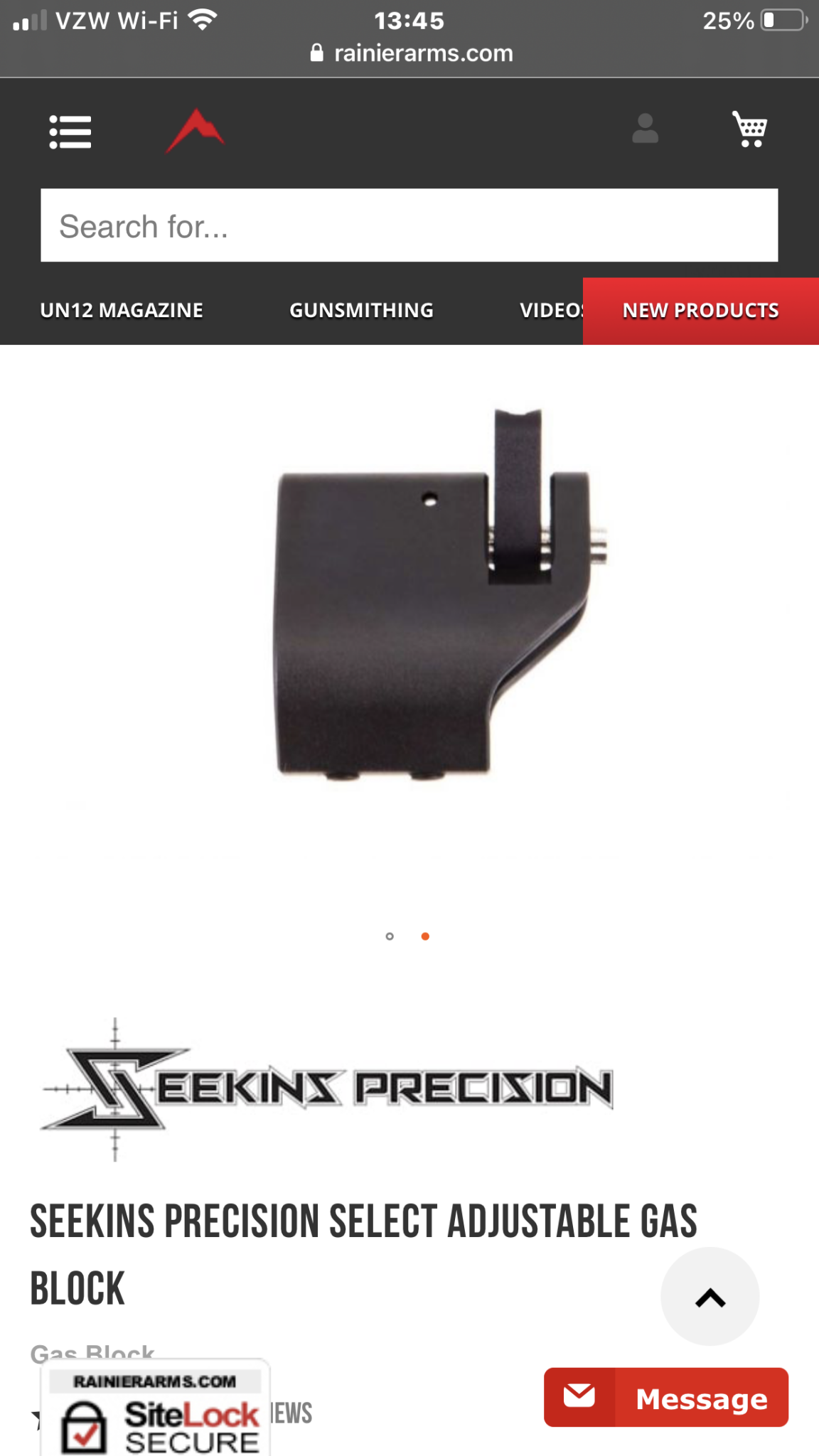

I have a gap 10 24”. It shoots 105-108 very very well.
I put a switch block gas block on it for suppresses/unsuppressed use. Watching bullets hit fur or steel out to 800 has been no problem
Who makes this switchblock? That the noveske model? What twist and how much powder?
Thank you
Seekins. It is a 1-7.5 I believe.
The lever is right in front of the rail so it’s perfect. I added about 2 clicks above bolt lock open. And it shoots soft and dreamy.
