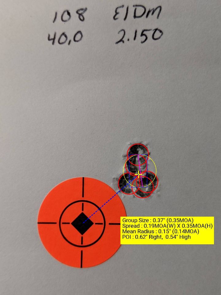

Here is 2 sets of 5 shot groups, .020 and .030 off lands using Whidden shoulder comparitor. Top hole on left group is cold/clean bore first shot.
Left has SD of 2 & ES of 4. With a 16 power scope & my old eyes I think It's time for a scope upgrade.
