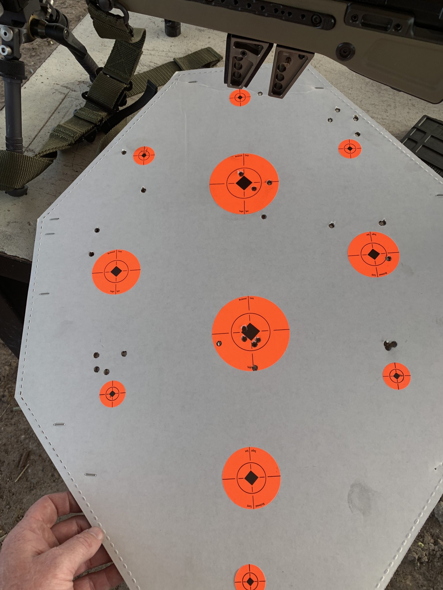

I had similar issue at around 1k with 6 creed. Even went as far as having it set back and chambered again. Here is a 100 yd target after I starting having the pressure problems and velocity increase (after the cleaning and set back work).
