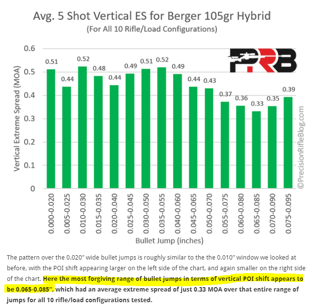

Read this article, the large jump might not be a bad thing.

Check out the article. if you have a large jump, it might not be bad.
That’s very interesting, I’ll read it in full when I have a bit more time but at a glance maybe i should have stuck with the 105h. The charts were very interesting.
Thanks for posting this. I was just discussing jump with a good friend (gunsmith) and his experience mirrored the concept of greater jumps as described in the article. I'll be testing this theory in the next couple days.
Yes, its very interesting. I think this is a good data set to use considering there are so many rifles and chambers involved. But this is exactly something I have been looking for. I didn't always want to chase the lands. I wanted a chamber cut that was very forgiving over the life of the barrel.

If you look at the graph, it even shows less vertical spread for the 105s with a jump of .065-.085 than with 0.000-0.020. If you like to waste your time chasing lands, be my guest. It sounds like you are new to rifle shooting and have trouble understanding some fundamentals.
