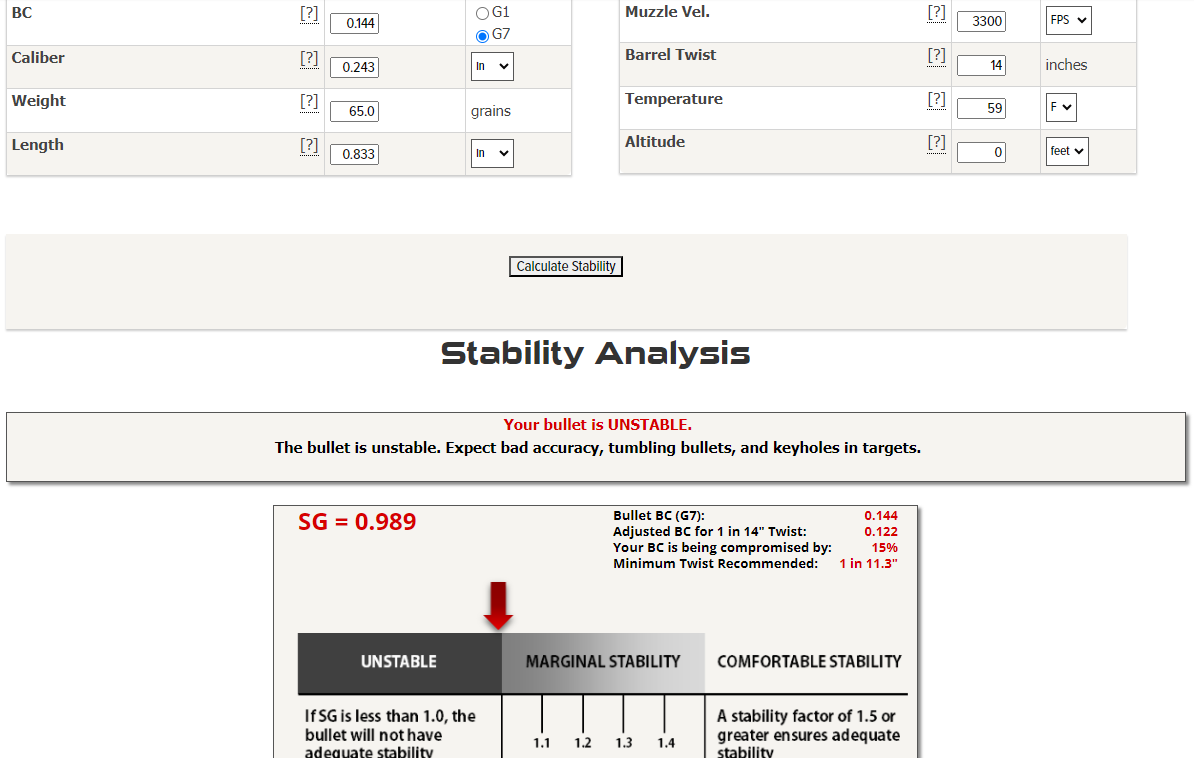

I ended up getting a new barrel from a local gun smith on a trade it's a 27in brux 6mm with a 1-14 twist.
Has anyone built a Creedmoor on this slow of a twist barrel for like 65grain bullets?
14?! No way you're stabilizing that bullet.
Even at 3300 fps you're not even marginally stable.

The 14t will handle bullets up to 75gr without issue, regardless what the stability factor calculators say.
