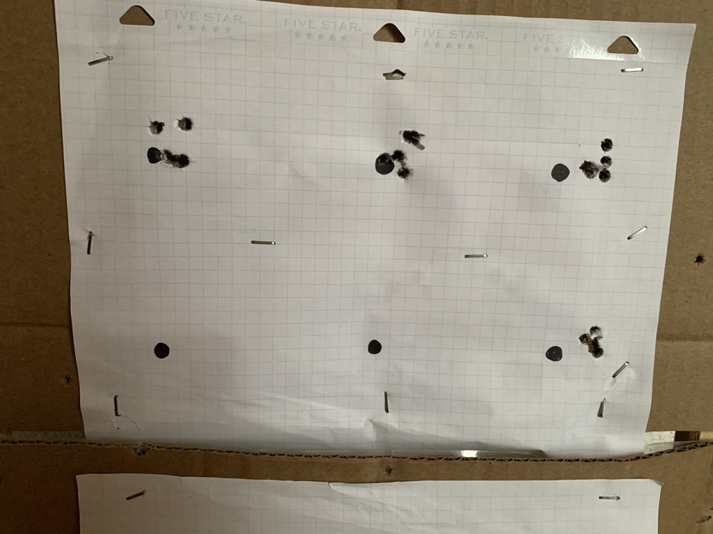

Just order some 90gr Lapua Scenar-L due to the lack of Berger 105 Hybrids for my 6mm dasher. Is anyone out there having success running them in the low 3100fps range?
I will post what I come up with but I am curious of what others have found.

This is my findings so far. I jam the lands and backed off .020
CBTO 1.840
First series I deleted 1 shot that was way out of line with the rest. It was a cold bore and the bullet I used to find the lands so Idk.
I did 5 rounds mainly to get a good MV. Groups suffered from it. Group sizes were measured from outside to outside of at the furthest point then subtracted bullet diameter .243.
Shots all felt clean. I think I am going to try seating depth on the 33.3 load to see if I can maintain the velocity ES but tighten the groups. Also curious to see what the MV will do adjusting the Seating depth.
