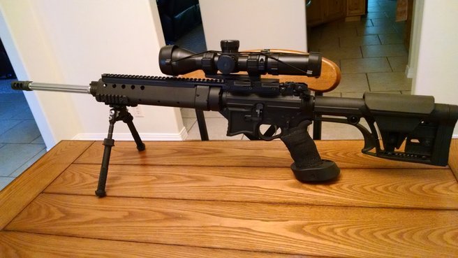

My 6mn FR was built by Lee with a 22" Bartlein Barrel 1-8 twist, 5R, Medium Varmint Contour. As a complete MK12 MOD 0 Upper.
