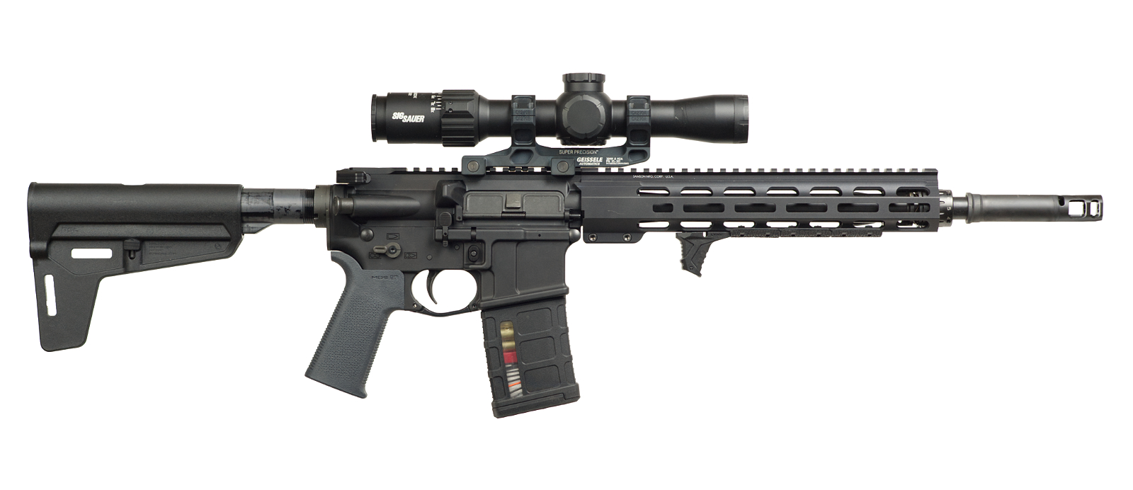

Brownells finally got some SOLGW 14.5" 6mm Max barrels in, so I picked one up with one of their coupon codes.
I paired the barrel with a Riflespeed adjustable gas block, which IMHO are simply the best for tuning unsuppressed/suppressed shooting on the fly.
I initially shot a few dozen rounds of the factory 90gr ELD-X using .350 Legend 20rd mags. Function was flawless and the barrel stacked rounds in basically one ragged hole. Recoil was minimal, and the POI shift with my legacy Surefire can was only a quarter mil straight down - probably due to the barrel being very stout. I didn't chrono the loads, but they should ballpark around 2600fps.
I've handloaded the once fired brass with 100gr Speer BTSP and definitely will chrono these.
On a whim, I decided to see if 6Max rounds would work with my Six8 receiver set and Magpul PMAGs... Yes, yes they do.
Rounds stack a bit wonky, but they fit and feed just fine. The rounds slide out of the polymer mags like butter. The Six8 PMAGs have *just* enough inside length to allow the spec'd 2.3" COAL.
Pretty dang cool. The Six8 20 rounders fit 22 6Max rounds and the 30 rounders fit 33 or so. Love it.

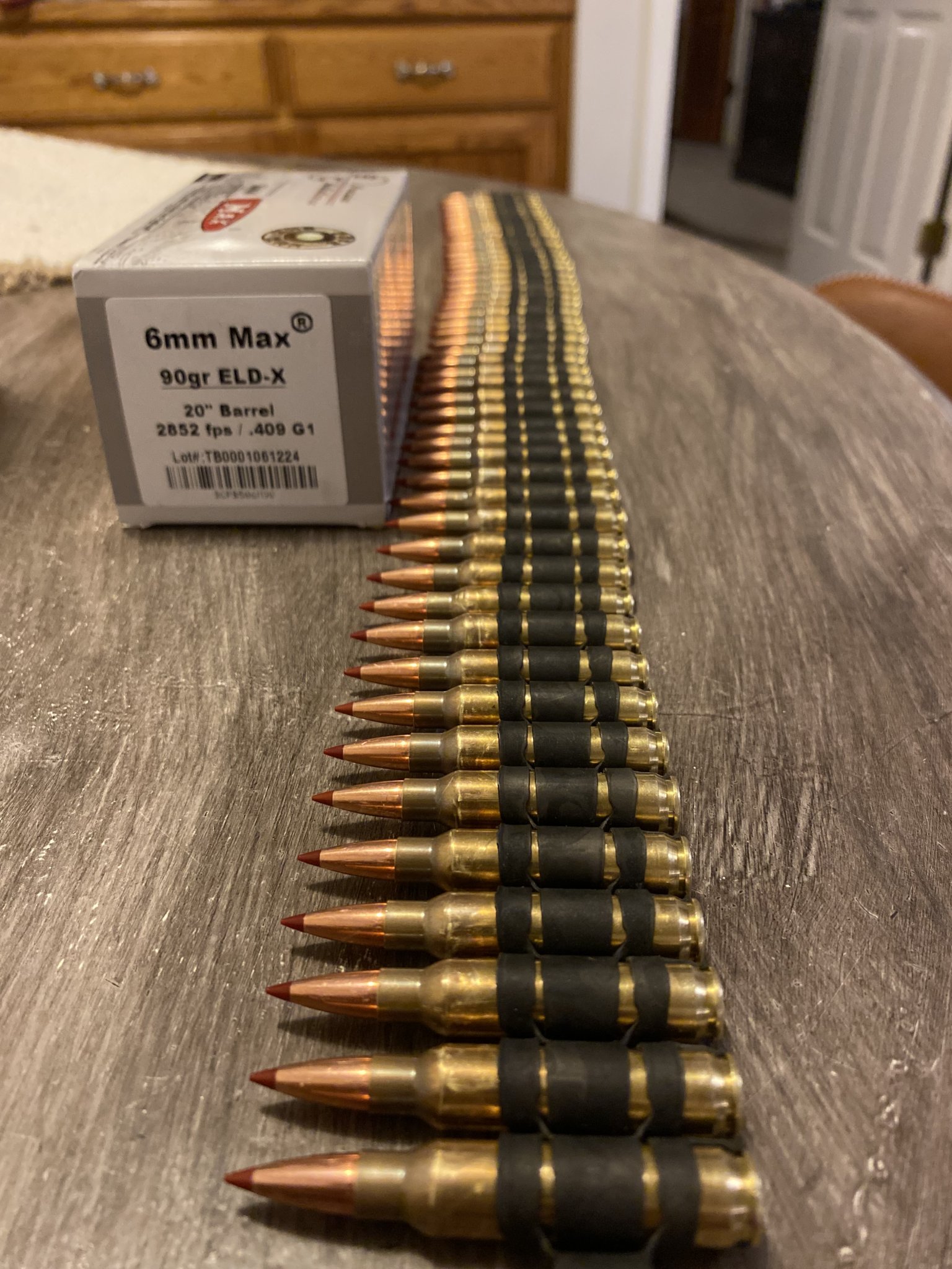

@vmpglenn mind checking something for me since you have 6Max brass on hand? how do they fit in M27 links?
I had the wild hair of an idea to rebarrel one of the Fightlite MCR uppers into a 6 Max, it should work since the case head is the same, but the body taper was the question
