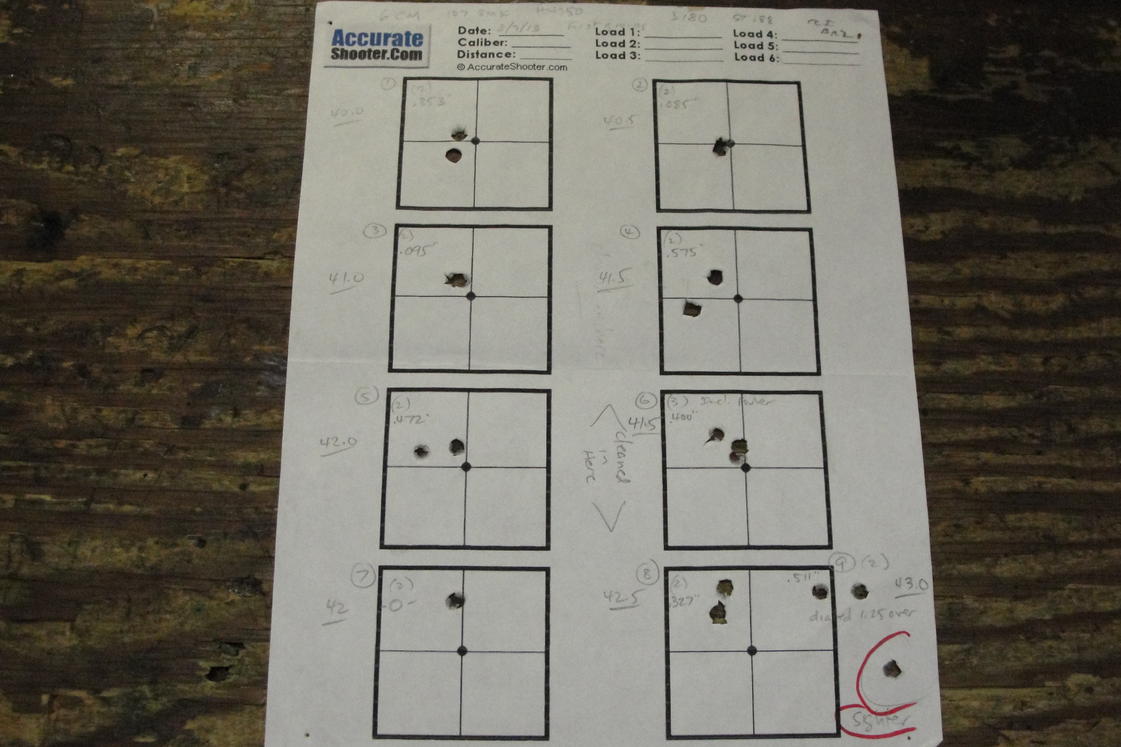

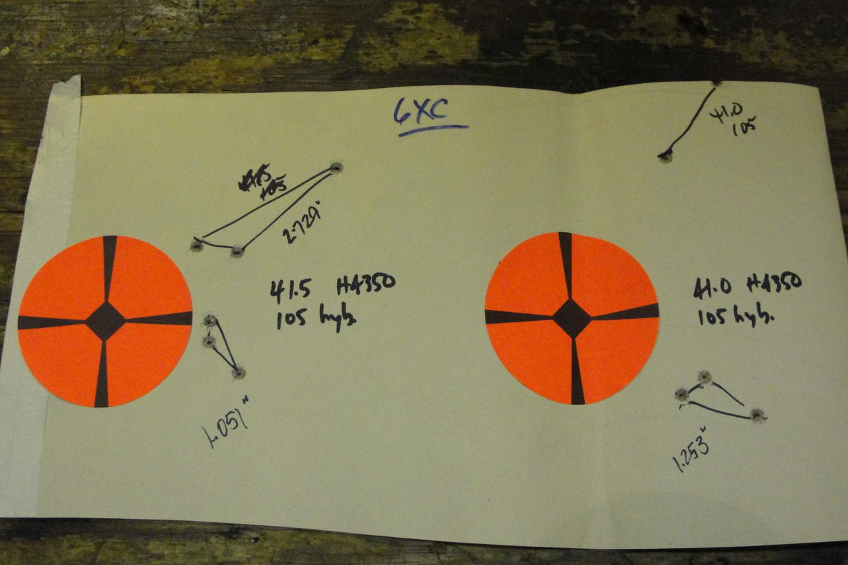

6MM XC
The 6XC was the first up, I have heard many shooters have had high success with this cartridge, so I thought it would be a good place to start. My XC reamer has .273 neck and .130 freebore, the reamer cut great and there was no problems with the barrel install. I bought 500 pieces of brass from Tubb, cost was $.88 without shipping, loaded rounds were .270" at the neck. I waited several months for this brass to come in, I believe this is a single source supplier. The primer pockets needed significant cutting with a squaring tool, the flash holes required no work. I used Berger 105 Hybrid and Sierra 107 match king, and H4350 powder only
Regarding bullet seating depths, both bullets were jumped approx. .020", the overall length of the cartridges loaded with 105s and 107s fit with ease in an standard AICS magazine. I do not do the shoot/clean/shoot/clean break in, I usually just get shooting and clean when I switch bullets or powders. The first targets are on the small boxes all shot at 100 yards, the targets with the orange dots were shot at 570 yards at Manatee Gun Club in Bradenton, FL. Manatee is a difficult range as the winds are switchy and the mirage here in south Florida in the summer/fall is heavy and troublesome. The two small groups fired from the XC were both shot (consecutively) over a 3 minute period where the entire range was covered with clouds and the wind stopped. This shows how much the conditions can make a good gun into an average gun or vice versa. Many other targets shot with the XC were in the 2-3" range.
The XC was a breeze to load for, I think you could go to a match with just about any load tested here and be competitive. The functional performance zone of the XC seemed to be 2950-3030, there are lower nodes but why bother? I'll go with accuracy and performance if I can. I was able to get up over 3100fps but the accuracy was starting to fall off and I was starting to get ejector prints. There was a total of about 120 rounds fired during this test, the primer pockets are nice and tight throughout the test.

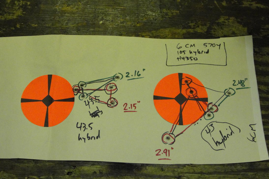

6MM Creedmoor
I did the 6CM along with the XC, load testing was done at a similar time of year in similar conditions. My 6CM reamer has .275 neck and .123 Freebore. As I understand it, others may be using a freebore of closer to .200", I spec'd the freebore to be used with 105s, the bullet seating layout looks good in a loaded case when the bullet is loaded at the lands. The brass was Hornady brass headstamped 6mm Creedmoor, bought from GA precision for $.65 each without shipping, loaded rounds measured .272" across the neck. I used Redding type S bushing full length 6.5mm Creedmoor sizing die with a 6mm bushing, and a whidden competition 6mm Creedmoor seater die ordered directly from Whidden.
I was impressed with the Hornady brass, I ran it through the sizing die and there was no sizing performed. Necks were round, primer pockets required little/no cutting, but all the flash holes were cleaned as there was a visual burr in many cases. I believe GA is the primary/sole source of this brass, others may sell it but it all originates from GA Precision, I believe. The brass was available when I called, apparently GA buys LARGE lots of this brass and it is available most of the time.
Seating depths were .020" off again, these cartridges would fit nicely into an AICS mag without magazine modification. They ran properly from both AICS and AIAW mags. The 6CM was easy to load for, the nodes were a little more pronounced than the XC. Its apparent that you can get about 2 more grains of powder in this case yielding 80-150 fps of velocity benefit over the XC. The functional velocity range of the cartridge was 3000-3150, better performance that's closer to speed limits set on many matches. There were, of course, lower nodes
small box targets were shot at 100 yards, large orange circles were shot at 570 yards at Manatee Gun Club the same day as the XC from above. There was approximately 135 rounds fired in this test, the primer pockets are noticeably loose after 3 firings
Load density with H4350 was less than 100% even with a 44 grain charge (my max). If a longer freebore was used I would be interested in exploring magnum powders and possibly a 115 grain bullet. The case has the power to pull it off and would have extra case capacity for a slower burning powder if the bullet was seated further out. In general, these groups were a little larger on average than the XC, but there is a noticeable speed benefit. I did not get the opportunity to shoot in ideal mirage conditions with the CM, but if it will produce 2-2.5" groups on the 570 yard line, it meets my accuracy standard (especially with me shooting...). FYI the smallest group the CM produced was .866" at 570yds, but I could not duplicate this

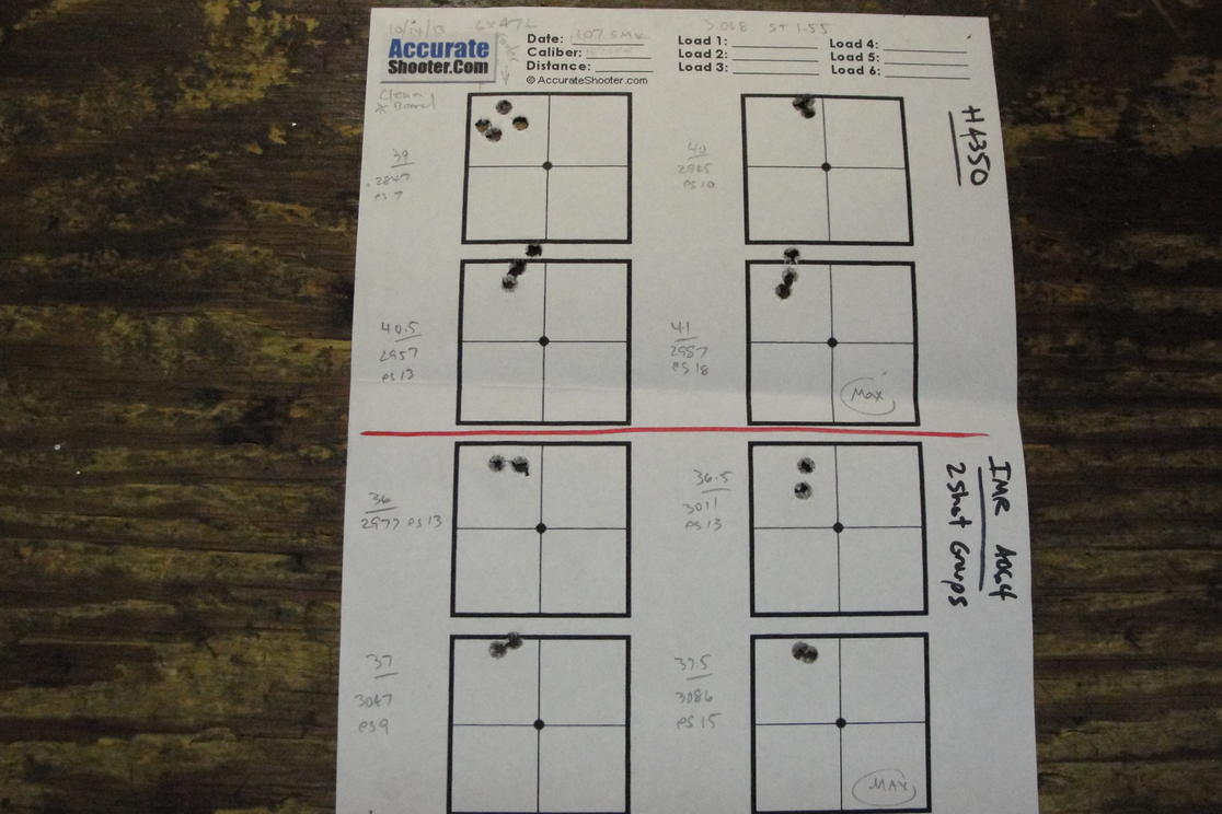

6x47 Lapua
The 6x47L and 243Win were done approx. 8 weeks after the XC and CM, temperatures were a little cooler and I now have a thermal shield for the suppressor for 100 yard groups. Some of the groups from the XC and CM were less than ideal trying to shoot through suppressor mirage in 90 degree temperatures, took a little while but I finally got a cover to control the heat.
The 6x47L reamer used had a .273 neck and .104 freebore, loaded rounds measured .269" at the neck. Brass used was from Lapua, of course. Cost was $1.05 per piece, primer pockets took a light cutting, flash holes did not need to be deburred. The quality of the Lapua brass was evident, necks were round and ding-free, I did not run them through a sizing die- Just load and shoot. Visual inspection of the case shows that its a little shorter than the XC but with similar neck length and body taper, this was the lowest capacity cartridge of the 4 tested
Brass needed to be formed from 6.5x47 brass. I tried the recommended method of running the new brass through a bushing die and sizing all in one step, necks were lubed with Redding Imperial sizing wax. All in all, I found this quite frustrating as many/most of the shoulders collapsed in this one-step process. I also had a forester full length sizing die in 6X47L, this too caused neck/shoulder collapse. Eventually after trashing 15 or so cases at $1 each, I moved to an intermediate bushing to size down the necks in 2 steps, full forming by dies was complete in 3 sizing steps. First the lubed cases were sized with a .280 bushing, then run through a .269 bushing. The bushing leaves a radius on the neck/shoulder junction that I thought might be trouble, so I ran it through the forester 6x47 full length die to get a resizing of the entire neck. Brass was nicely formed but it took time. Redding type S bushing full length dies were used for resizing purposes once the brass was fired. The brass has small primer pockets, CCI BR-4 primers were used here while BR-2 primers were used in all other cartridges. Obviously this brass is available in many retail stores, but Lapua is the only option. Im not aware of any way to make this brass if it becomes unavailable on the retail market
The cartridges were plenty short enough to run through AICS mags when bullets were loaded at the lands, this was the shortest cartridge overall because of case length and freebore dimensions. More freebore could be a benefit as the neck is rather long and you could free up more capacity without causing an overall length concern. Again I was looking to shoot 105s only and the reamer came with the above freebore. Dimensionally it looks correct (as far as bullet seating depths)
I started testing with H4350 as it seems to be popular with most shooters, functional accuracy seemed to be in the 2900-3000fps range. Since the load density was nearing 100% at 41 grains, I wanted to try a faster powder to see if more speed was possible. I used IMR4064 since it has a higher load density than Varget or RL-15, still trying to keep the case almost full if possible. The speeds from 4064 did open up a faster node; the accuracy at 100 yards was acceptable but the accuracy at 300 yards was not. Varget would be an appropriate substitute if one was to keep looking for powder options, I was trying to get solid info from 3 firings of the brass- didn't need to put hundreds of rounds through in search of the perfect load.
Small box targets were fired at 100 yards, multiple targets on single cardboard piece were fired at 300 yards with IMR4064 and both 105 hybrid and 107 SMK. individually cut out cardboard squares were fired at 500 yards with H4350 and the 105 Hybrid only. The 300 and 500 yard groups were fired at a private range with the land owner, we were able to start early before the wind and mirage got too bad. When conditions started to deteriorate, we moved to the 300 yard line, winds were light and blowing between 2-7mph full value. Both the 6x47L and the 243 Win were shot at the same times in the same conditions, 500 yards is the max distance available at this property.
there were a total of 110 rounds fired during this test, the primer pockets remained tight throughout the reloading process. I cant imagine a slower burning powder (than H4350) being very beneficial in this case, in fact I would consider looking at a faster powder to try and uncover a little more speed. All in all the accuracy nodes were quite large, it would be easy to find an acceptable load with this cartridge. Reviewing the 500 yard targets showed good accuracy at this distance, but I cant help to wonder how it would be to shoot this thing on a calm day- vertical dispersion in these groups was average, accuracy was acceptable. Groups were a little better than the creedmoor (comparatively, different distances) and on par with the XC

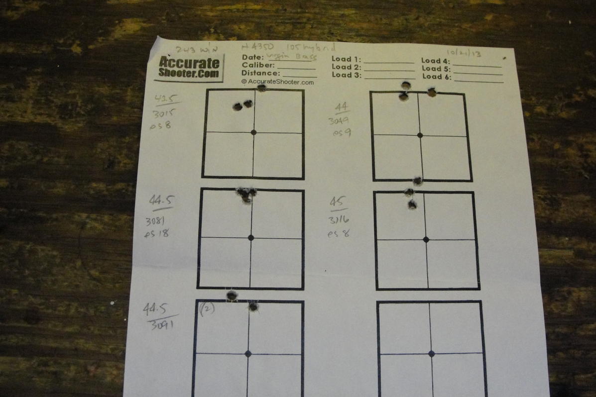

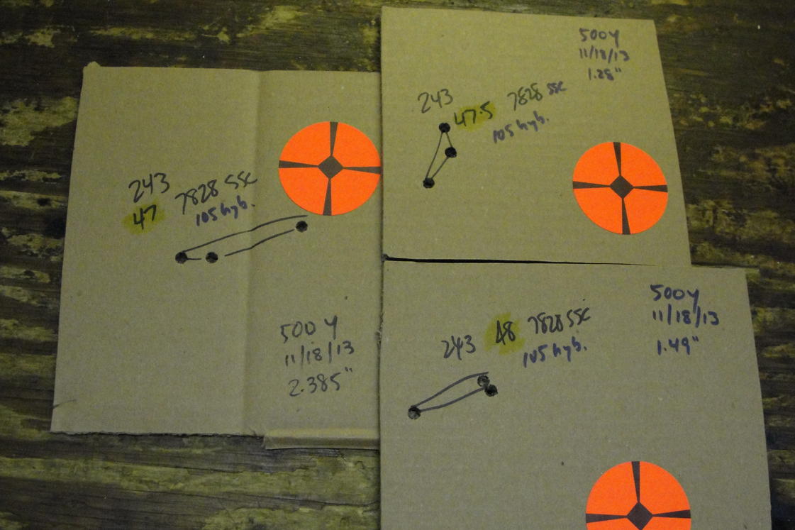

243 Win
the 243 Win testing was done at a little cooler time of the year as mentioned above, 85 degree weather instead of 90+ degrees. The 243Win reamer I used has a .275 neck and .060 freebore, the lead angle is 3/4 degree rather than 1 degree-30, this causes the throat to be "longer" since the angle is more gentle. The loaded brass measured .271" across the neck.
Lapua brass was used exclusively for this test; the brass needed little work, a light cut on the primer pocket and no flash hole deburring. I did not size the brass before shooting, necks were round and bullets seated nicely with consistent neck tension. 243 Win brass is available from a number of manufacturers so that's a big plus for 243 shooters. Redding type S bushing full length sizing dies were used, I usually select a bushing that provides .001 or .0015 neck tension if possible. Overall length of these cartridges were short enough to fit in a BDL box and there was ample room to run inside a standard AICS magazine. The boat tails were noticeably seated into the case body occupying potential powder space. The 243Win has the shortest neck of all cartridges tested, largest powder capacity, and is the longest overall. I decided to leave the cartridge at this length to be a little more "fair" with the others in the evaluation. Eventually I pushed the throat forward to free up some powder capacity, more on this in a minute
Bullets tested were 105 Hybrid and 107 SMK, all bullets were loaded to .020 off the lands. I started with H4350 since I had used it in all the other cartridges, but eventually went to magnum powder later on in the test. I have owned and shot several barrels in 243AI, and the magnum powders usually are chosen to achieve max velocity with heavy bullets, the case capacity with the first throat was not enough to run large charges of magnum powder without having compressed loads. First targets were shot with H4350 on the original throat, accuracy was not what I wanted out of my rifles, functional speed was 3000-3120. The rifle felt fussy and didn't want to consistently group at 100 yards, I had trouble getting reliable chronograph data, so the target progression seems like I'm jumping all over the place looking for info. First reload the velocities went up with H4350, but accuracy continued to be erratic. I pulled the barrel off and pushed the throat forward
The new throat was set up around the two test bullets loaded to clear the deviant magwell and run inside a modified AICS mag, this allowed room to run in an AW mag as well, but not a standard AICS. The new throat opened up some powder capacity and I switched to IMR7828SSC and resumed the testing. 7828SSC has a burn rate similar to H4831SC and RL22, but it has lower load density and Quickload predicts lower pressures and higher velocities. I shoot 7828 in many cartridges, and I can agree with the QL prediction. The groups started becoming a little more predictable, and I feel like this was a good direction to go to get the last bit of performance out of this thing. Unfortunately I wasn't able to get complete chronograph data for the 7828 loads, but Im expecting this brought the functional velocity up to 3025-3175.
The accuracy at 500 yards was a bit of a surprise considering how things were looking at 100 yards, but I was pleased with the results. I would estimate these charges were getting 3100-3150fps, this speed with this accuracy would be an effective match offering. There is the potential to comfortably run 115s in the 243, I didn't explore this but have interest to see if it would offer a ballistic advantage to the 105s. This could help getting all hit points at 900 yards and beyond, Ive seen guys make hits with 105s going slower and they are hard to distinguish at long range due to the decreased energy delivered on target. There was 90 rounds fired through the barrel, primer pockets were acceptably tight considering some of the loads used were pretty stout

Similar to what I saw in the 6mm Creedmoor(not to be confused with the 6CM). The primer pockets do not hold up well, Win or Lapua 308/260/243 brass formed holds up much better. Try the 6CM or 243-30degree AI more or less, there's more room to find nodes within the velocity range needed.
It looked like the accuracy order is 6x47L, 6XC, 6CM, and 243 last. That's based on the 500yd groups but then some were 570 yds. It's great to see this write up. I'm interested in more information on the 6mm. I've been shooting a 6SLR lately and watching the velocities for nodes.
From what I'm seeing the .243 actually took top spot accuracty wise:
243 = 2.385", 1.28", 1.49" for an average of 1.718" at 500 yards
6x47 = 2.56", 2.165", 1.77" for an average of 2.165" at 500 yards
6 Creed = 2.16", 2.15", 2.48", 2.91" for an average of 2.425" at 570 yards
6XC = 2.4", 2.729", 1.051", 1.253" for and average of 1.858" at 570 yards
There's 1/2" difference between groups at both ranges and the OP stated that conditions weren't ideal, other than when he shot the .243, when there was hardly any wind at the time.
To me the data sampling, while good, is still too small to determine much, other than they are all very similar. It would be interesting to see what happens at 1000 yards with each cartridge, after the best accuracy node is found.
