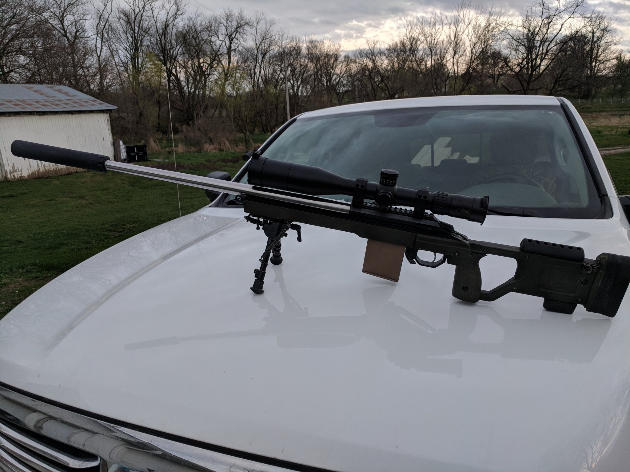

Just got all my components in and will hopefully have bullets on paper in about a week. Results will be thru a Tikka and a 1-8tw kreiger.
Reactions: XLR308

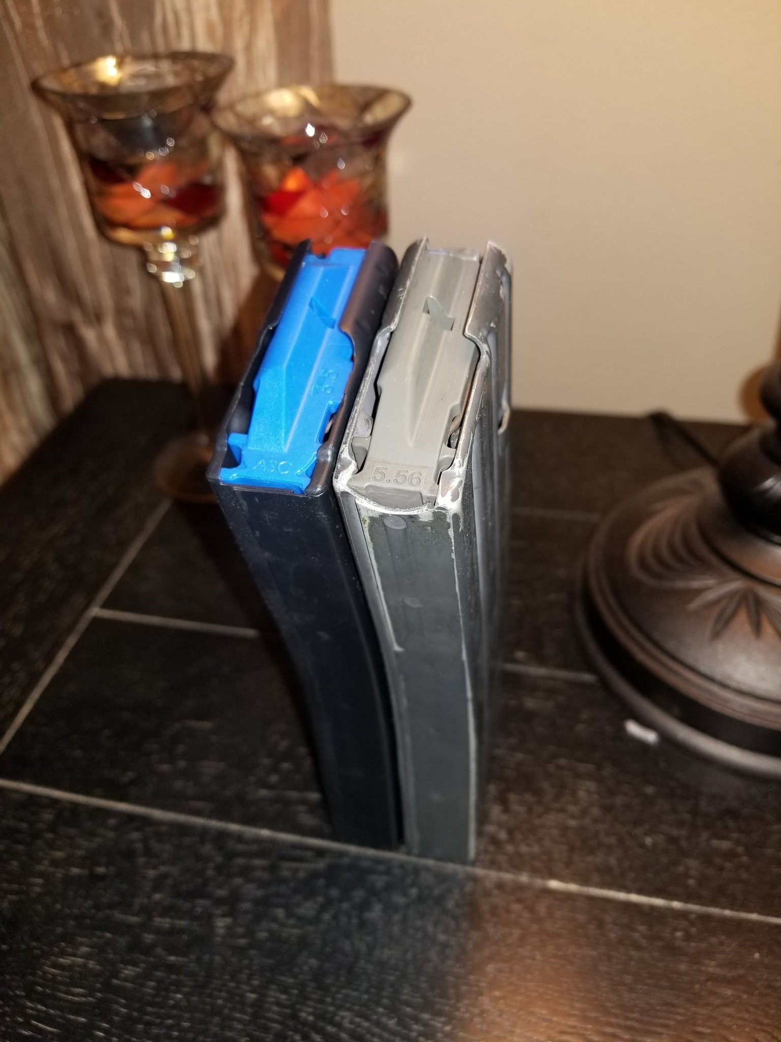

So where do you get these "weird curved magazines"? Grendel has less body taper than 6.8spc, and every one I own or have built run like a top just like your 6.8.
You apparently dont understand the difference in small frame and large frame calibers either comparing grendel to creedmoor, or valkyrie to 22-250. You really should patent that 224-250 wildcat before someone steals that idea!
By the way, here is a pic of one of my 6.5 grendel mag next to a 5.56 mag. I'll keep looking for one of the weird curved mags so I can say WTF.

Did a little shooting the other day, this has zero freebore so I'm trying the varmint bullets and working up from there. Currently I'm shooting a 58vmax @ 3000, 75grn vmax at 2750fps. I'm working my way up and watching pressures and brass life. Looks like I have a ways to go before I hit the wall.
I have a 6x6.8 which is pretty similar to what you're running. I can run 70grn Sierra blitzkings over 3,200 fps so yeah, you have some room yet :). Keep the load development going, it makes for good reading. Most importantly.....have fun!!
