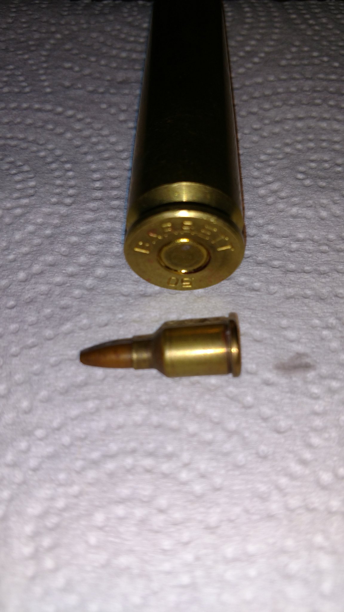

Usually you see a collapse when a die is tightened down too much or the case is unsupported.
On a bushing die you can back the die off and screw down the micrometer top and collapse brass because it's not well supported.
As Idaho-5r said the Redding body die will have a loose neck fit and the die is cheap. This small step might be all you need.
I have collapsed my share of cases but I take much larger steps than you are doing.
Not sure what your referring to on the micrometer top. All my sizing dies wether they be bushing or non, don’t have any micrometer top. Only micrometer tops I have seen on dies are seating dies. How much support the case has is constrained by the geometry of the die, I cannot change that by moving the die up and down. That would simply change when the case engages the die with respect to stroke. The die don’t colapsing the brass from touching the shoulder, it’s doing so from applying force at the neck, and the shoulder cannot take the force of compressing the neck.
I hear ya man, very frustrating. It very well could be some uber soft brass.
The body die actually has an opening larger where the neck sizing portion of a regular sizing/neck die would be. This is to ensure that the body die does indeed only bump the shoulder/ body and not affect the neck in anyway. The dia is between the 6.5 and 6 so it will step down the sizing of the neck allowing the Forster die an easier pass on the brass.
Sorry couldnt help more, hope ya get it sorted out.
That makes sense now about the body die, I think necking down in two steps with a bushing will be my last ditch effort. At this point just firing in my 6.5 isn’t a huge deal, since it is still a match grade barrel.
The Redding competition bushing dies have a micrometer top and you can adjust the die wrong and collapse the cases.
Try this as it's free and you have nothing to lose
Remove the entire top of your die so all you have left is a hollow die body. Give that a try.
And yes a body die has a larger than normal neck opening and if you want to give one a try let me know and I will mail you one.
Mine is also a 6 BR but it should work.
You must be referring to the Redding comp neck sizing dies. I don’t own any of those dies so I have no way to try them. I am going to try the two step method with a full length bushing die. Given I full length size anyhow this wouldn’t be a total loss on the firs themselves. I have no use for a seperate body and neck die other than this expirement.
