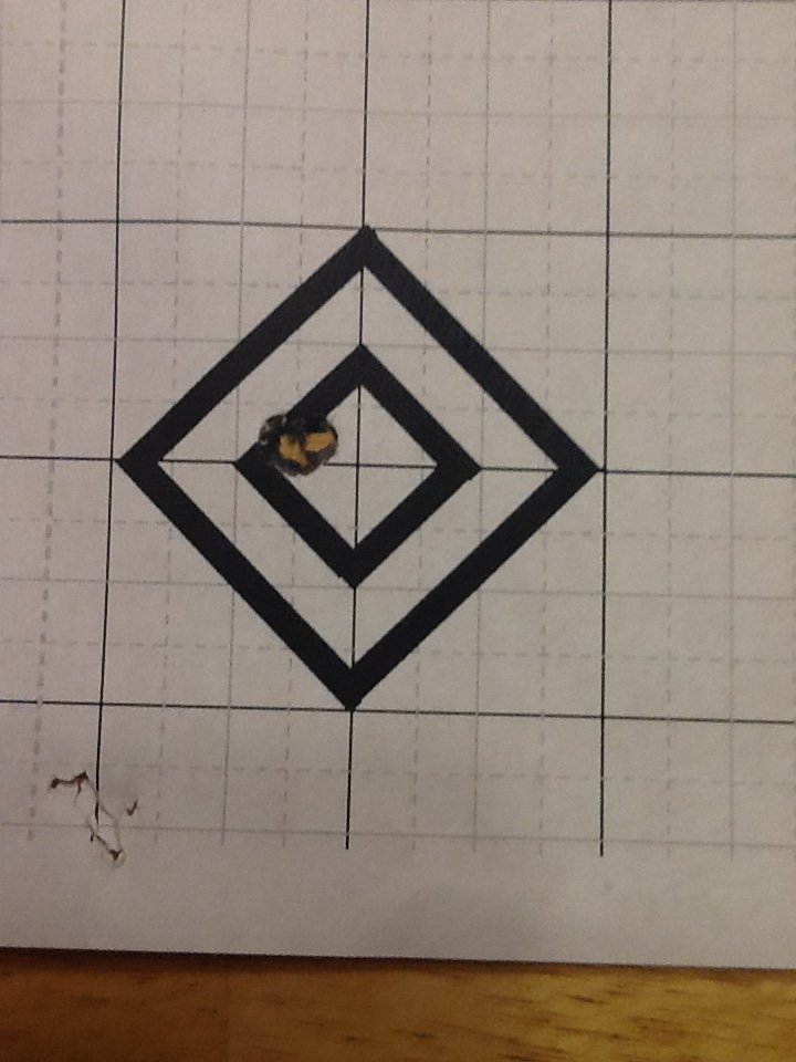

Doesn’t seem like a powder used by too many. Did you get decent velocity as well as accuracy
Used to be Tubb’s powder of choice for the 6XC. Yeah, velocity is top notch as well. I think I ran it up to 3180 or so, before I left ejector swipes.
This was 42.5, which left swipes. This was very early (50), so barrel hadn’t sped up yet.
