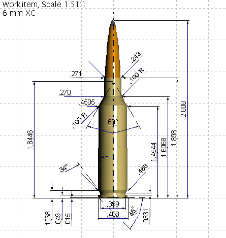

I have noticed that the case is not based on a 308 .473" bolt face but slightly smaller. While that may work in a bolt gun, I'm questioning whether that may present an issue in an autoloader. Thoughts?

?- the 6XC is but a 22-250 run a bit short and necked up,
in other terms it should be of the same diameter in the base as a 308 win case.
I have had the pleasure of dealing with 5 different rifles done for the XC, one T3, four Rem 700 or clones, all intended for 308 Win to start and all are flawless in feeding and ejecting.
Could it be that you are looking at different sets of prints?

In my small world those two cases share the same bottom measure.
The drawings I think are decent enough since they are from Normas webbpage.
Alas, I really think that you are on to something here and I would love to see a autoloader in 6XC.
Best regards Chris

Interesting.....
This was the cartridge diagram that I was working from. This comes from 6mmbr's website.
Re: 6XC in an autoloading LMT MWS?
Chris,
Yes, that is very helpful. I'm beginning to believe that the 6mmBR diagram was simply incorrect although would like to verify this in prints.
