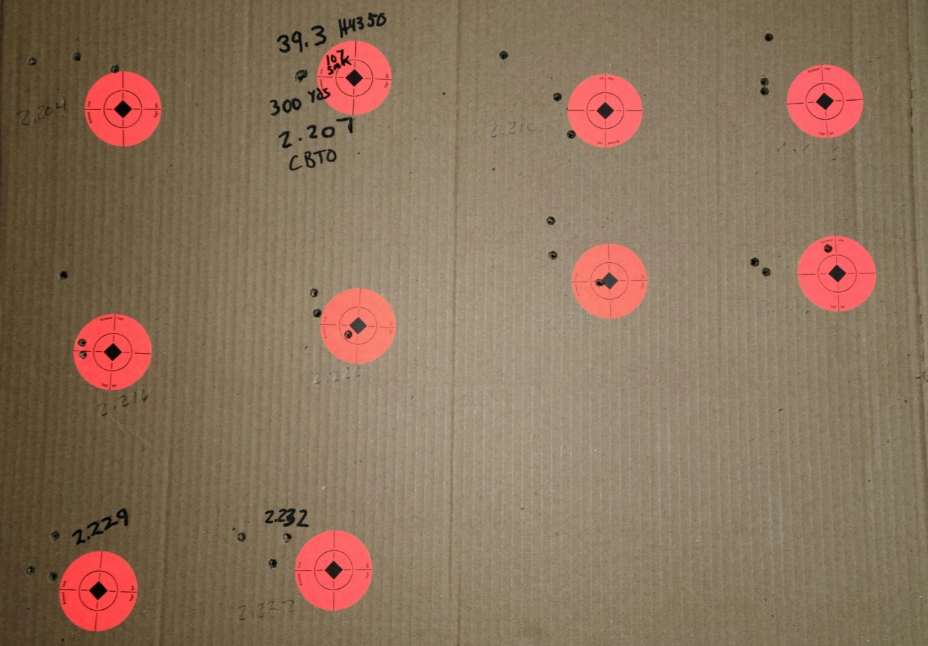

I'm not shooting 109s in my current barrel, but 107 matchkings have been awesome. My current load:
Norma brass
Cci br2 primers
39.3 grains of H4350
Using Eric Cortinas bullet seating method. Jam -.020
Gives me 3040 fps with low SD numbers. I would start with 38 grains and work up from there.
Norma brass
Cci br2 primers
Gives me 3040 fps with low SD numbers. I would start with 38 grains and work up from there.View attachment 7589770
