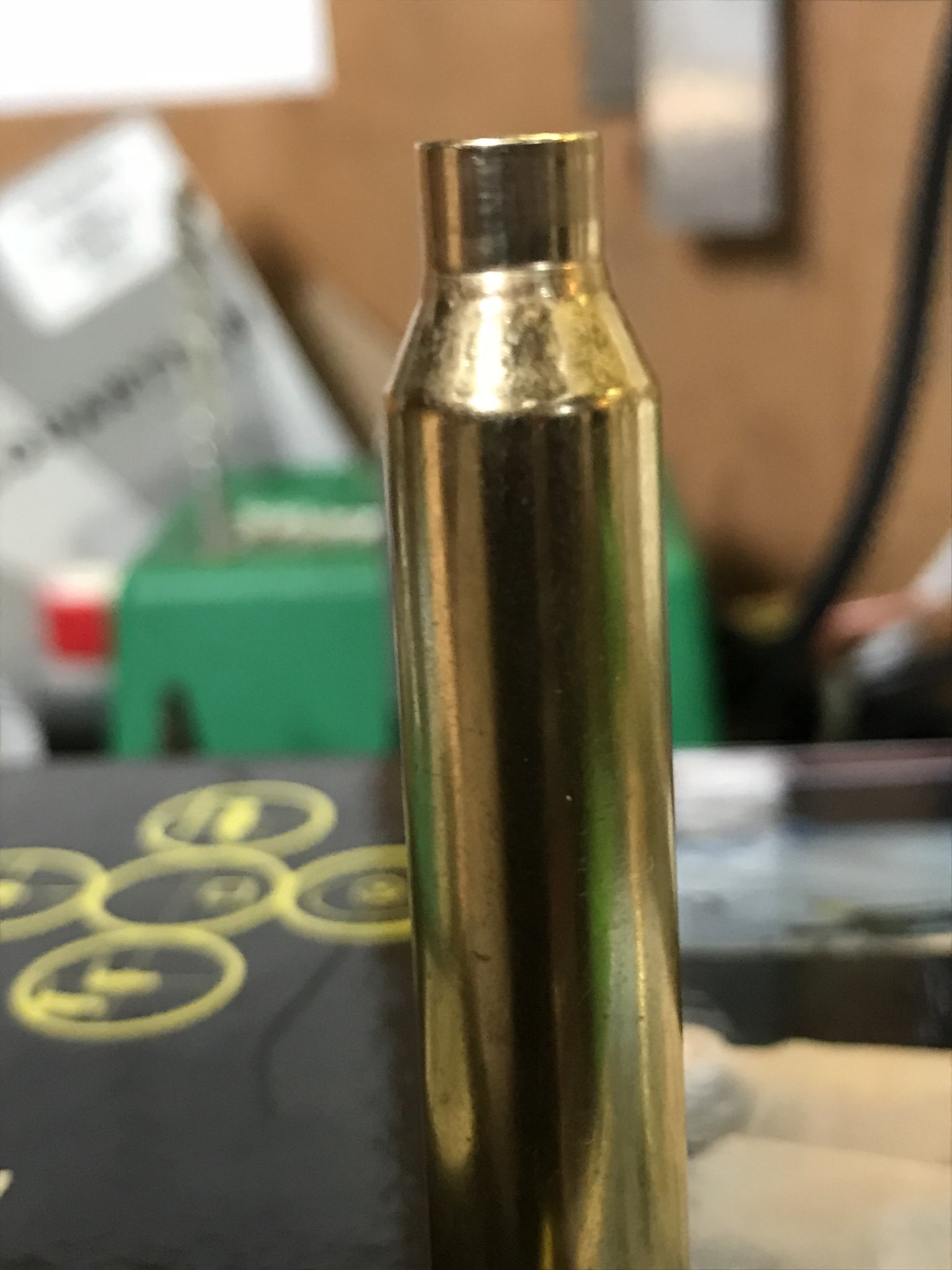

So far everything seems to work. Went down in .005 increments down to .315. No doughnuts, no issues. I still need to figure out the correct neck tension.
So 2 questions though...
First, it doesn't seem like it is sizing all the way down to the shoulder. See attached photo. It is ALMOST there. My dies are down as far as they will go. Is this going to effect chambering or accuracy? Is it something I should worry about?
Second, how do you actually determine correct .001-.002 neck tension? Do you figure out the slip-fit then go down .002?
Thanks guys!
Bushing dies don't make it all the way to the shoulder - neck junction. What you have is normal.
To determine 1 to 2 thou of NT, you said you were at 315 now right? Seat a 284 bullet and make sure it doesn't just slide into the case. If it seats fine, then take that measurement and subtract 1-2 thou. Chamber that dummy cartridge to make sure it fits. If it is really tight, you have to turn the necks a bit.
