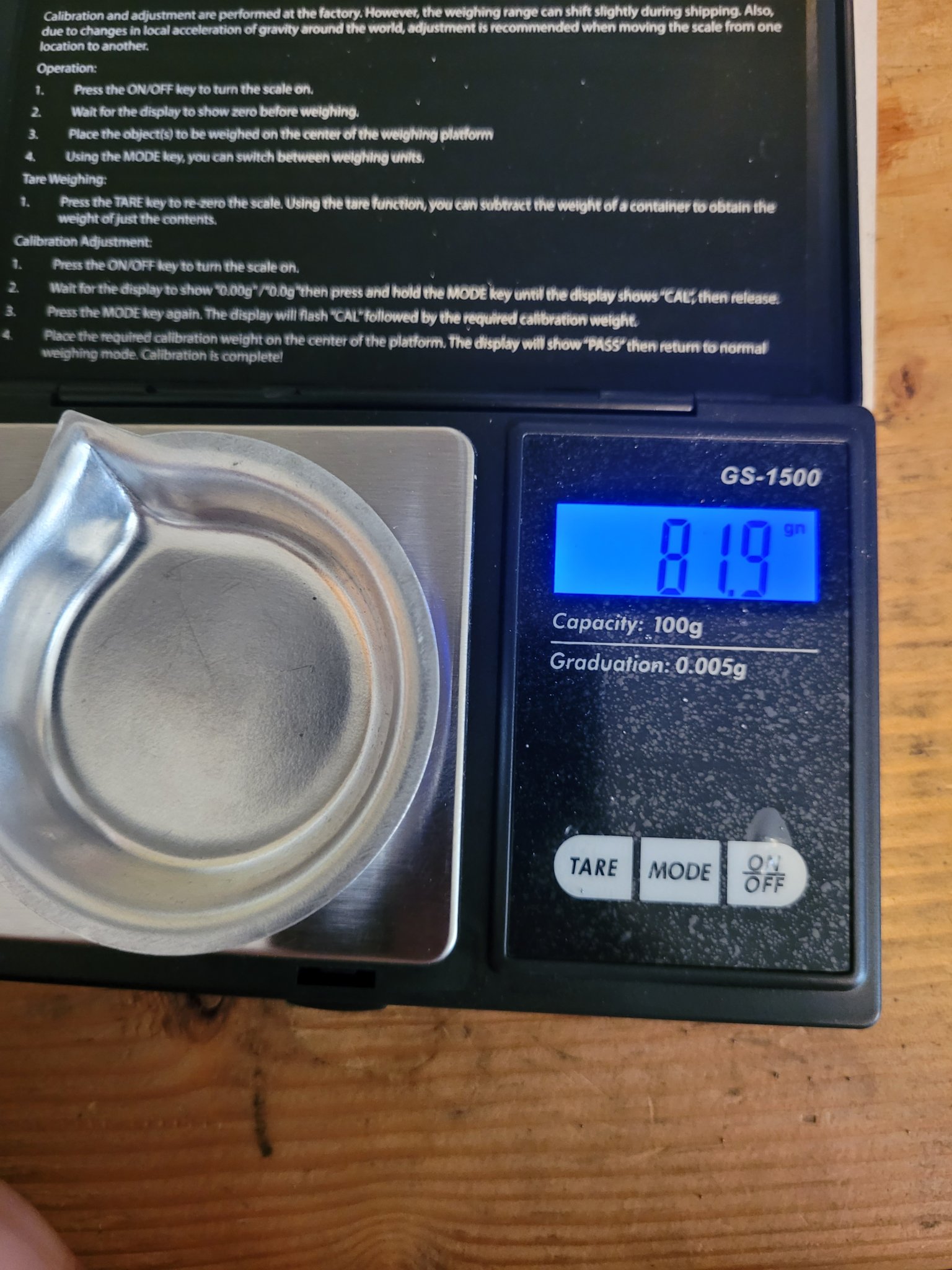

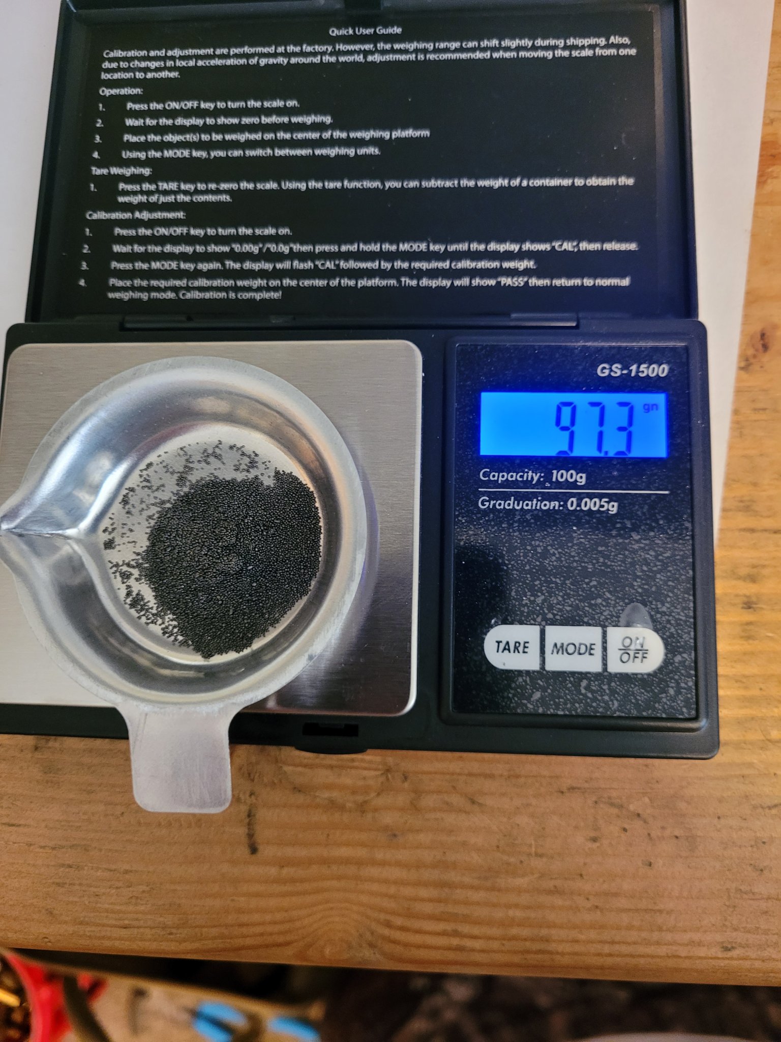

I pulled apart a round of the F5 designates ammo, the 95 grain copper hollow point. It was in a rather caveman like fashion I'll admit so the bullet is no longer pretty. Here's what I found though, just so it's documented somewhere
The bullet itself
.747 in length from base to an unmolested edge
.306 in diameter
94.7 grains (was probably exactly 95 but it lost some material in the plier teeth)
The powder is a very fine ball powder it looks like. It was packed solid in the case and required agitation to remove, not much was lost but is worth noting that I did lose a few granules. There was 15.4 grains of measurable powder when I was done, likely 15.5/6 after loss.
The bullet sets pretty far down past the neck, shoulder, and into the case.
