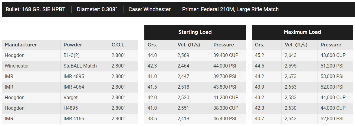

And these are velocities that don't match your bbl length or exact bullet, but just for perspective here are service rifle loads from Hodgdon. You can get the idea of how your Varget and H4895 loads stack up.
  • 14_loading.pdf

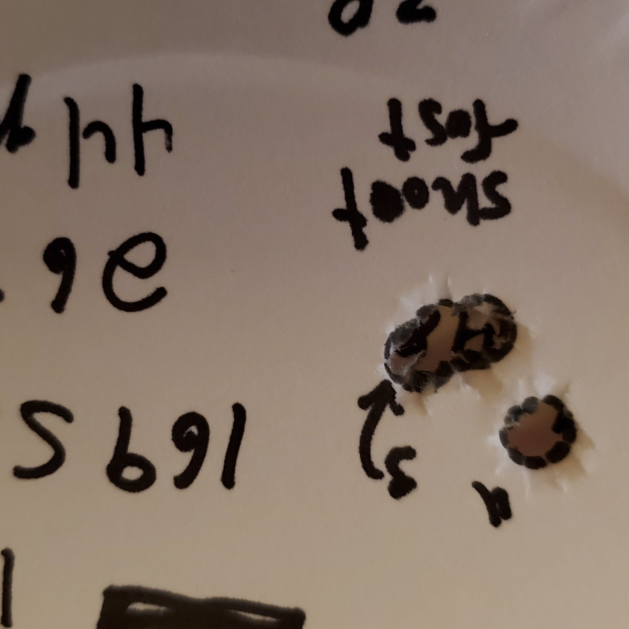

AR 10 308 Gas gun 16" barrel 6 lbs, 2 oz with out scope.
It likes a number of powders, 1/2" 5 shot groups can be obtained. 168ELDM at 2756 fps a max manual load for this powder, for speed. IMR 4895 is very accurate too. As are the 169, & 177 SMK.
A light fluted SS barrel, carbon fiber, titanium, and magnesium....it will often put 2 or 3 in almost the same hole at 100 yds
You can even use LC brass, no brass prep, but that may be the cause of the occasion flyer off the center of the group...or the shooter.
