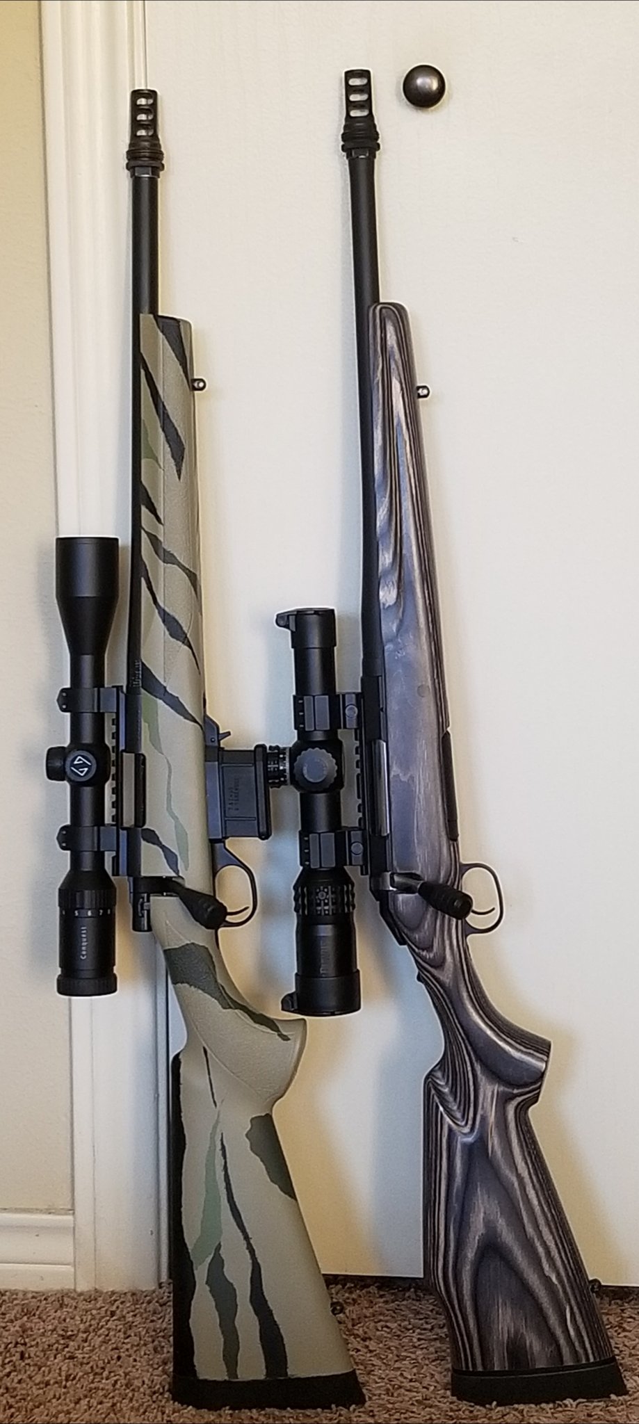

I have one in a Howa mini action, and love it. It's on the left.
Factory barreled action with the barrel cut to 16.25 and threaded 5/8-24. Bolt handle job done by local 'smith (Penty Wheeler in Royse City, TX). Factory stock with a Krylon job, and topped with a Zeiss Conquest 3-9. Factory trigger modded to break at ~1.25 pounds. TONS of fun.

Sweet. Any info on accuracy/MV ?
With Wolf 124 gr HP, I can score an occasional 1 MOA 5-round group at 100, but I have to really be on my game. More commonly I see ~1.5 MOA out of it.
Wolf 154 gr SP is pure shit in my gun and shoots about 3 MOA. Hand loads using the Sierra 150 gr .311 projectiles go into about 1 MOA at ~2150 FPS.

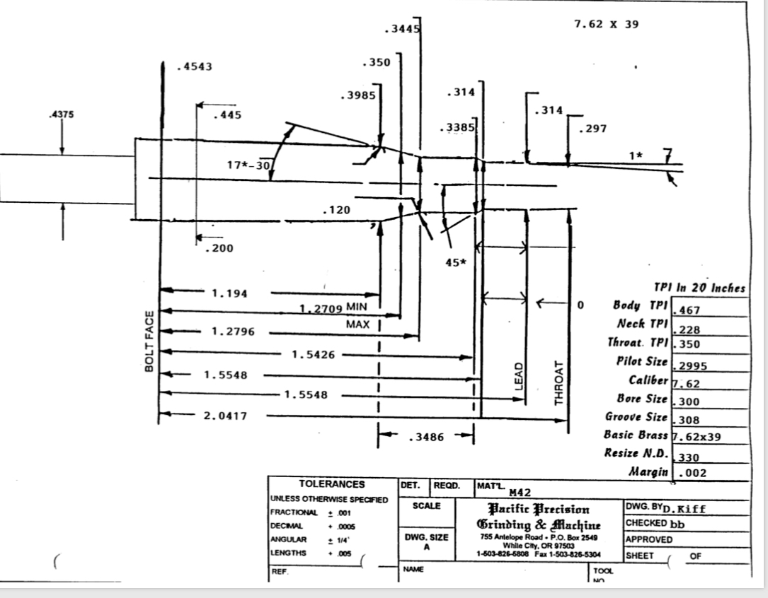

Lapua makes the brass. I was thinking of having my reamer re-ground to be more appropriate for a standard .300/.308 barrel, and throated for 30 cal BR bullets(like a 30 BR would use). I bet it will shoot ragged holes.
