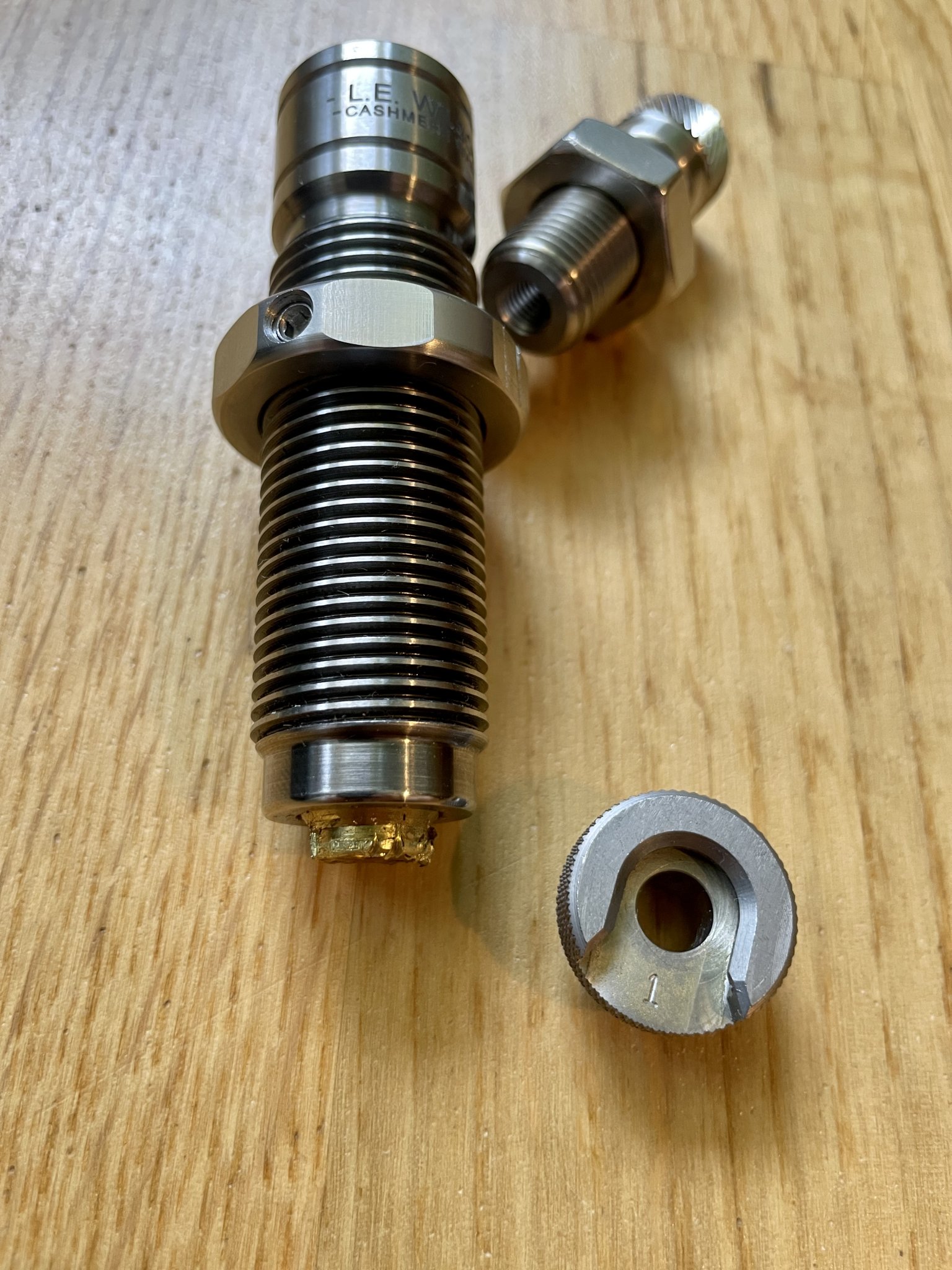

Hi all,
today I've messed up my Wilson Bushing Full Length Sizing Die. The bottom of my 7mm/.284 Win Peterson case torn off.
The attempt to remove the case from the die resulted in the loss of the die and the .314 Redding titan nitride bushing.
I've had no issues with full length sizing new cases at all! They do fit into the die very well. After the first firing, the last 0.5 inch of the case did not fit into the die anymore. I've removed the bushing, but it still did not fit without an unhealthy amount of force. I've solved the issue with a lot of Redding die wax, but still need too much force pulling out the case of the die.
I've also tried to use 1:8 case lube with Lanoline and Isopropyl alcohol to get better lubrication. This did not work at all and the result was the damaged Wilson die with the case stuck in it.

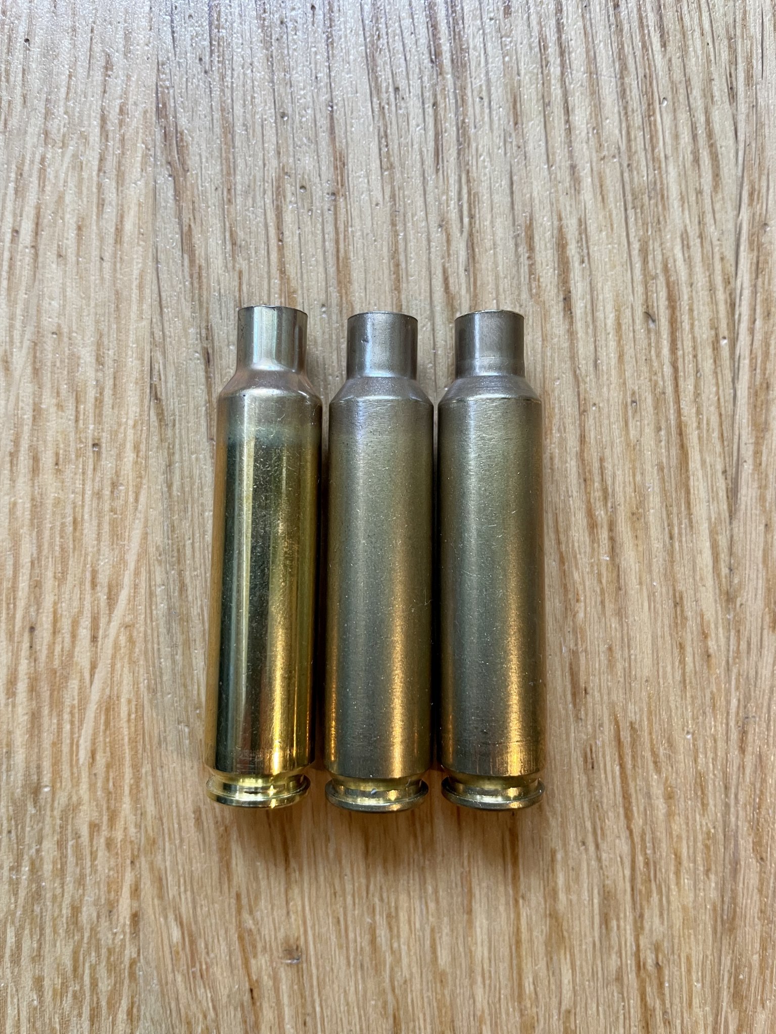

Here are the photos:
I have tried tu pull out the brass with the pliers … no chance at all!
From left to right: .284 Peterson new, fired, sized (Wilson sizing die from above, before damage)

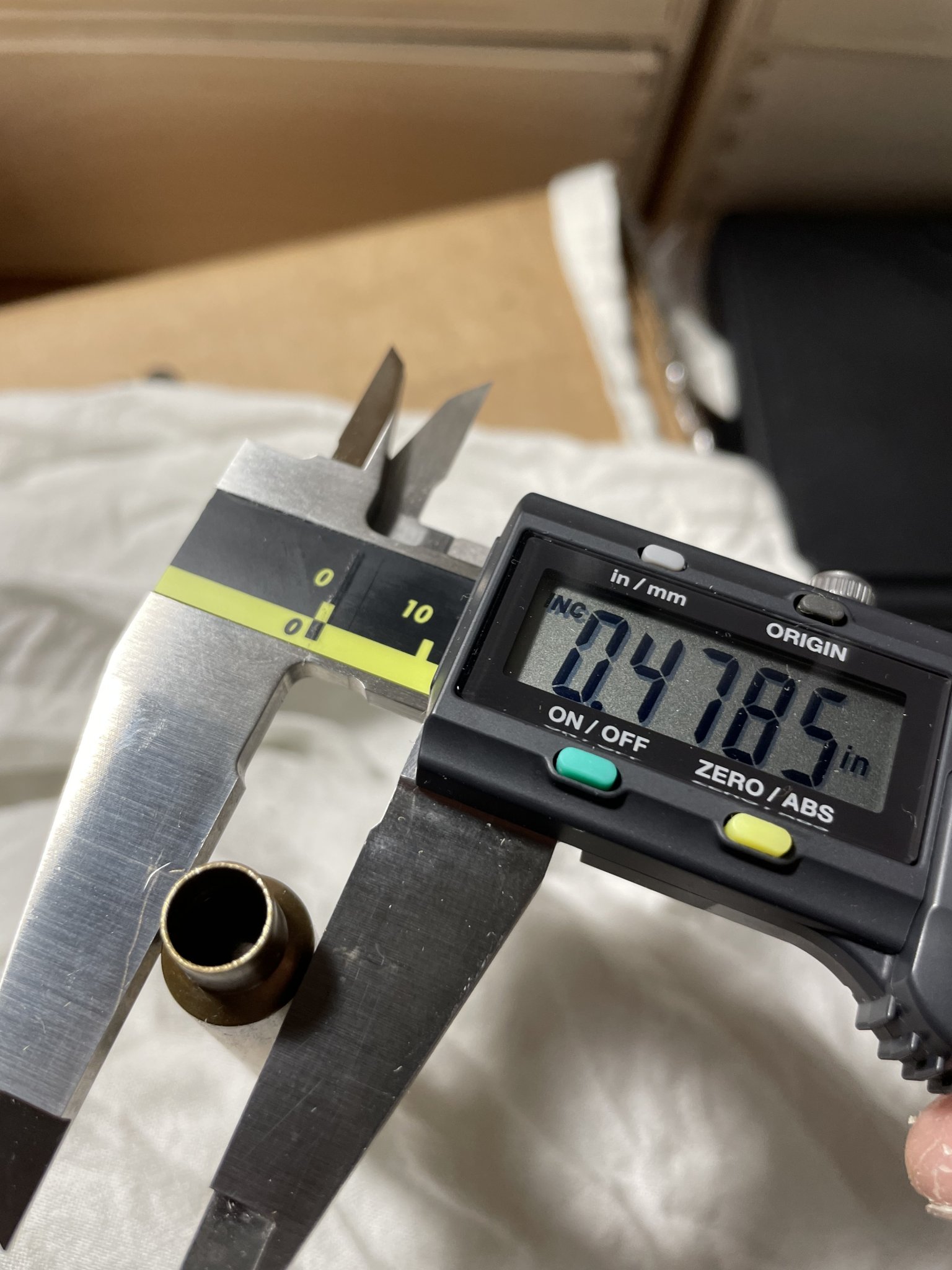

measure the neck to shoulder junction diameter of your fired brass
.284 win should be no more than .478"/12.141mm
.284 shehane will be about .485"/12.319mm
the fact that your new brass fits in the wilson die,
means there's likely nothing wrong with your wilson die.
It measures .4785“ st the largest diameter for a fired brass / not sized.
But this is exact the min diameter for P2 for a regular .284 Win according to CIP.
the reamer prints i can find have that between .474-.475” max
I would clean the die, and try again
to press the piece of brass out of the die,
use a punch and a shallow socket or something in a press or a vice
