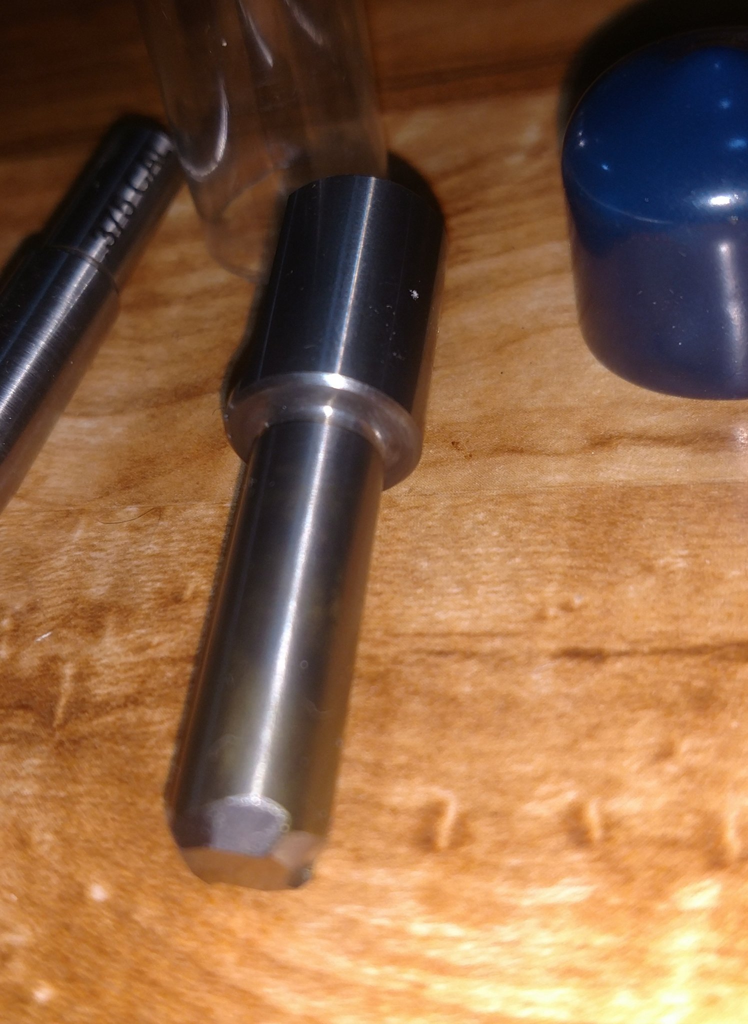

You want to keep the bullet in front of the donut area because it is an inconsistent restriction. The brass varies too much so tension and seating depth are both affected.
Some shooters will buy the K-M carbide neck cutter just so they can remove it. Picture shows the cutting flutes.
Before ordering a reamer I would get a single piece of brass and the bullet you plan on shooting just to make sure your magazine can handle the length.
