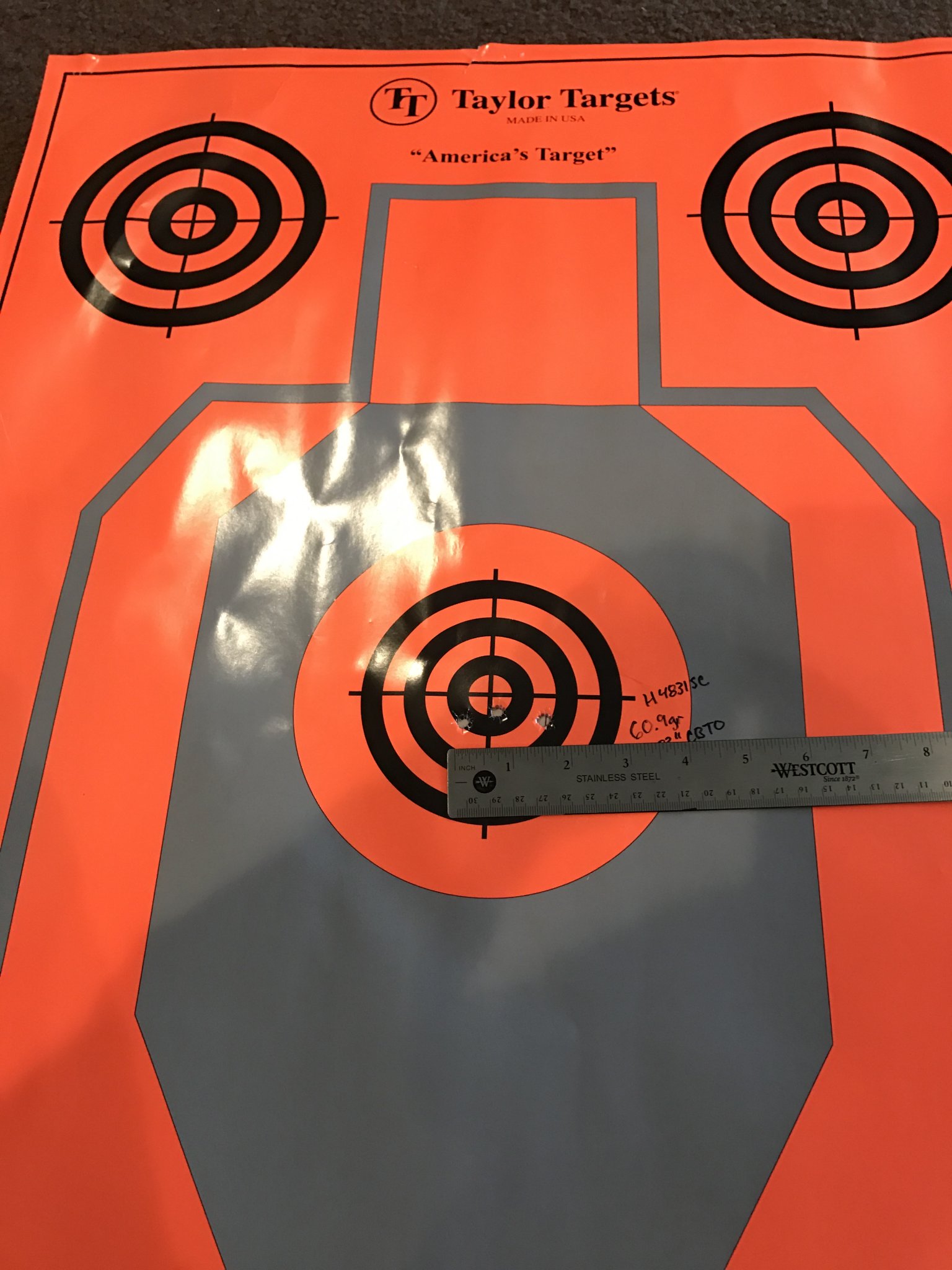

180gr Hybrids
Norma Brass
Tula Magnum Primers
60.8gr H4831SC
2840ish fps
24” length and 8” Twist
Below group on orange target was 610 yards with 60.9gr in virgin brass and I believe I was about 0.015”jump.
The diamond target is 300 yards and running seating depth from 0.045”-0.095” jump. Backed charged to 60.8gr since brass is fire formed. 0.075-0.095” jump were the top left 3 rounds measuring easy under an inch.
I’ve also used H4831sc with 150ablr’s and 168ablr’s at 61.0grains and also got good groupings. H4831SC like others have mentioned has worked really well for me.

180gr Hybrids
Norma Brass
Tula Magnum Primers
60.8gr H4831SC
2840ish fps

The main driver for the 300yard test was to see if there was a wider node in seating depth as I’ve observed that the hybrids will shoot really well somewhere in the 0.010-0.020” jump range but it is very narrow. The 300yard seating depth test seemed to show no major change of impact from 0.075-0.095”. Basically said I think Its stating to prove out what the PRS Blog article regarding Mark Gordon’s work with seating depth saw.
