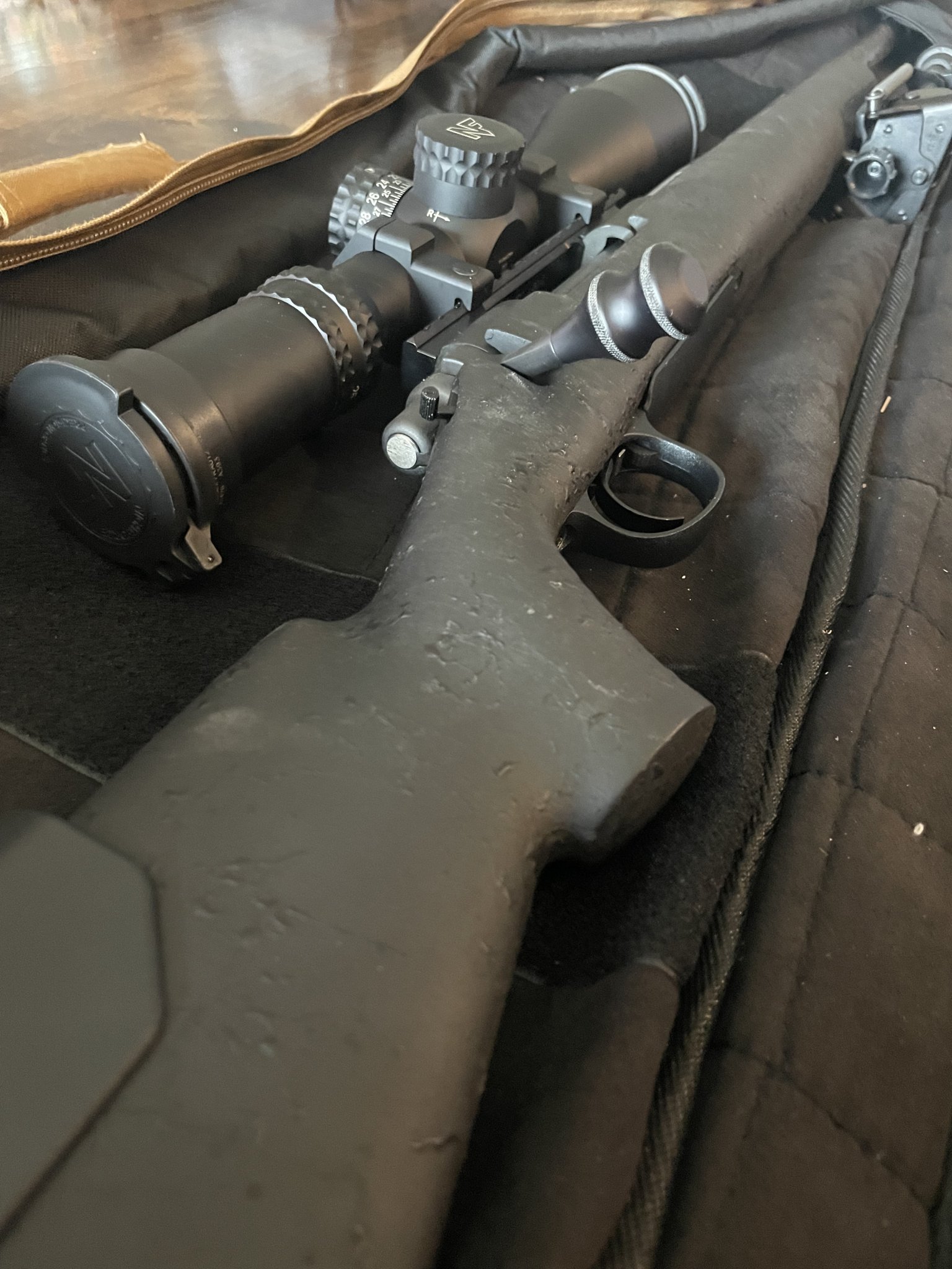

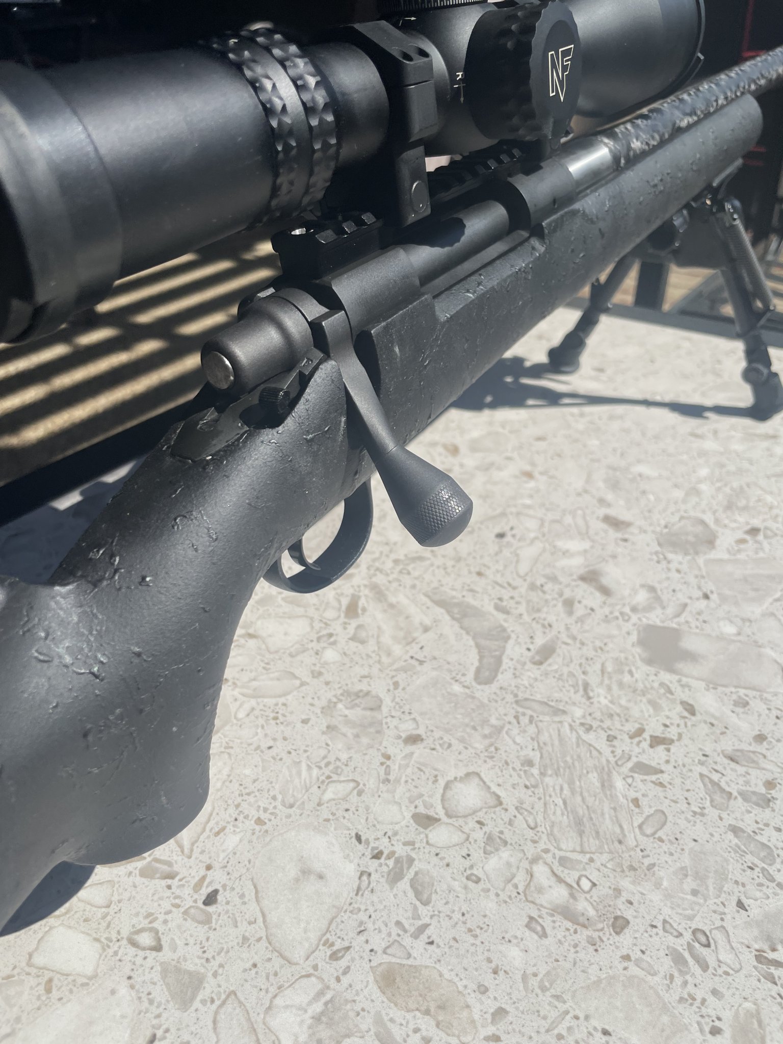

Hello all, I recently picked up this 700P from a local face to face deal. It has extensive modifications, however my question is the direction of the bolt lift handle threads
I didn’t think 700P’s came with this bolt so not sure of from factory or added later.
Based on the pic of this bolt handle, is it first of all removable, and if so, is it a right thread pitch or left threaded?
I have an Area 419 lift handle and I cannot get this current handle off. I’ve tried a monkey wrench and a leather strip for protection, I’ve tried a workbench vice with leather, doesn’t budge. I soaked the handle under hot water for a minute and tried the vice with no luck.
Any pointers are greatly appreciated.

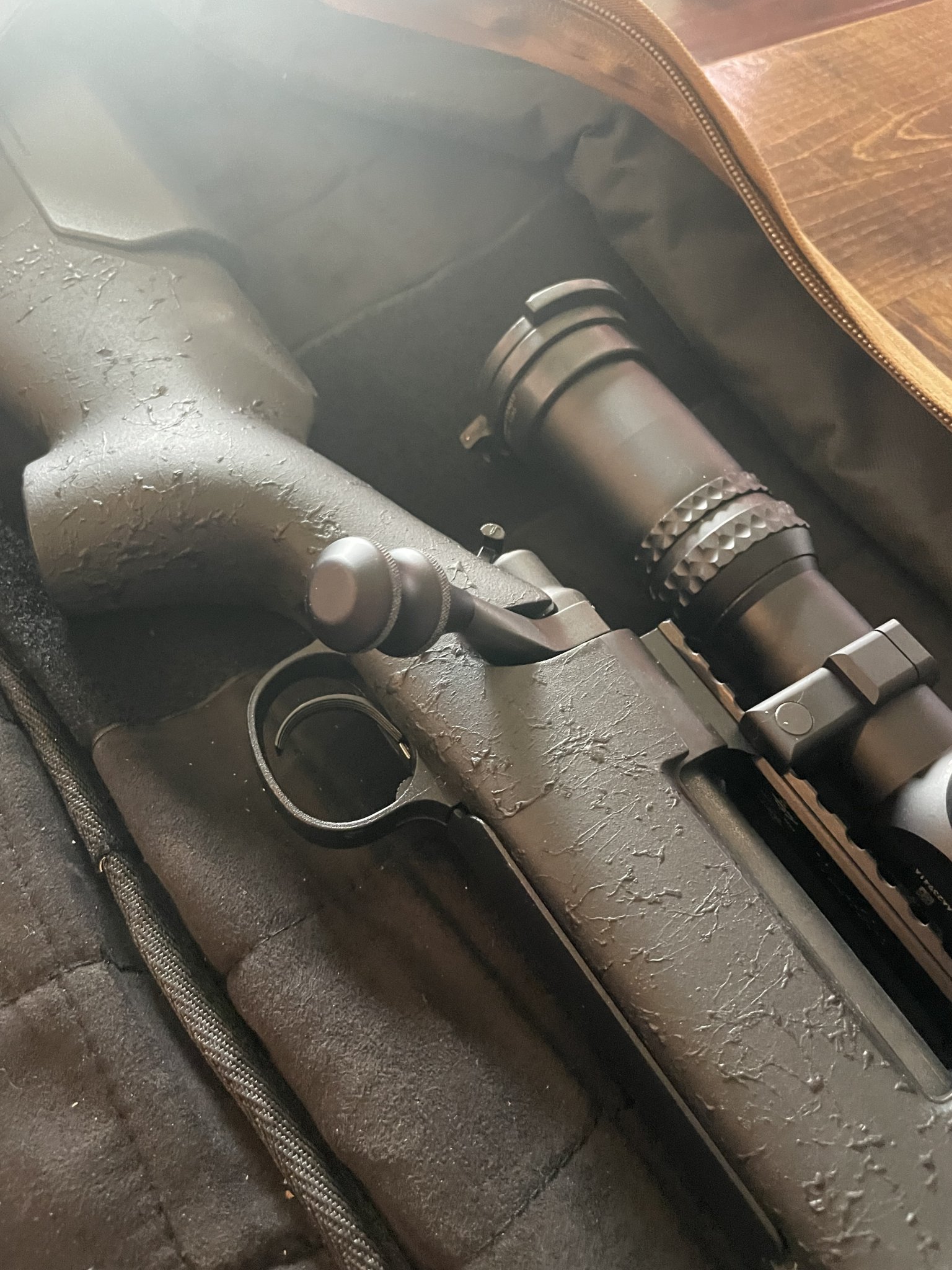

Problem solved, it just had a record amount of loctite on it. I ran it under scalding water for a couple minutes then used a padded table vice grip with the knob in the vice, came right off.
