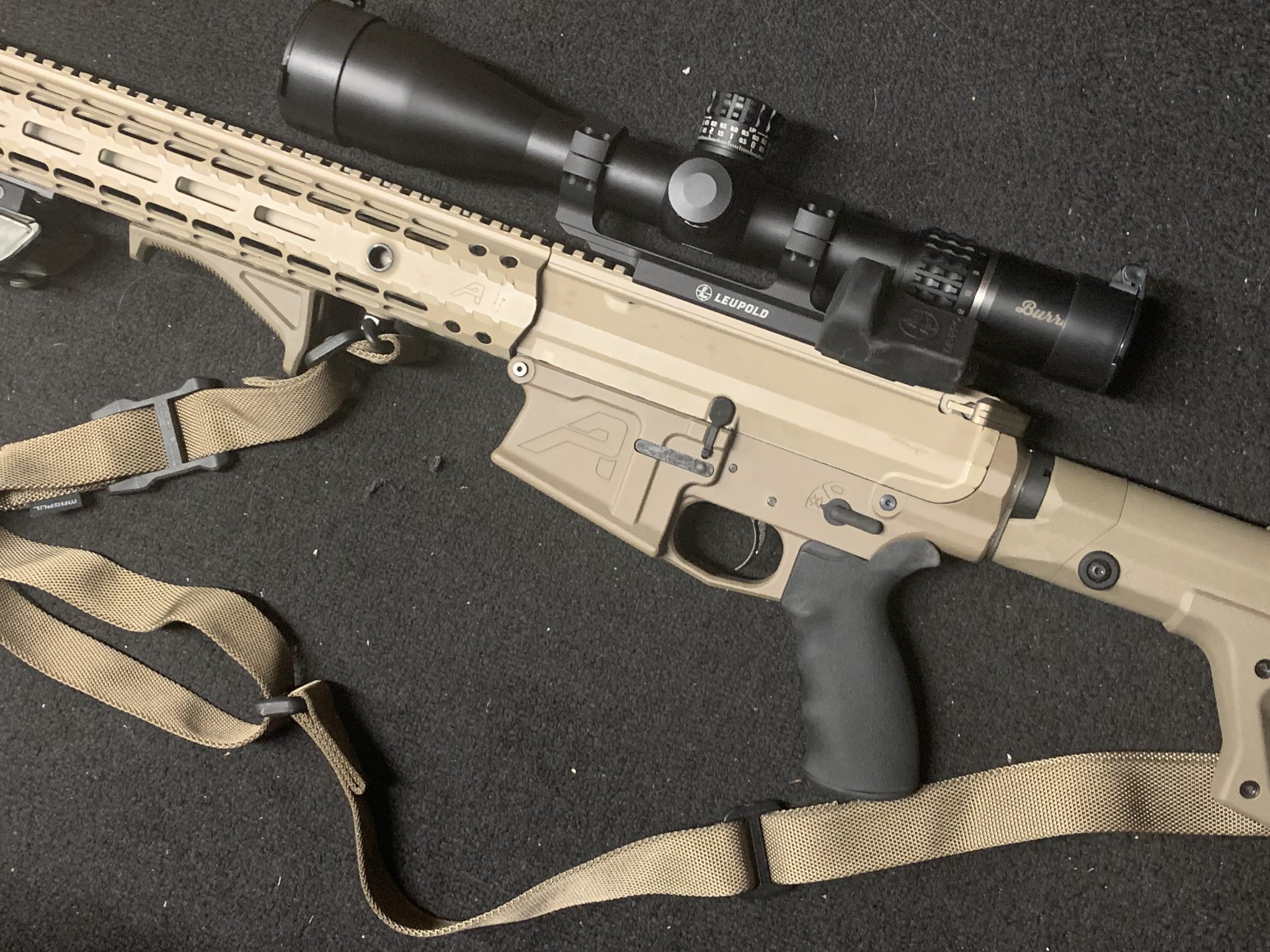

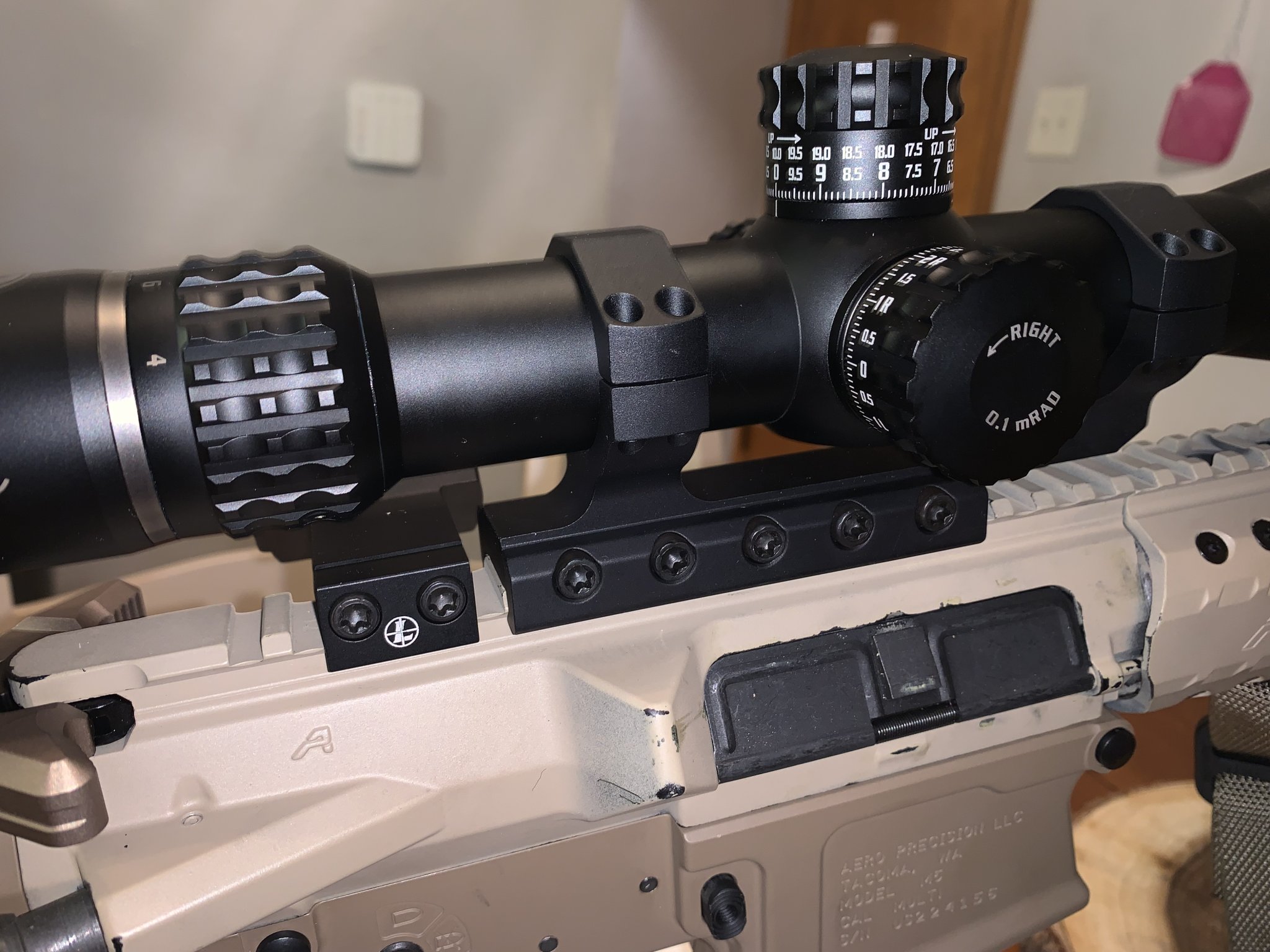

Thanks, Nikerret. Do you know the scope mount height necessary to clear the 42mm objective without becoming too high? That is the central puzzle for me. How did you handle the offset? Just separate offset mounts off the main pic rail?
I've never had a Leupold mount give me problems even on very high capacity cartridges, although once I had a Burris ring snap. Back in the day it was the difference between forged steel (Leupold) and cast (Burris), which gave up after less than 50 rounds on a 30-06 class cartridge.
Here are the specs on the scope mount:

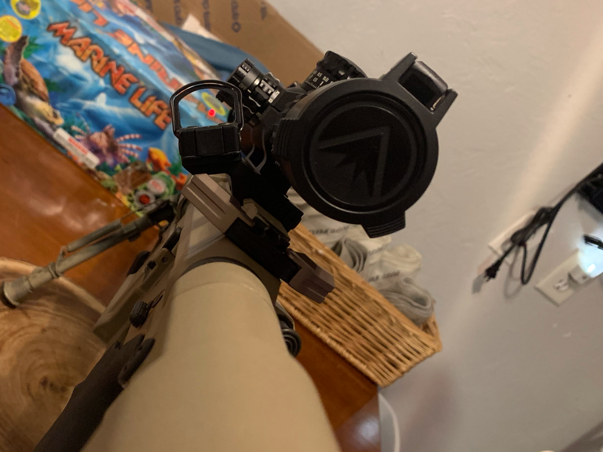

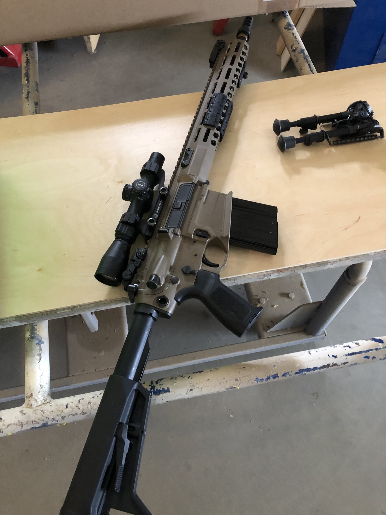

Mine has a leupold mount as well works fine. You can add an offset dot if you need it. It did have a qd mount and a higher powered optic but I prefer it this way. The folding irons will be junked for something offset pretty soon.

I'm kind of with you on your scope choice. I have some doubts about the boat anchor aspect of Burris XTR-II that I'm going to initially stick on top to see if I care much about 7x-10x on that rifle. Maybe later I'll drop back to a 1-6 SFP scope. As a personal thing, In my world I don't have much use for FFP until range exceeds something over 400 meters at about which point I am starting to wish I had more than 6x, even though it'll do for my targets just fine. For that reason there is some appeal to a lever mount rather than hex bolts. I can conveniently have two scopes as long as return to zero is dead nuts repeatable. I'll bet 96% of the time the LVPO would ride the rifle just because.
I would shoot them both from a good rest and whichever one groups the best I'd put the higher powered scope and better trigger in it. The other one get a red dot and leave it alone. In the past all my rifles had qd mounts but with the offset sight thing super common and easy to do there's no point imho.
