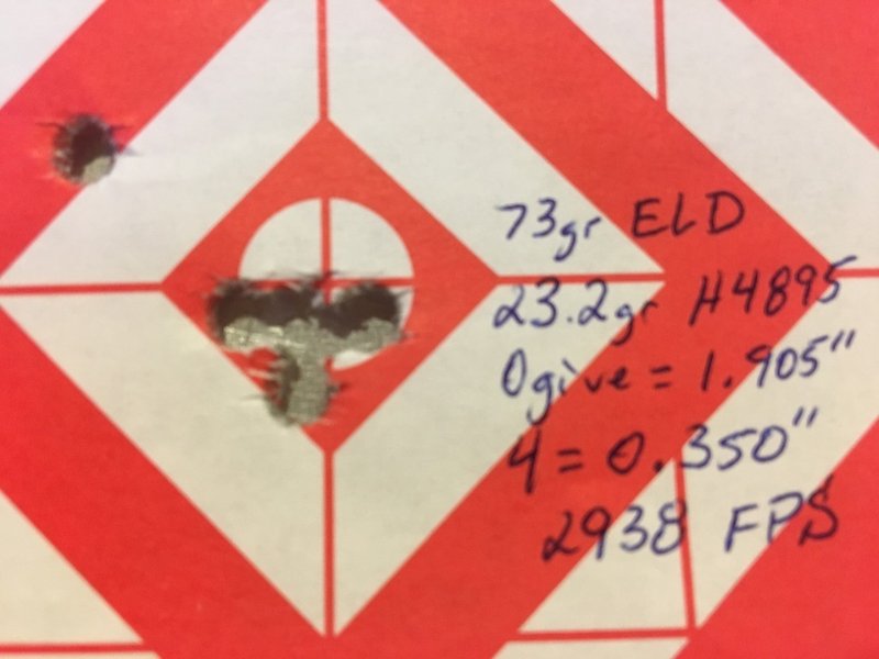

While I was waiting for the 75gr ELD to show up in stock I passed the time playing around with the 73gr ELD. Very happy with what I found with the 73gr in my Tikka 1-8 twist varmint. Below is one of the four nodes I found with two different powders. Cant wait to try the 75gr next.
Good shooting. What length barrel is your Tikka Varmint? Thanks
