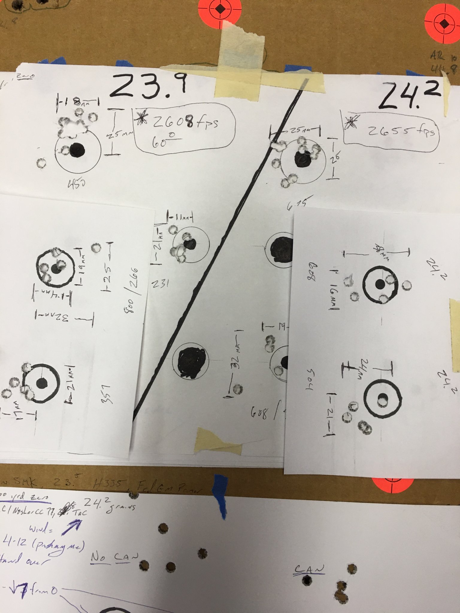

What would you rather have? A slower more accurate load or 50 fps?
18" barrel / 60 degrees / 1790 DA
77 Nosler 2600 fps vs 77 Nosler at 2,650
I have shot several 5 and 10 round groups with both loads. Both will produce 1/2 MOA groups. More typically both stack 3, 1 close and one flyer. With the flyer ,the groups are more like 0.7 for 2600 and 0.9 for 2650 - which load would you take?

If you're squeezing triggers with the intent to hit the target each time you do (especially at longer range, which is why you would be using an SPR with optics), then I'd want the more accurate round. Precision and accuracy trump speed.

Awesome thank you. I kept looking at the wind drift difference and the groups and thought - I want the accuracy, so thank you all for the confirmation. 2600 isn't real hot, but it shoots well.

These are 23.9 and 24.2 respectively. I am guessing I need to get to 24.6 to get over 2700 fps. By the same token, not sure I want them when it is 100 degrees out.
A cheep ProChrono that is like 20 yrs old. I did break out the multi meter and check the battery before I went. It was overcast, but I am not completely sure what that matters. I guess next time I will take a couple rounds of Eley Target that is marked at 1090 fps and see what reads.
A cheep ProChrono that is like 20 yrs old. I did break out the multi meter and check the battery before I went. It was overcast, but I am not completely sure what that matters. I guess next time I will take a couple rounds of Eley Target that is marked at 1090 fps and see what reads.View attachment 7353008
Accuracy over velocity, all day, every day and especially on match day.
Tested at 3-400 to verify slower load shoots better, gives less vertical?

ES / SD is about the same.
LC cases of mixed vintage, I am not weighing / sorting; just anneal, squish, trim, prime, (trickle) powder, and seat.
I need to get them out like you say at 300 - 500 and see how they fly.
