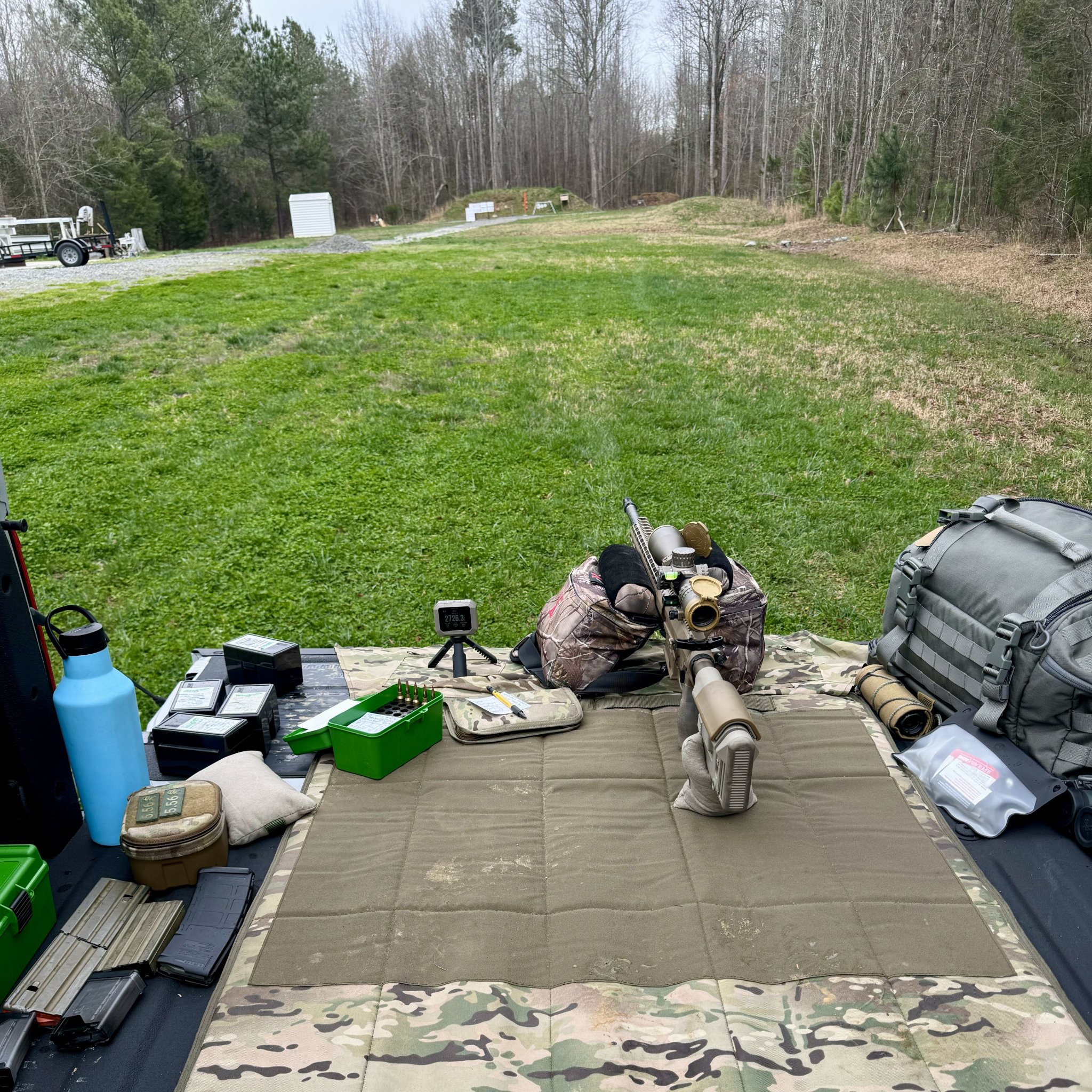

Shooting range on Sunday!! (Yes, out of the bed of my truck)
