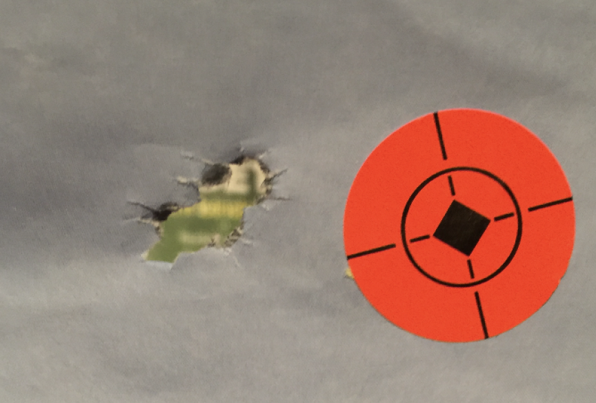

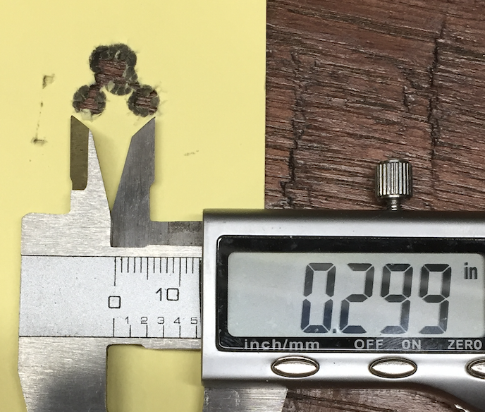

    I bought all the 77SMK's I could find when they went half off at my local store. Both of these five shot groups are with canelure. Neither were crimped.
    Be careful "Judging Accuracy" by just looking at groups fired at 100 yards!
    You can have a group that looks good at 100 yards, but looks like junk at 500 yards (or beyond).
    A small issue with bullet consistency or BC variation (both issue with cannelures) is not going to show significantly at 100 yards. However those things can start to exponentially impact the accuracy the farther that the bullet travels.
    Anyone that shoots 1,000 yard F-Class or Benchrest will confirm that you just can't take what you are seeing at 100 yards and be guaranteed that it will look that good at much longer ranges.
    Unless it is an issue with the bullets being crimped, or interacting with the neck, inconsistently I would not expect to see a major difference in accuracy between the two at 100 yards.
