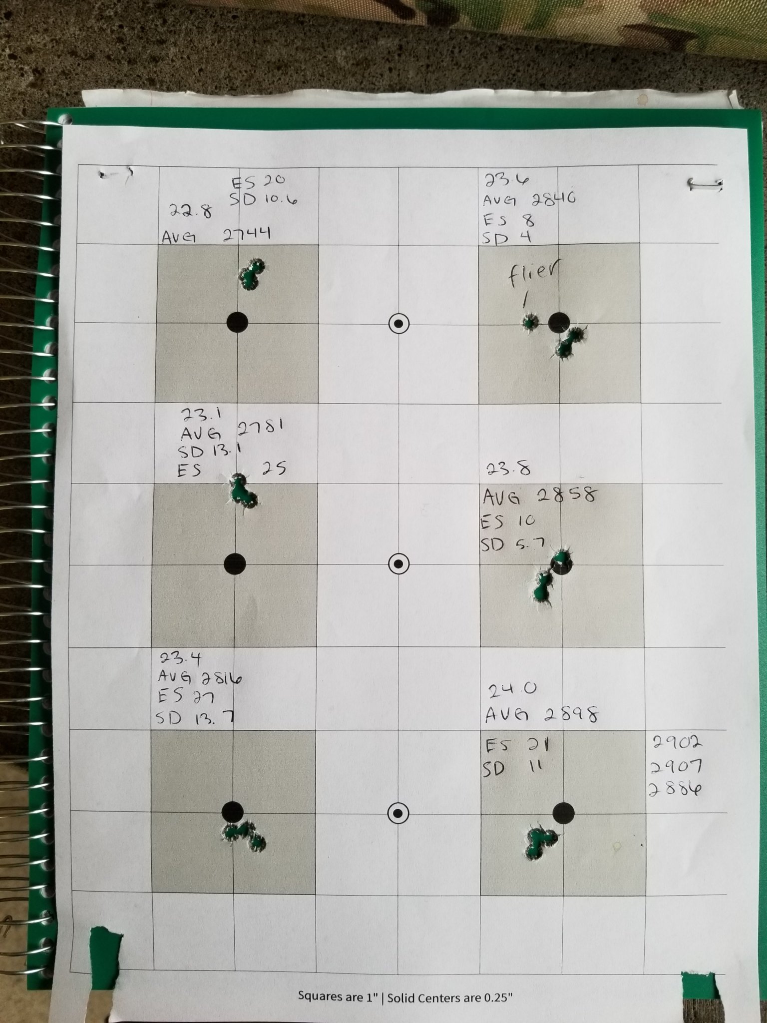

Hey guys looking for some data on the 77tmk.
Looking to get them to around 2900.
I have a 1:7.7 24" bartelin barrel on a defiance action.
I have 8208, varget and cfe223 to play with.
Need a good load that I can use for the SH cup in june.
Anyone have luck with those powders in a similar set up thanks.

So I ran the ladder test with both CFE223 and IMR8208 both showed promise accuracy wise but the cfe was wayyyy to slow
These groups were with 8208. At 24grs I think I'm starting to crunch powder but I didnt have any primer flattening nor did i have sticky bolt lift. Might of found a winner
