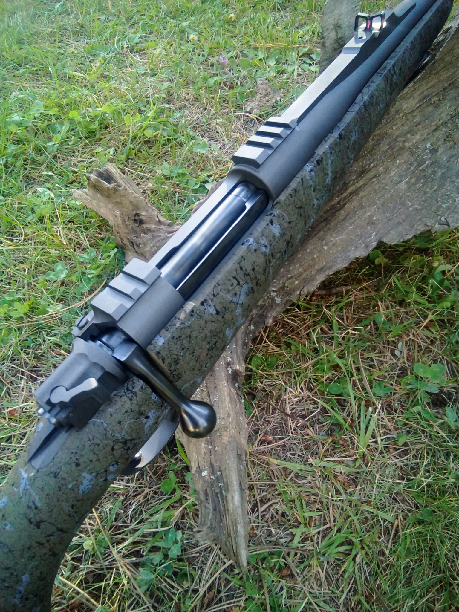

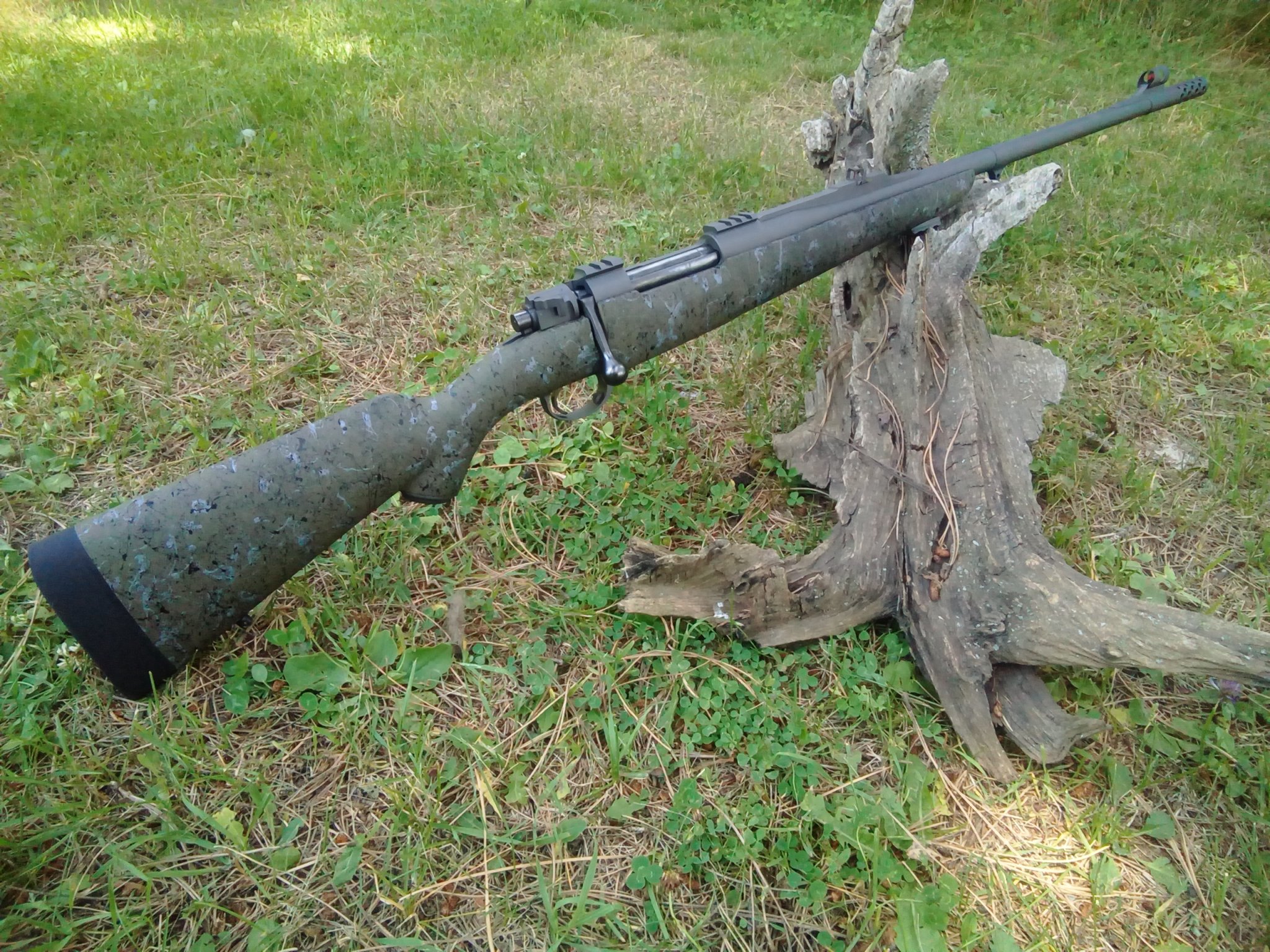

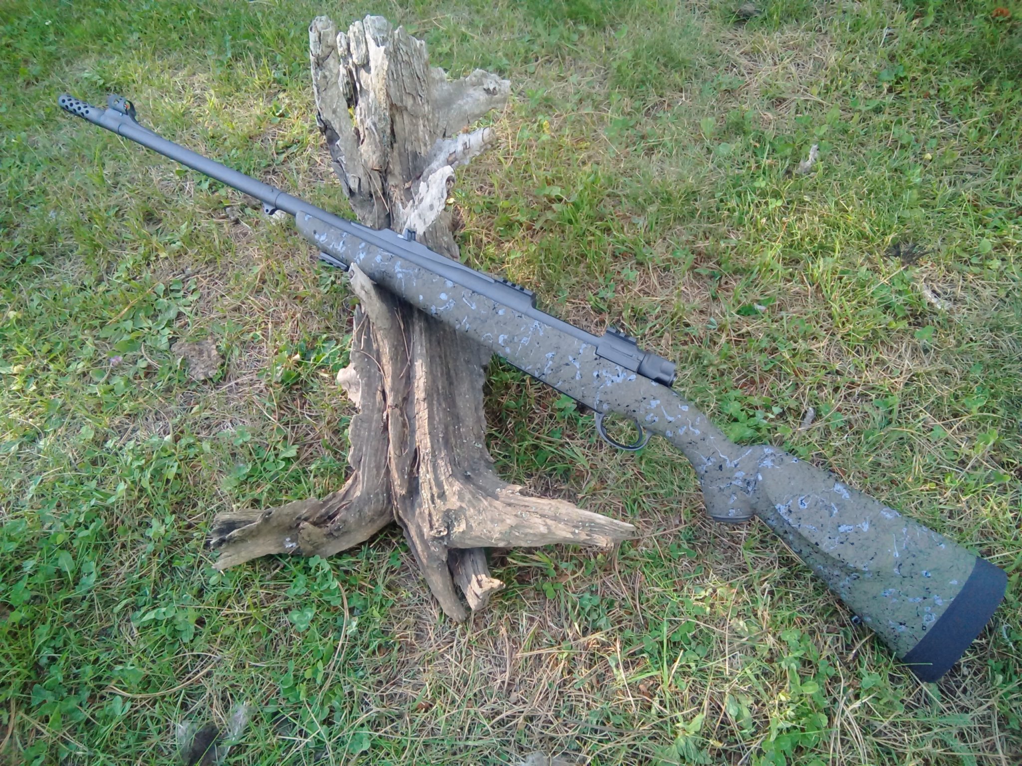

Ti receiver, Ti bottom metal, drop design 4+1 capacity. Signature British Express style stock in Carbon. K&P cut rifled barrel 22" in length. Fitted quarter rib. NECG fiber optic sights, front banded ramp a barrel banded sling swivel. Tungsten cera-kote.
Integral picatinny bases, appeal to a wide array of scope rings.
Internally, it's full on M98 in every way down to the smallest detail, like all the other actions I've built in CM, Stainless and Ti.
Thought you guys might like to see it.

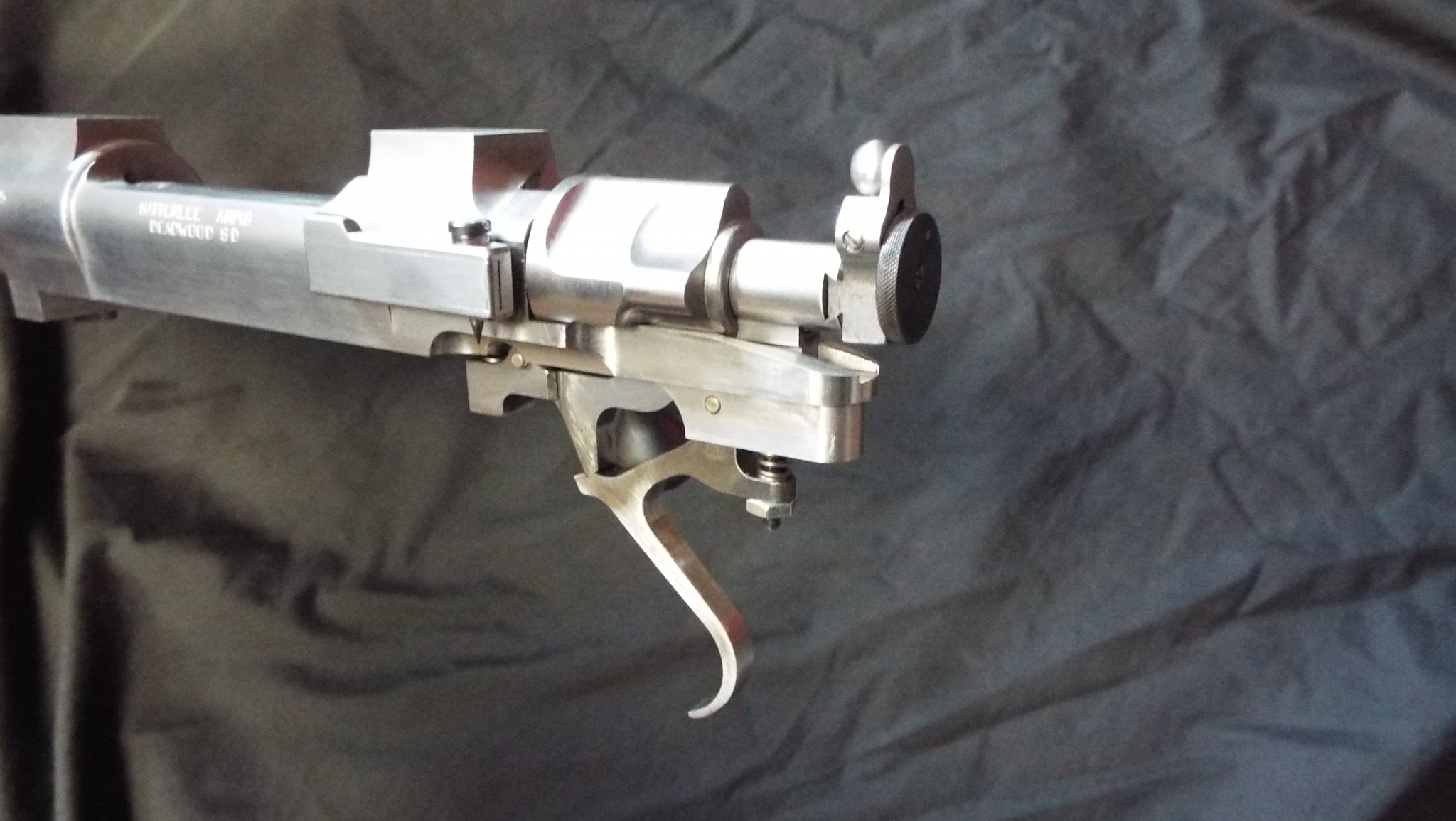

This photo shows the trigger design on the Satterlee M98 actions that i make. This concept takes the M-70 concept and applies it to the Mauser. Satterlee actions are Mauser 98 clones. Why? I always thought the M-70 trigger was a very good trigger for a hunting rifle, simple rugged two piece architecture.

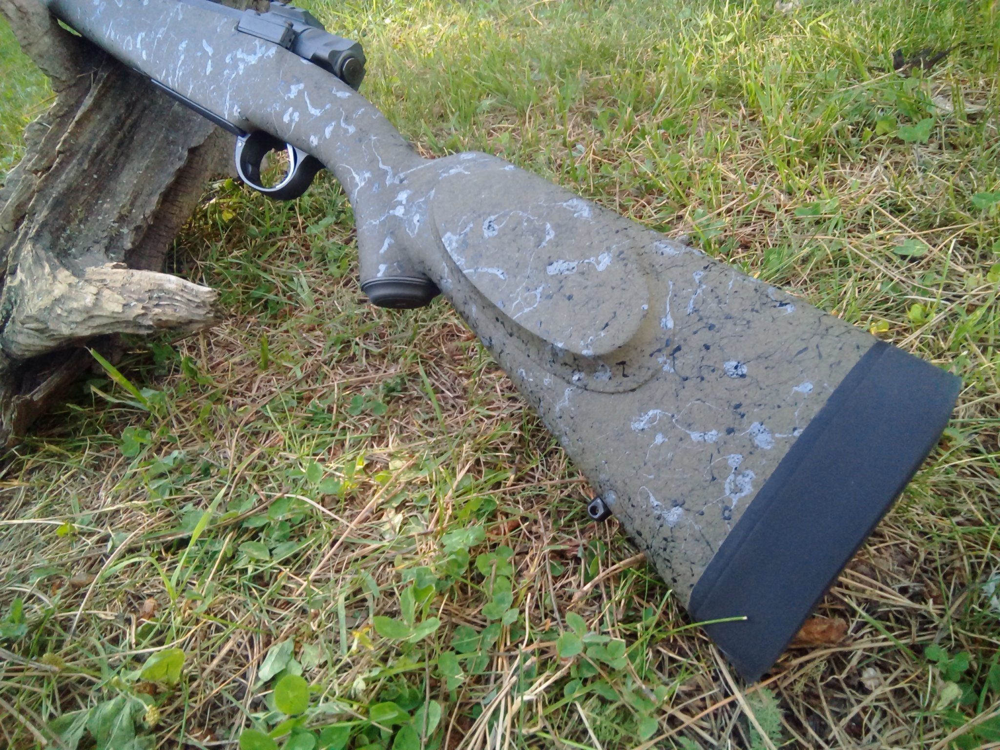

The stocks are produced locally here in South Dakota (Rapid City) for me.
I made the pattern and inlet mandrel for the production of the stock. I engineered it specifically for my Satterlee Arms M98 action in the drop box 4+1 configuration.
The person who actually does the layup works independently and produces for me with my tooling in his shop.
Some on the design:
The design is a British design known as express style, open grip, pancake style cheek piece 1-1/8 drop at the heel relative to bore line, no cast off or on, straight in that regard. This design handles very well for rapid target acquisition in close quarters thick brush etc.
