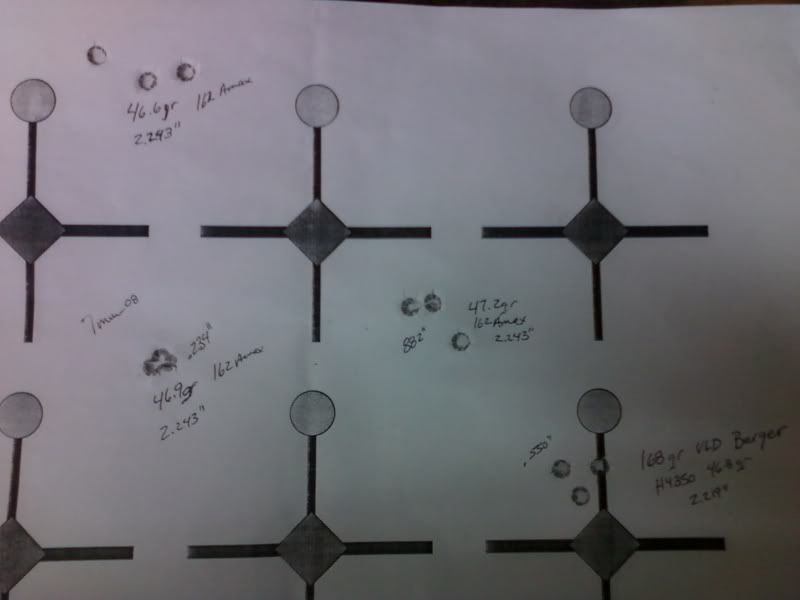

Here's the first shots with new criterion barrel. Break it in...
Loads using 162 amax, win brass, cci br2 primers, .020" off the lands, with H4350 46.6- 47.2 grs. at 100 meters.
Just for kicks loaded some 168 vld's.
