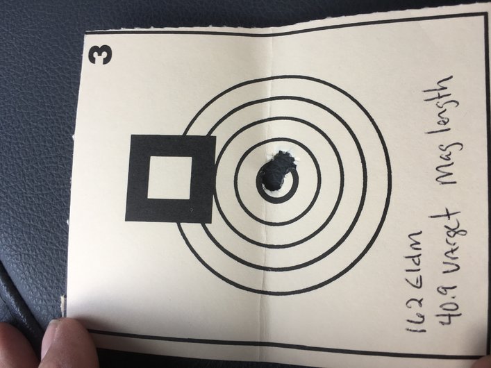

Running 40.9 gr varget with the 162 eldm in mine and best powder I have tried yet.
