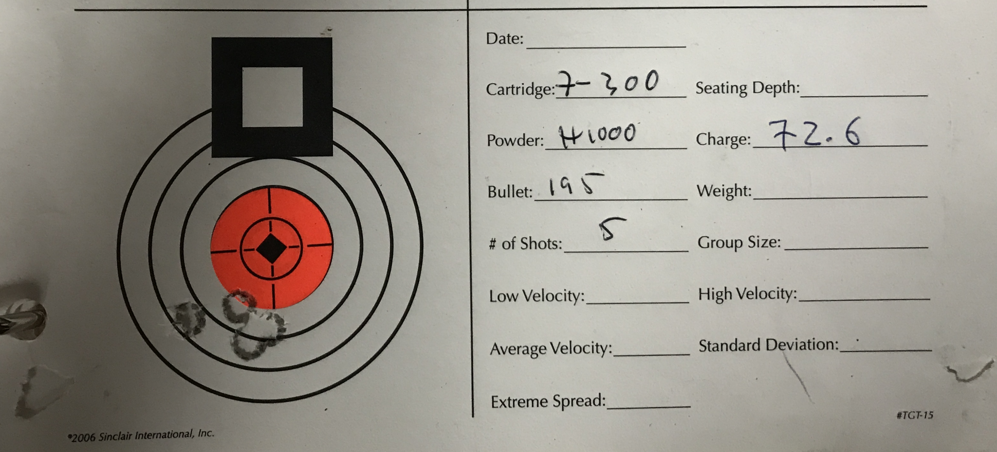

Charge:
I read as much as I could find before I started. There was not a lot out there for 7-300/H1000. I took some 7MM Practical info from Nathan Foster at Ballistic Studies. (Note, he uses STANDARD primers, not magnum.) I'm not sure why but he is a smart guy and I'm sure he has his reasons. I want the load to work in cold weather so I started lower using magnum primers.
I did ladder tests, starting at 71.6 and working up to 73.8.
There is a nice node at 73.8 (2967 FPS) but I wouldn't go there again. The first firing was perfect, no pressure signs. When I was testing velocity on the second firing I got sticky bolt lift and loose pockets. It's possible that I had a carbon ring but I am done experimenting. Barrel life is short enough with this round and making the brass is a pain in the ass. 72.6 seems accurate enough. The fliers were me, I could feel it as i yanked the last 2.
I should be getting low to mid 2900s. That should get me out to a mile fine. I will post exact speeds when I am finished with my temperature/velocity tests. I will post brass and barrel life when I have more data.
