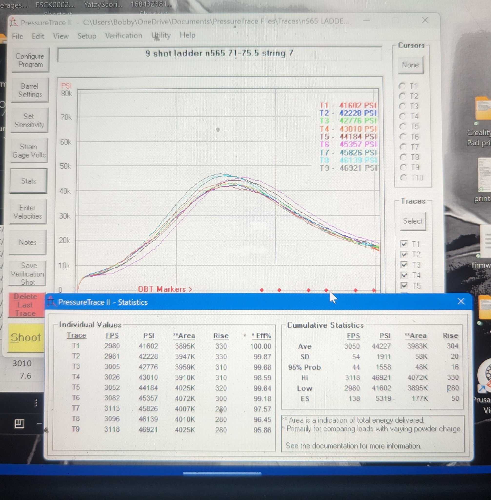

    I have roughly 400 rounds down range this month. I've got chrono and strain gauge chamber pressure measurements for H1000, WinStaBall HD, N570, N565, some with both large primers, and magnum primers. Running ADG, Berger 190 LRHT, high altitude, 30" Krieger. Best group so far (4) .341 several loads with SD ranging from 2.4-4.8 found . 020-.005 and . 080 jump were working for me. Lots of loads in the 3150-3200 fps range. Id really like to get together with whoever else is doing this cartridge. I couldn't find much info at all, so I've been doing a lot of testing and recording to help anyone else who is. I just started putting some info on two other 7-300 posts, (some of it needs editing due to a scale calibration issue) but It would be great to have all the info in one spot. I don't have a long history of experience and I'm definitely not a professional shooter by any means ,but I would be happy to provide the information I have correct or incorrect. And if it's incorrect maybe someone here would be able to help me sort it out so it's more useful to everyone.
    I am still waiting on my barrel from PVA, so I can't even help my own thread, but as soon as it comes in, I'll be testing Reloder 23, Reloder 26, H1000, maybe H4831SC

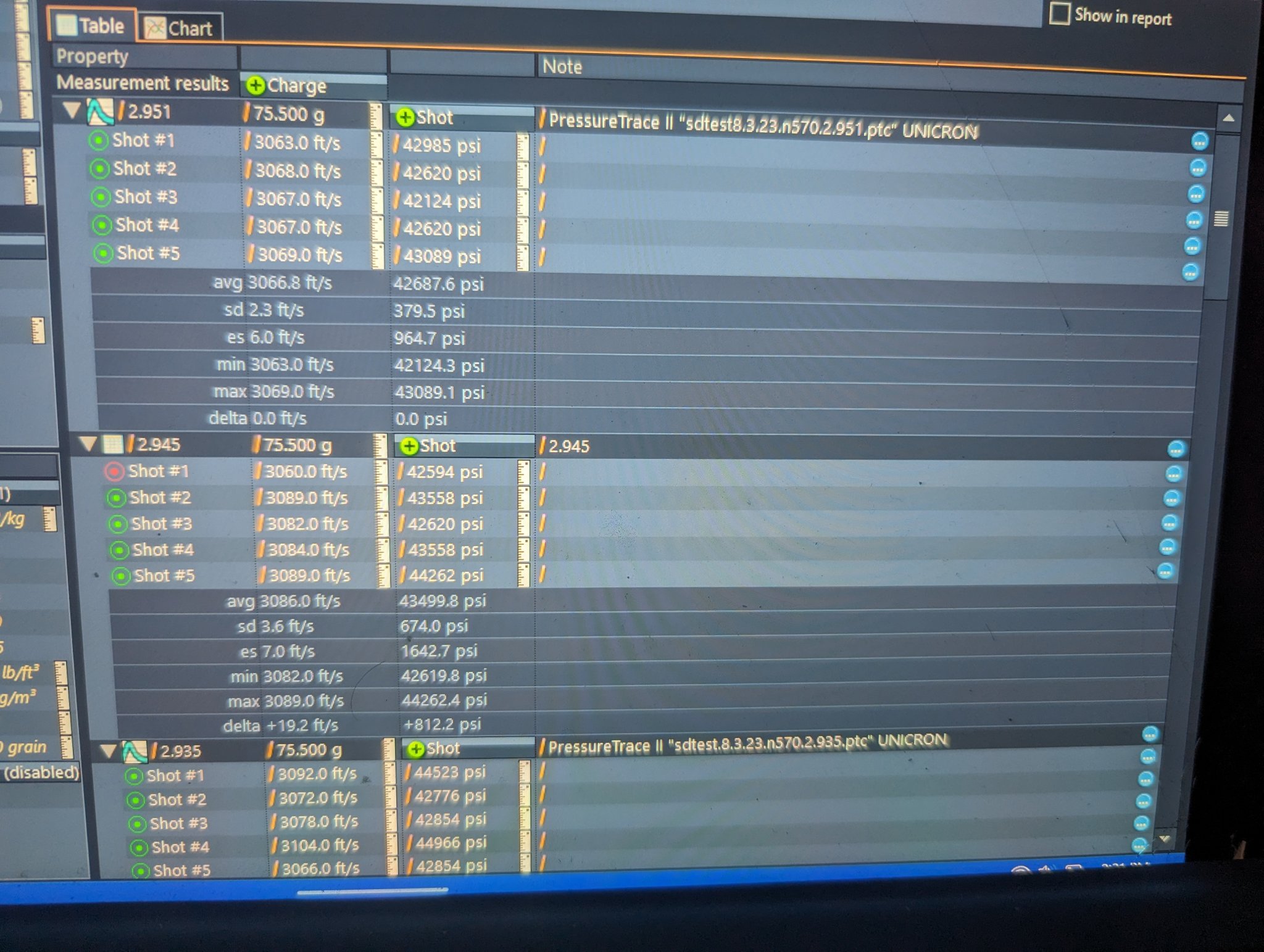

    Ok got a few days of testing done with the range all to myself with great weather. I did a lot of the strain gauge data logging straight into GR Trace, and I wish I would have just had the data go straight into the Pressure trace software as I just spent the last day and a half figuring out how to calibrate the chamber pressure readings. That's why it took some extra time to get the info up. So I'll just start with the parameters.
    6000' Altitude (Mountains of Colorado)
    Temp 59f
    Baro 29.53
    No wind
    102 yards
    30" Krieger- heavy marksman 1.250-.90 / 8.750 twist rate / roughly 900 rounds through it
    Kelbly Atlas Tactical
    XLR Element C-6 buttstock (fully weighted)
    Triggertech Diamond pro
    Hawkins Precision one piece mount
    Tract Toric 4.5-30x56
    total gun weight in current form 21 lbs/ shooting prone position
    Using Magnetospeed V3 for chrono
    Pressure Trace2 strain gauge for chamber pressure measurements
    ADG brass I think 8-9 firings to date
    Trimmed 2.565
    Case volume 93.5
    Neck turned to .014 thickness
    Annealed after every firing
    Never case cleaned or tumbled, But always wiped down and primer pockets cleaned
    Neck tension 2.5 thou
    COAL: 3.685
    CBTO: 2.940
    Primer seating depth: .002
    Bullets: Berger 184gr F-Open Hybrid Target (All other tests have been 190gr LRHT, but I couldn't get any more at the time)
    Primers: Remington Magnum Large Rife/ sorted by cup thickness into .001 increments. 6 thousandth's variance in the box of 1k. F-ING 6! All cups used measured .132 (Again, the only magnum primers I've been able to get. With some of the other powders I have done load testing for I have also tried CCI Large Rifle and CCI #34 NATO).
    Powder: For this test Retumbo. I have also tested H1000, Win Sta-Ball HD, N570, N565. I did not run up to max pressure on this test, but I did run 75, 75.5, 76, 76.5, 77, 77.5, and 78. No signs of pressure at 78. Each group was 5 shots except the final group of 80gr because I'm a case short.
    I think it's important to say also that in a few of the groups I had a strange load where one single bullet would be significantly higher or lower than all of the others. as an example the very first shot of group 1 was 20 fps faster than all of the rest, so it shows an SD of 10.5 and ES of 25 but removing that one odd round makes it an SD of 2.2 and an ES of 5. Same with the last shot in group 2 which shows an SD of 18.8 and an ES of 46. removing that final shot would make the SD 5.8, and the ES 11. The final group of 78 grains shows a ridiculous SD of 35.6 and an ES of 76, but removing the bad round shows an SD of 9.3, and an ES of 17. I'm assuming it has something to do with my reloading, but I haven't pinpointed the problem. I'm not going to make any excuses or apologies, I just thought that with that large of a swing that it was worth letting whoever reads this, know not to misinterpret what might look like a bad load charge weight when despite my human error, its actually great. some charge weights were just totally awful regardless numbers wise, and didn't seem to me that they were worth investigating any further. Those two groups were 76.5 and 77gr.
    75gr
    max 3035 (3055)
    min 3030
    avg 3032
    SD 2.2 (corrected)
    ES 5 (corrected)
    75.5gr
    max 3068 (3103)
    min 3057
    avg 3032
    SD 5.8 (corrected)
    ES 11 (corrected)
    76gr
    max 3097
    min 3075
    avg 3085
    SD 10.4
    ES 22
    76.5gr
    max 3163
    min 3095
    avg 3128
    SD 32
    ES 68
    77gr
    max 3163
    min 3030
    avg 3032
    SD 2.2 (corrected)
    ES 5 (corrected)
    77.5gr
    max 3035 (3055)
    min 3030
    avg 3032
    SD 2.2 (corrected)
    ES 5 (corrected)
    78gr
    max 3159
    min 3142
    avg 3148
    SD 9.3 (corrected)
    ES 17 (corrected)
    I'll add more later and if anyone needs detailed info I'm more than happy to share. Hope this helps.
