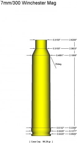

    Im building a 7mm-300 win mag on a rem 700. I want to shoot 180gr Bergers vld with Norma brass. Is anyone using this combination? What is your fired case neck diameter, your loaded round neck diameter and your re sized neck diameter? Im trying to figure out what my reamer neck clearance should be? Does anyone have a reamer setup for the 180? Any info regarding the round would be greatly appreciated!
    I cant help you with the norma brass but I run a neck bushing .314 with 180s and then I run a expander manderal through just to ensure the necks are perfect. I can message my Smith about the reamer specs
    Reactions: HillBilly_Sniper
    This is what he just sent me for specs not sure it will help on freebore.
