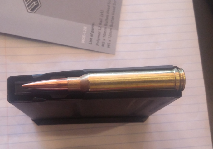

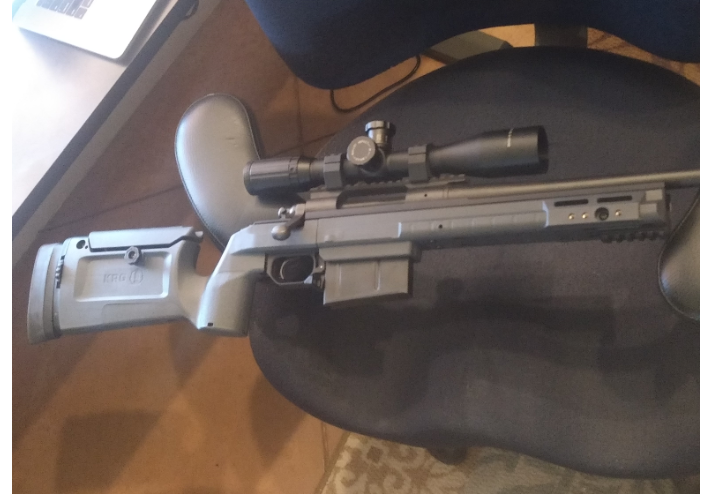

Just last night, placed an an older, mint Remington 700 7mm Mag into a new Bravo LA. Worked great! Added the lower cost adjustable butt pad and a minimalist spigot which will be here next week. The Accurate Mag CIP length mag has plenty of room for the Berger 180 at 20 thou off the lands.
Should have plenty of room for the 190's after I upgrade the barrel.
