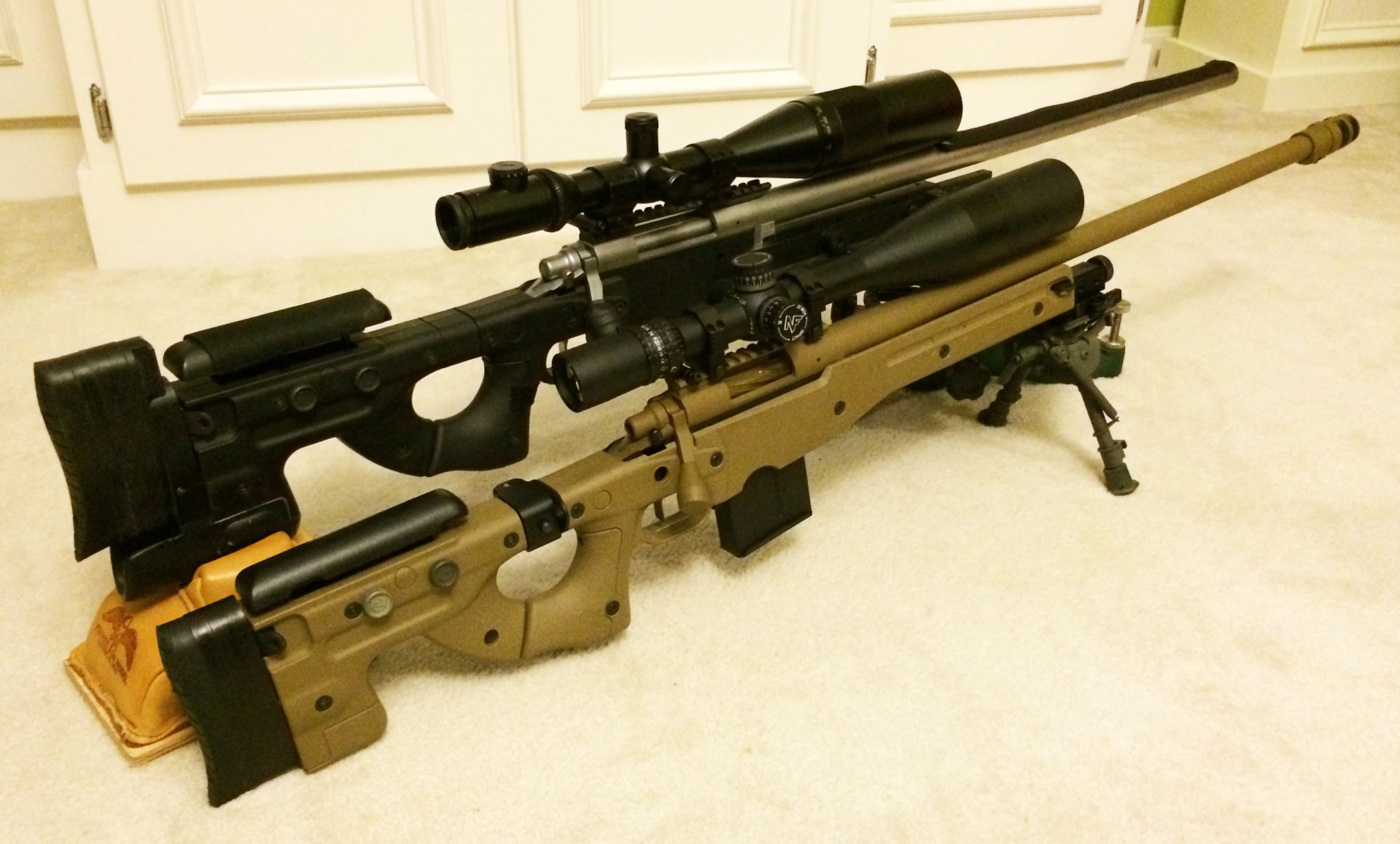

    The terrible twosome, my "Sevens".
    The top is a .284 and the bottom is a 7 SAUM.
    I started with the 7 SAUM, and learned the hard way that the great new heavy high BC bullets are VERY LOOONG! When you try to run them in a Short Action, that length screws you. They either end up too long to be run out of a mag, or they end up seated way too deep into the case. For the SAUM in a Mag Fed Short Action, you are better off running something below the 180s.

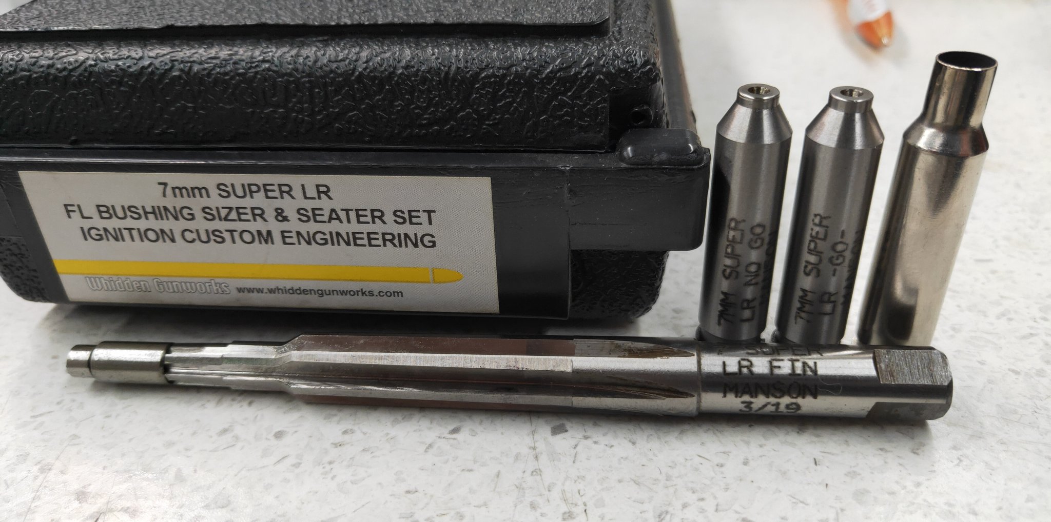

    OP asked about a 7mm that fits in a SR25 pattern mag. I load to 2.850 oal. 7 creed fits in a mag better than 7/08 for the same reason 6.5 creed fits better than 260. My 7mm even loaded @ a more tame velocity visibly smacks steel much harder that a 6.5 creed and runs with it for drop, beats it in the wind and has better barrel life. It makes 308 drops look like a BB gun. I will admit that the load I posted above is definitely warm, but far from dangerous. I have 2 reloads on my new brass and have yet to loose a primer pocket.
    As far as brass it is a simple pass through a die with the expander mandrel. Dounuts have not been a issue but I always use the expander, keeps the dounuts pushed out. I have been using Lapua 6.5 Creed SRP brass. I used to form it from 308 palma, which was quite a bit of work. It had to be neck turned, and formed in several steps. But made very nice brass. The new 6.5 stuff is easy.
    Dies are just a 6.5 Creed bushing die with the correct bushing for 7mm.

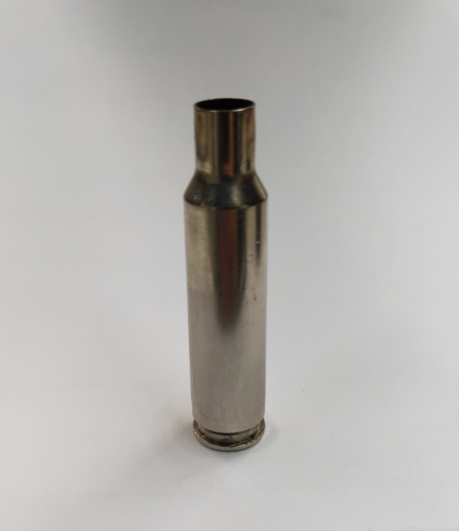

    This comes from shooting a .284, which is necked up Lapua 6.5-284 brass.
    I did not have a Donut problem, until I got into multiple firings on the cases. I also did not realize that I had a Donut problem until my rounds starting shooting inconsistently and it took a lot of work to figure out what was causing it.
    Long Story Short, I started using Pin Gages (or Gauge) to check my brass (based on recommendations from other shooters), and then the Donuts became very obvious.
    As you can see from the video, the Pin Gage will slide 95% of the way into the case neck with no resistance, and then it comes to a hard stop where the Donut is at the Neck/Shoulder junction.
    I also use an Expander as my last sizing step, but it will NOT push the Donuts completely out.
    Apparently as the brass flows/moves forward with firings, it creates the Donut at the Neck/Shoulder junction. This is apparently because the thicker brass that was pulled out with neck expansion acts as stop. Your brass does not get longer, it just grows Donuts!
    Options to deal with this:
    - Turn the necks on the outside at the start of the process
    - Ream the inside of the neck after a couple of firings
    Sorry for the sidetrack, but this issue drove me crazy until I was able to figure out what was really going on. I was having erratic behavior (velocity spikes/swings, groups opening up), so I thought that I had a Carbon Ring, had a bad batch of powder, and the list went on, until someone helped me figure it out.

    7mm Super LR. 7-08mm parent case, run thru a die, shoot. 56.3gr H2O capacity (Winchester). Only just built it, will be shooting later today to get some basic data.
    This brass is once fired (as a super LR, was pulled from a live factory round, then reloaded).
    More details! Running in a short action? How different is it to the 7mm SAW?
    Yes short action. I'll have full range report in a week. Doing a half day PRS with it. It should be basically identical to 7-saw.
    I have good experience with 6-slr and 6.5-slr. I'm a huge 7mm guy, so this was logical for me. The body is Marginally different to the "normal" SLR design, for chambering / safety purposes. I can post the reamer print if needed, but Manson has it, as does widden.
    I'll post results as I get them.
