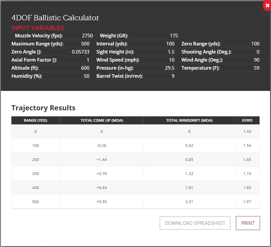

You should be fine. 1.5 or above is best, but the velocity I used is not breaking any records with 7 rem mag either. This is using Hornady's 4dof calculator on their website, gives stability for any bullet in that library.

Hornady recommends an 8” twist for the 180 ELD-M. Their recommendations appear to be more of a recommendation for guaranteed dynamic stability at sub-zero temps at 0 ft above sea level not necessarily a recommendation for optimal twist. I’m sure both of them are fine in a 9” twist in the right environment you’d just lose a little BC. For what it’s worth I’ve shot a a whitetail with the 180 and a Muley with the 175. Neither of them super far, sub 400 yds, from a 7 SAUM at 2750fps. Both animals fell in their tracks.
Also of note - Hornady’s 4dof calculates stability based off the exact physical model of the project. Most every other calculator assumes each bullet has the same mass distribution and density. So jacket thickness/taper and polymer tips can cause a slightly inaccurate Sg number with traditional Miller formula calculations.
