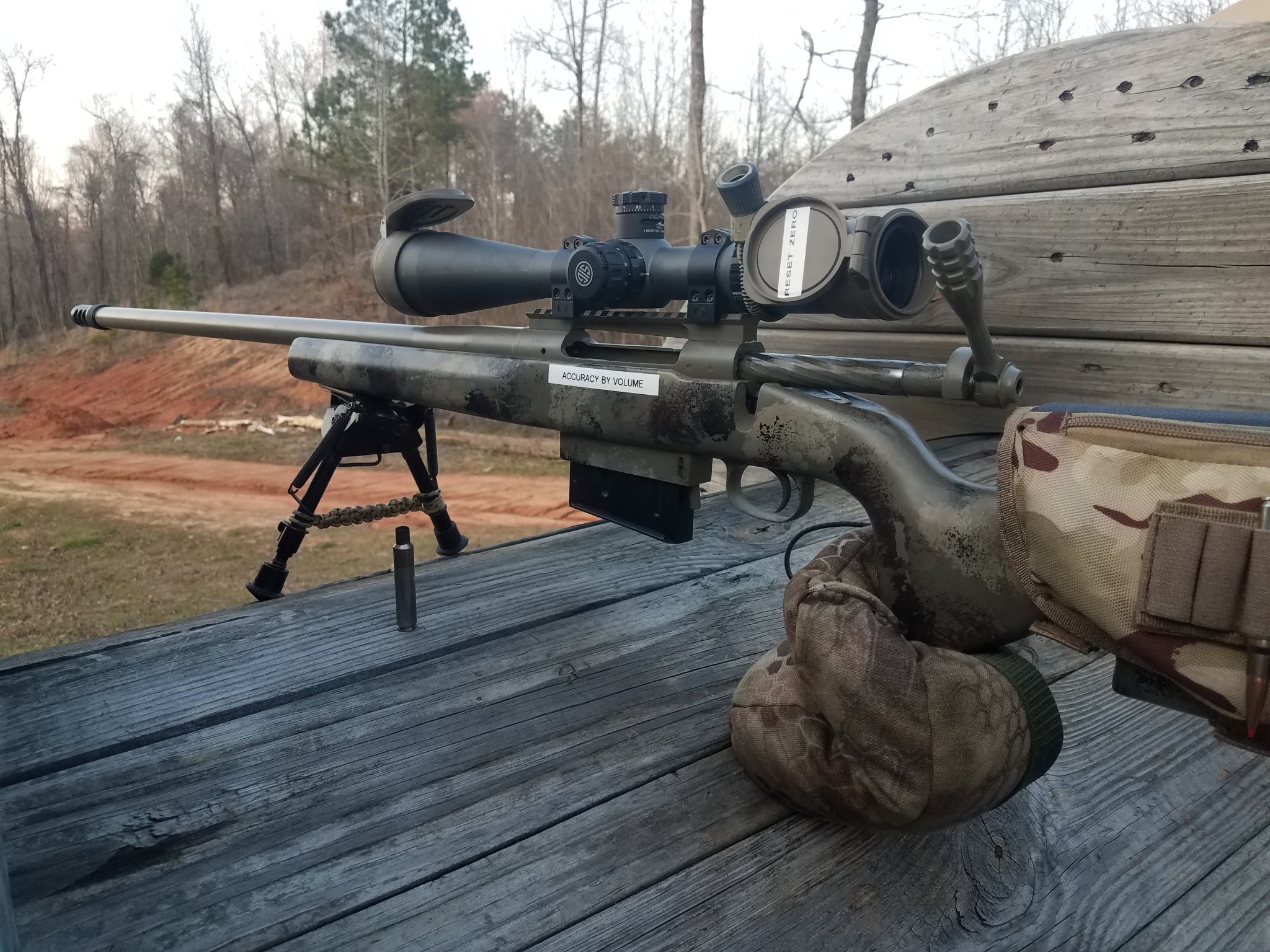

I ran my 280 ai at the last K&M match for shits and giggles. Slinging the 180 ELD-Ms at 2900 was fun and there wasn't much recoil for the caliber. It hit hard. But like others said the recoil matters for follow up. I didn't even try inside 600 to spot my shots. Another thing to consider is mags. 10 rounders are single stack and comically long.Good luck getting low. We did some shooting off rocks and it was a bitch to get stable. I ended up using my 6 rounders and feeding the last 4 shots one at a time.
Also in some positions that bolt throw can get annoying...
Regardless how big you are they tend to tire you out.
You know, I never once noticed the extra inch of throw. People always say that but as a mid pack shooter it never once limited me.
Also with that Hellfire, it wasn't bad at all. I shot 150 rounds that day and I never thought it was excessive on my body or mind. Just my .02
