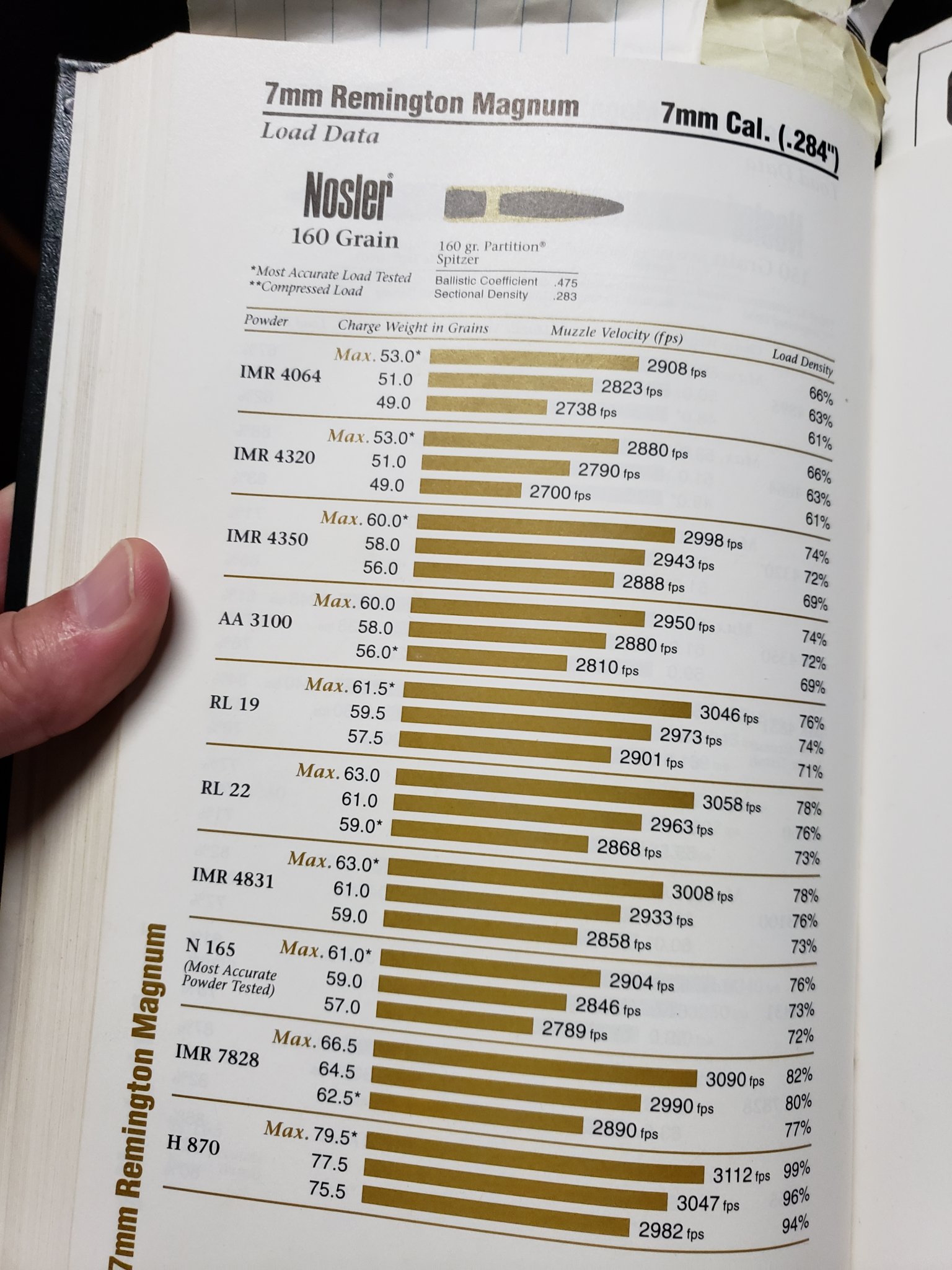

Second favorite cartridge ever. 4350 and H1000 has worked for every 7mmRM I've got and loaded for others. 140 BT Nosler 22" barrel with 4350 hits 2950 with no pressure signs was the last load I did. Good luck, hope this helps.

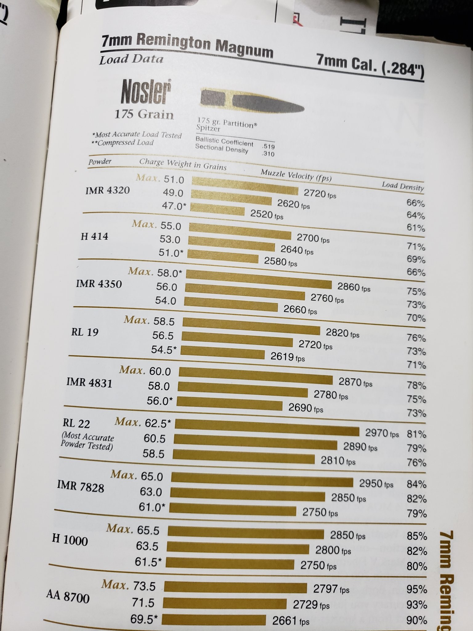

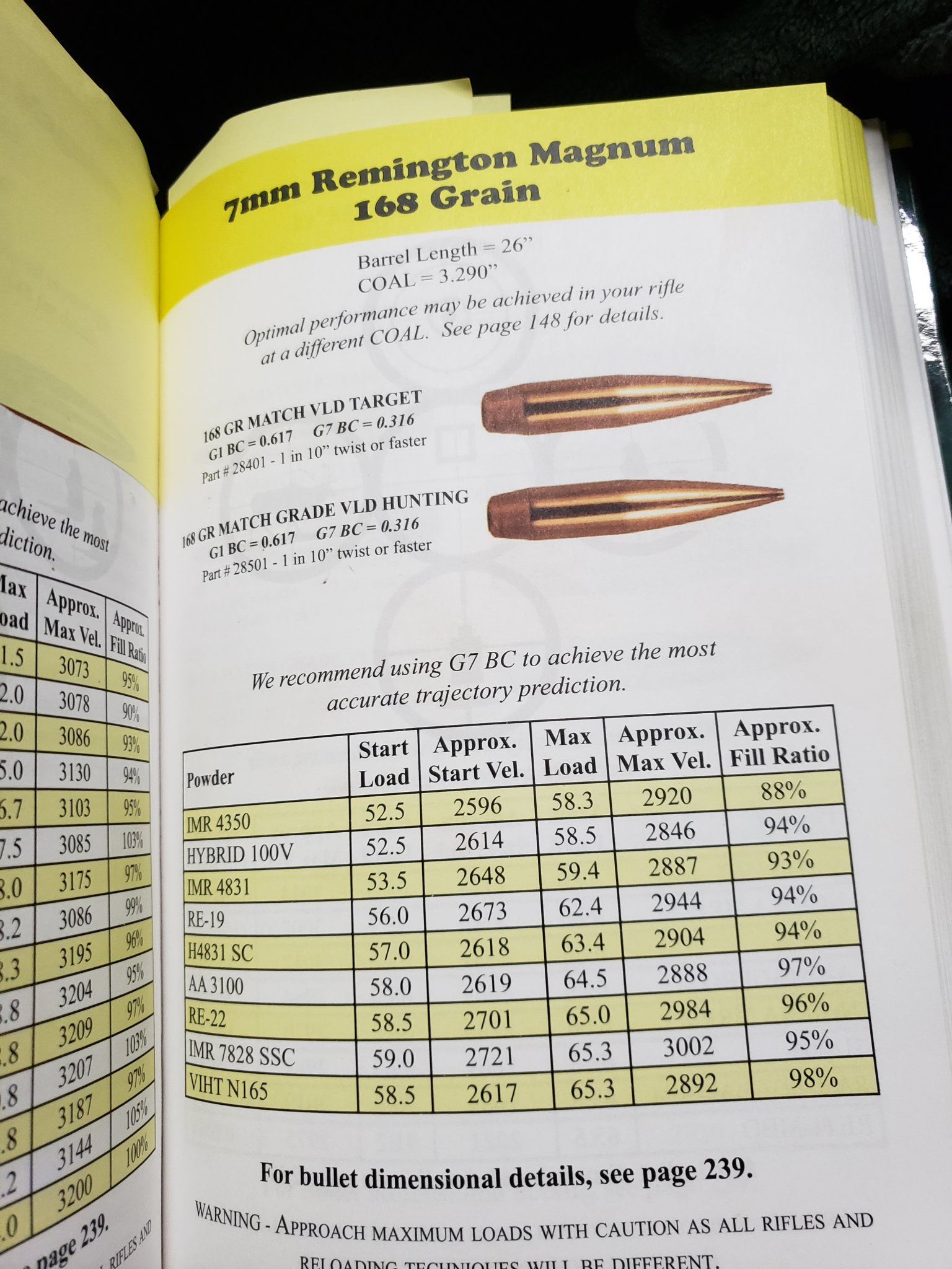

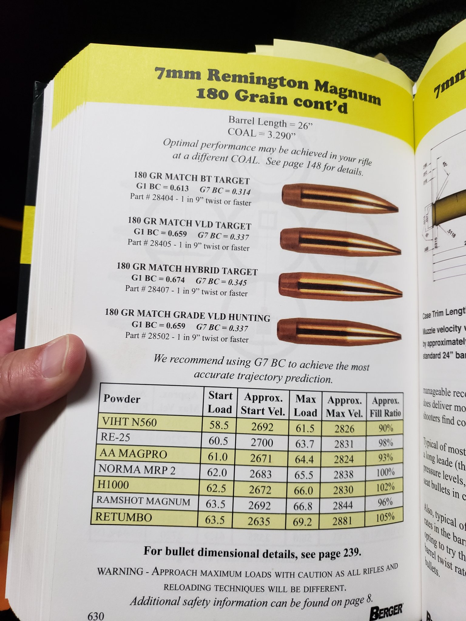

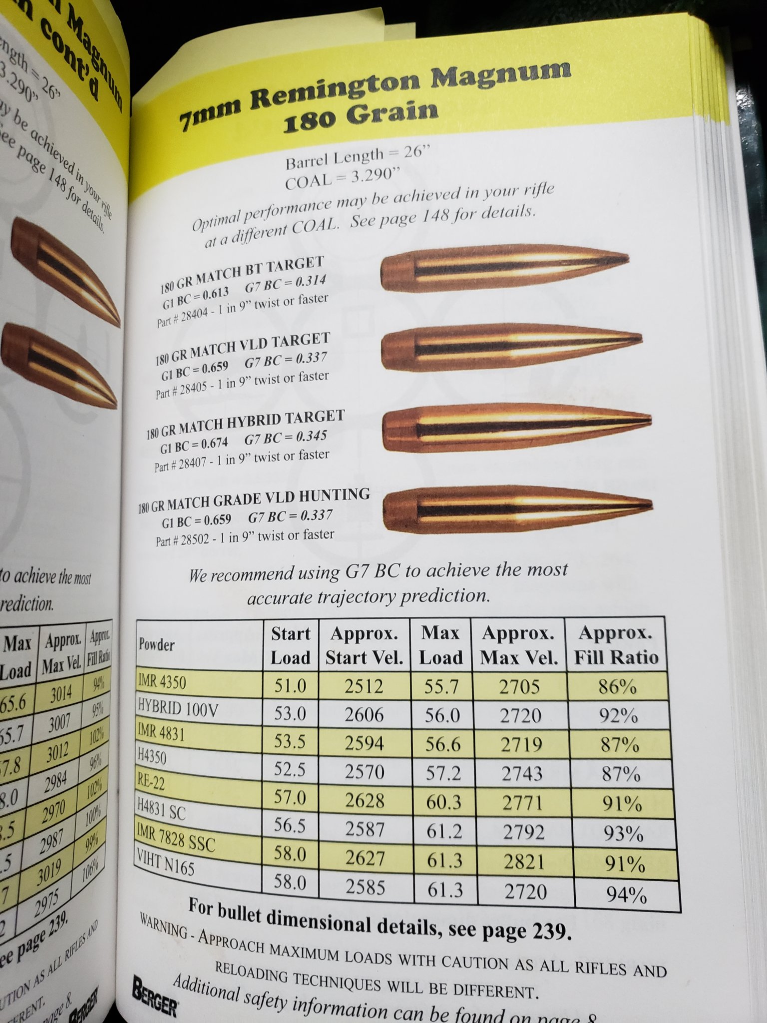

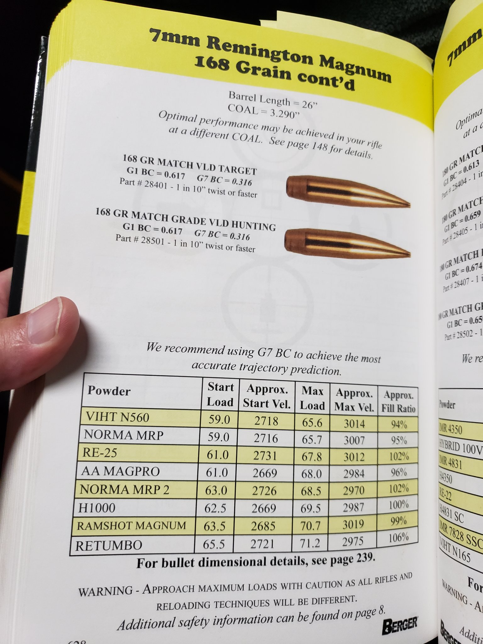

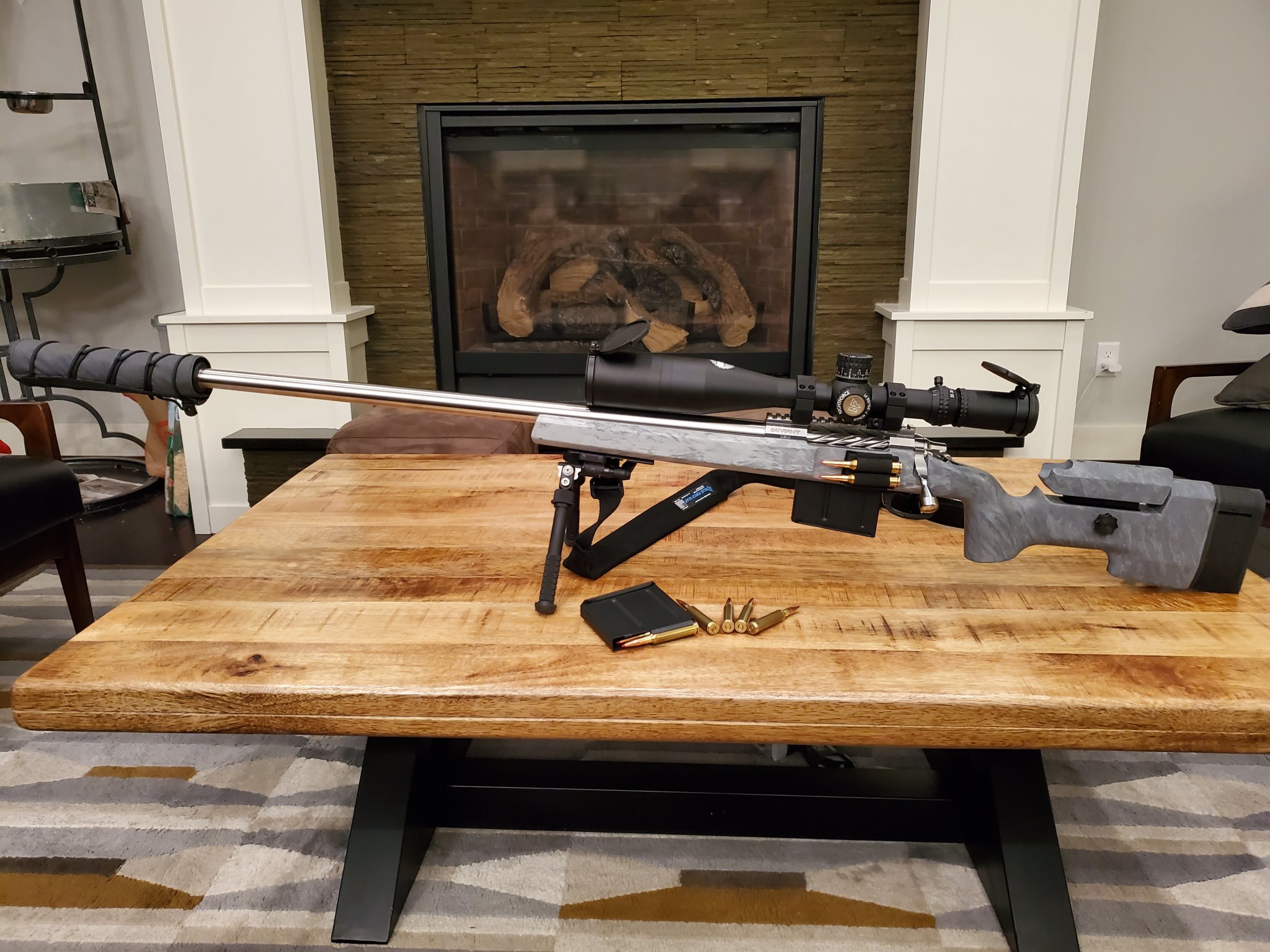

You might get away with a 1:9, but a 1:8 or faster would probably serve you better. Myself, and the 4 other guys I reload for (7MM RM's, 7MM STW's, 300 WM's) prefer Bergers. 168's outta all of them fly well. 180's outta the 7's with 8 or better twist. 210's outta the 300 WM's for heavier hammer. All loaded with RL22.
I've shot 62.5 gr out of Winchester Brass with GM215M Primers, with a CBTO "with my Hornady Comparator) of 2.675 and an avg COAL of 3.370 or so. The 168's are hovering around 2900. I've got a 1:8 twist 7MM I'm going to play with the 180's with shortly. I'll try both RL22 & H1000 for those. I've also got some Warner 151gr Flatlines I'm going to try outta the other 2 7MM's of mine.
I wouldn't discount the Bergers and RL22. It's a very stable load and accurate.
FOR REFERENCE

In my older browning abolt I use the 180 match vld hunting over 62g RL22 seated .010 off lands and get .5 moa or better accuracy. Of course I only get one in the chamber and one in the mag due to length.
