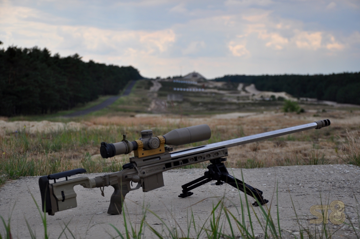

    I am recently building 7mm Practical rifle for 2000m shooting... This is only the beginning. I just wanted to know if it has some potential. Now I will make some changes...
    The very first shooting after I found some promising load - 500m was 0,3 MOA, 100m 0,2 MOA.
    It is Tikka in MDT chassis and Benchmark barrel 1:8 twist. 180 ELD-M 3050 fps... Sooo some potential is here ;)

    No hydroforming, just 300WM body an shoulders then neck with bushing and it is ready to shoot... With these results... And annealing, obviously...
    Why not other case? Because time and availability... I need to be ready for Ko2M in France. We will have except 2 miles even "Master of 2 Kilometers" - that is our goal - for 2 miles this setup is not enough. And it will be in April...
