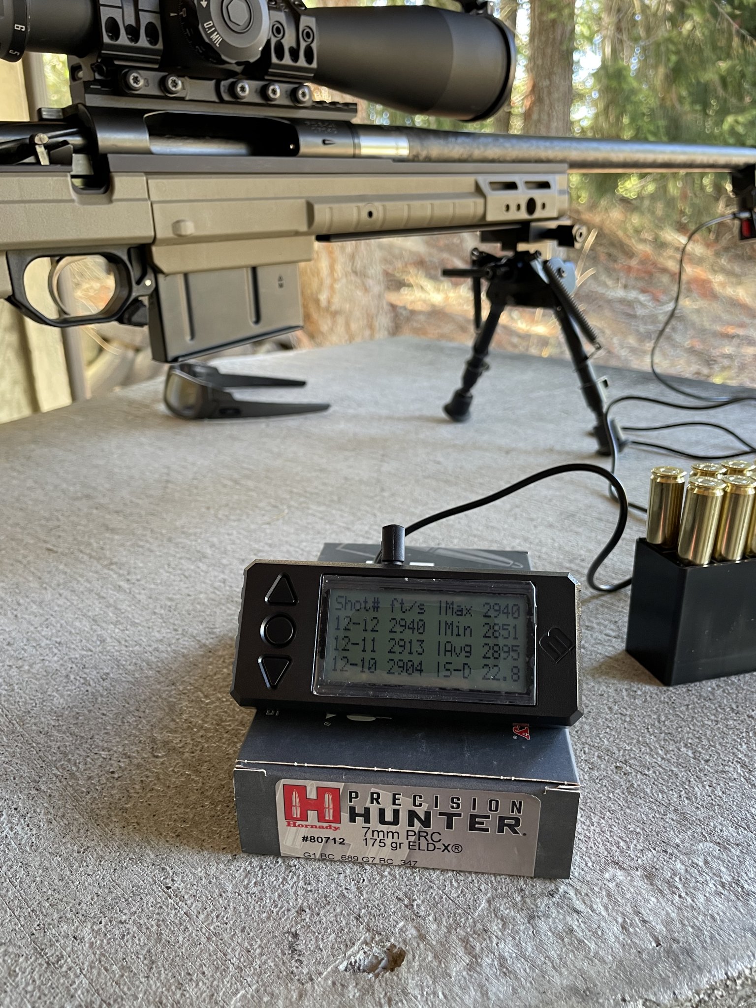

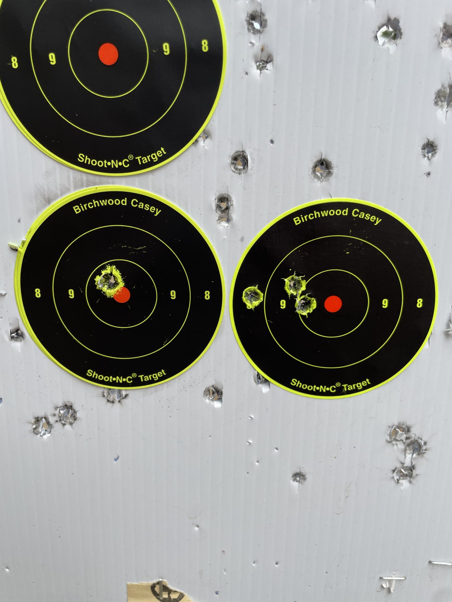

Finally got my headspace gauges and was able to get some rounds down range. First 12 rounds I did the shoot 3 and run a patch down the tube I used hoppes 9. I ran a brush down the tube about 15 passes after the 9 shot. Got a zero I was not super happy with so I went to the range the next day. Shot on the left was the first shot “cold bore cold shooter “ shot 12 rounds through the chronograph then shot some steel at 500 making impacts left edge and not much wind. Shot the group on the right and had to leave after. My question is when did you guys see the barrel speed up and level out what round count? Muzzle velocity is lower than advertised but the spread is not horrible. The group is about .8 I’m not the best shooter in the world but feel like it could be better. Round count is 44. How has Hornady precision hunter worked in your guys rifles?
Rifle specs
Zermatt origin la
Proof 26” sendero prefit
Tt special pro curve
Krg bravo la
Krg magazine “accurate mag”
Pva ultralight shockwave
Spurh
Zco 5-27 mpct 3
