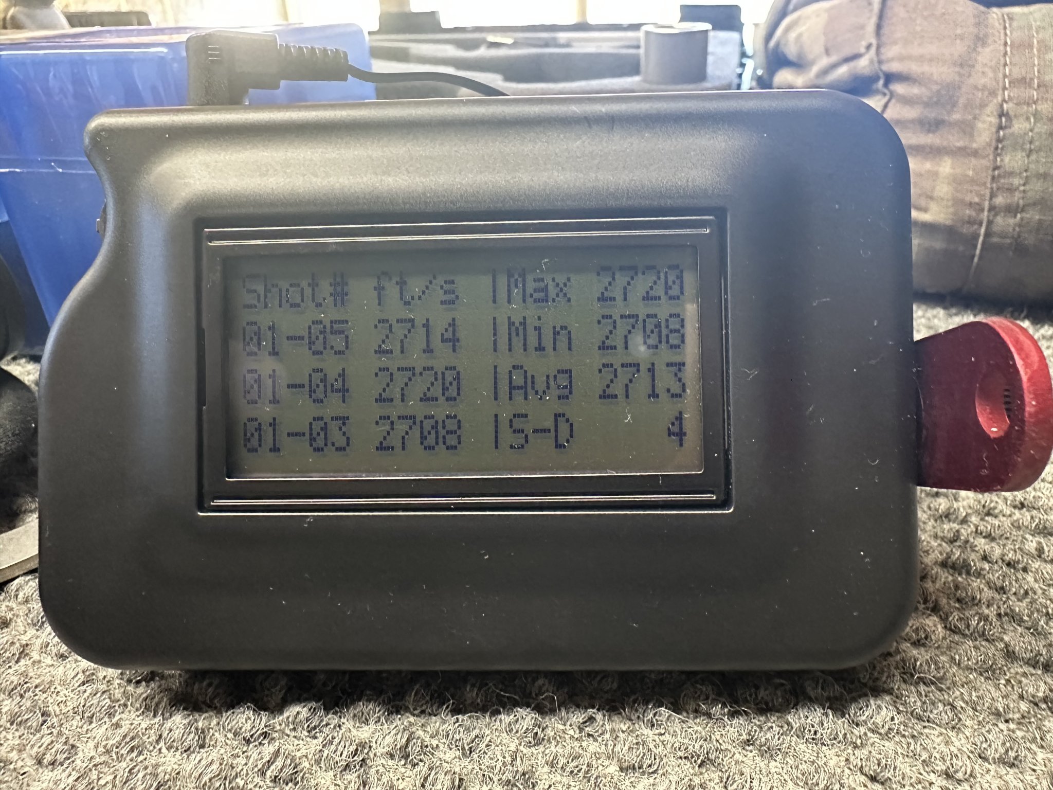

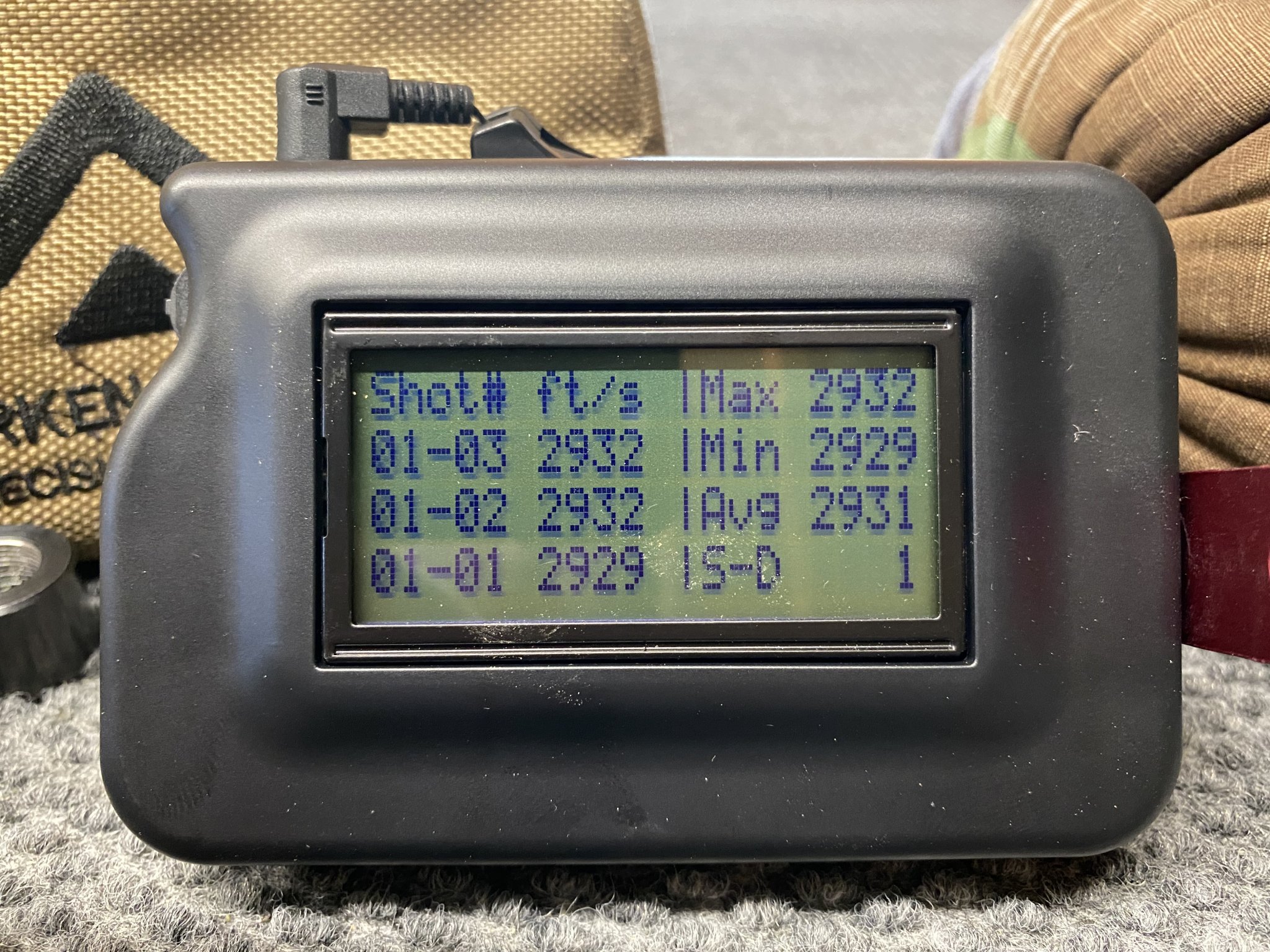

My 7mm RemMag Berger 168 VLD load has an ES of 3, and an SD of 1… These velocities were from a 22.5” barrel.

Here’s my 24” .280 Ackley Berger 175 Elite Hunter load. Should be just fine for long range.

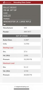

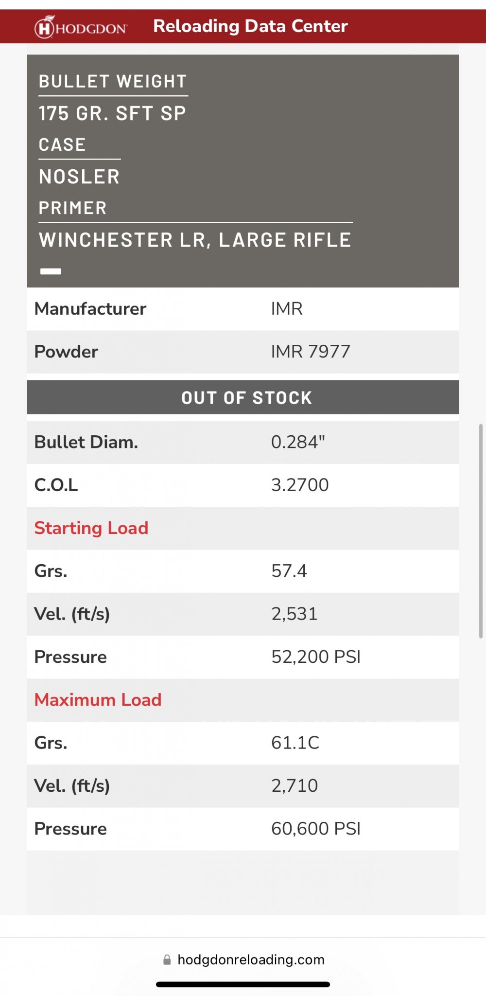

What the specs youre using? How many grains and how much powder? Is it a hot load or is this considered a more "mild load"
59.5gr of IMR 7977. Nosler .280 Ackley brass, CCI 200 primers. It’s near the top in pressure in my rifle (Christensen Arms Ridgeline), so approach with caution when you get around 58gr. But every chamber is different, but still, proceed with caution, and never try to match someone else’s load data, because like I said, every rifle and chamber is different. Prime example, I’m getting the same Velocity at 59.5gr, as the Hodgdon manual tests did at 61.1gr. So, just because your powder weight is not the same as the book, doesn’t mean the velocity numbers aren’t there. This is why working with a Chronograph is a must.
Here’s what Hodgdon’s online reloading center says.
