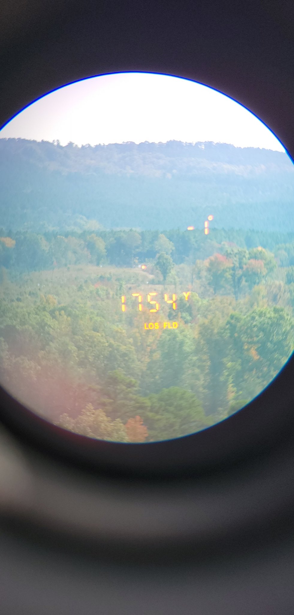

I had issues with the ELD-M being inconsistent in performance and exploding when ran hard. I switched to Berger 184's in a 7mmRM which is all that gun will ever seen again. My goal was to push it to a mile and the ELDM did not meet my needs.
Take that information for what its worth. I'm running 3030fps at sea level in a 26" barrel with a KGM can.

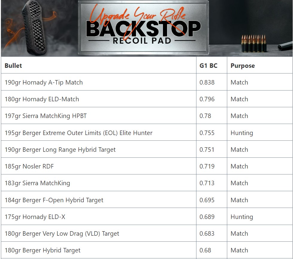

Yeah, I'm certainly not opposed to Retumbo sir. I have 5lbs of H1000 on hand and it's been a pretty good powder for me. Loaded short of pressure signs it fills the 7RM case nicely. My goal is 1000+ yard shooting. The 7RM can certainly fill the bill if the bullets don't come apart. I've had that problem obviously with the ELD-Ms, but haven't shot the 190gr A-Tip yet. The BC of that bullet is insane. BC means nothing if they come apart like ELD-Ms have though.
I started the thread to see if anyone out there had experience with A-Tips in a fast twist barreled 7RM. That 7RM with a 1:8 barrel spins them up pretty good. And fast.
And yes, I know. Bergers are better. :ROFLMAO:
